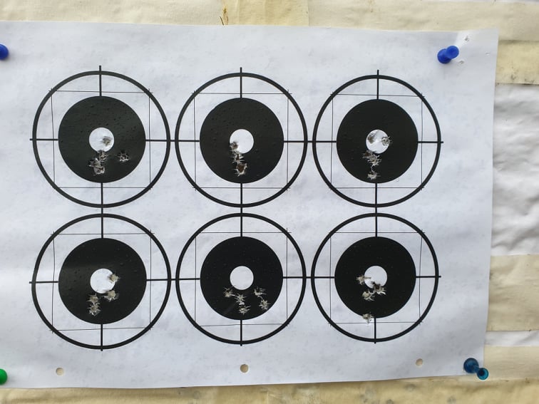

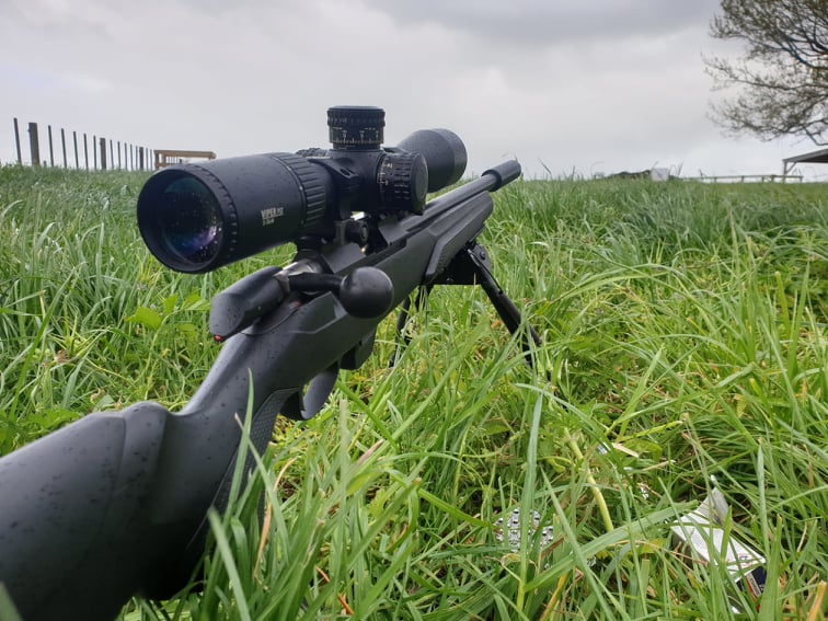

Despite horrendous weather (rain and a very very gusty tail wind) and lying in the very long grass in the paddock beside my house, I repeated the test with a pair of Nightforce Ultralite rings today. Shot six targets (so five removal/installations of the scope) at 35m with my 22lr.
Considering the poor shooting position, bad weather and the fact that I didn't even use a torque wrench when remounting between groups, I was pretty happy with the results.
Despite the poor groups the centre of the groups is pretty consistent, the extreme horizonal error I saw with the Burris rings was gone, and the vertical spread is pretty consistent across all six groups and is likely due to the extreme weather.
I'm going to go out on a limb and say that scope switch can be done reliably and will attempt to trial it once my new scope and mount arrives.
Perhaps after a long term test I'll report back with my thoughts on whether or not it's a practical solution.
