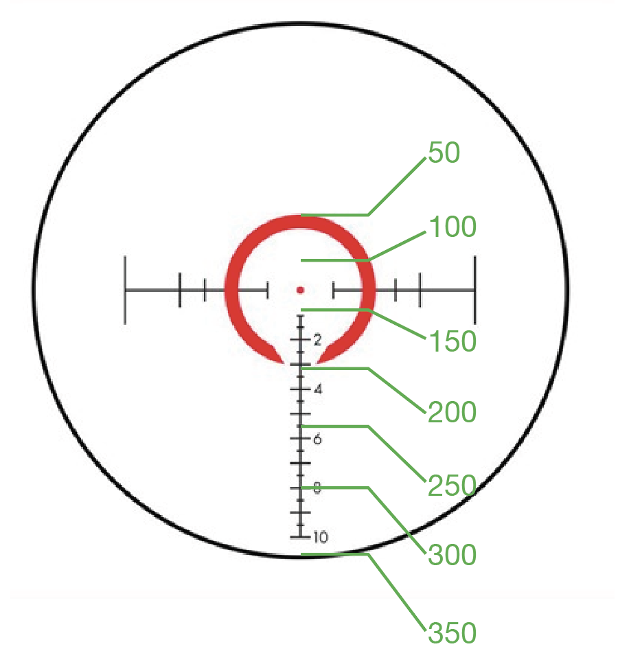

I am pretty deeply on the side that BDC anything will never be exactly aligned to your gun/ammo combination, so for my short range LPVO (a .300 SBR set up for subs) I simply got A scope with sufficient ticks, and then did my own assignment of what the different ticks mean to me, ignoring the original design.
See the ticks have numbers for some 5.56 load and velocity, but I am ignoring them, have a version of this printed out on the side of the gun.
I got into this mode because I saw people will drop charts on the side of their ACOG, for example, and asked. They had notes about how THEIR gun shot a LITTLE different from the BDC ticks, so marked how so they held over correctly.
(FWIW: mine happens to be an SMRS with the BTR-2 reticle, but that was based on other things I needed (e.g. OAL so I could fit the clipon in front as well), not saying it's the best scope or reticle.)
