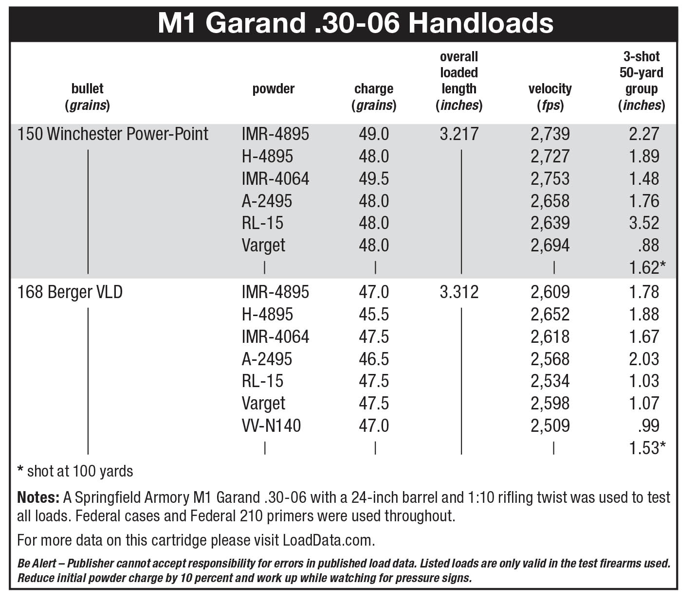

    Maybe start with 45 gr. and work up to 49?

    Like the others have said, your dies, bullets, powder and primers are fine. Winchester brass can be good or bad, give it a try. I think but can not prove that they use better brass in their loaded ammo than they sell as unfired. I've shot a lot of it. Start low and work up to 49 grains.

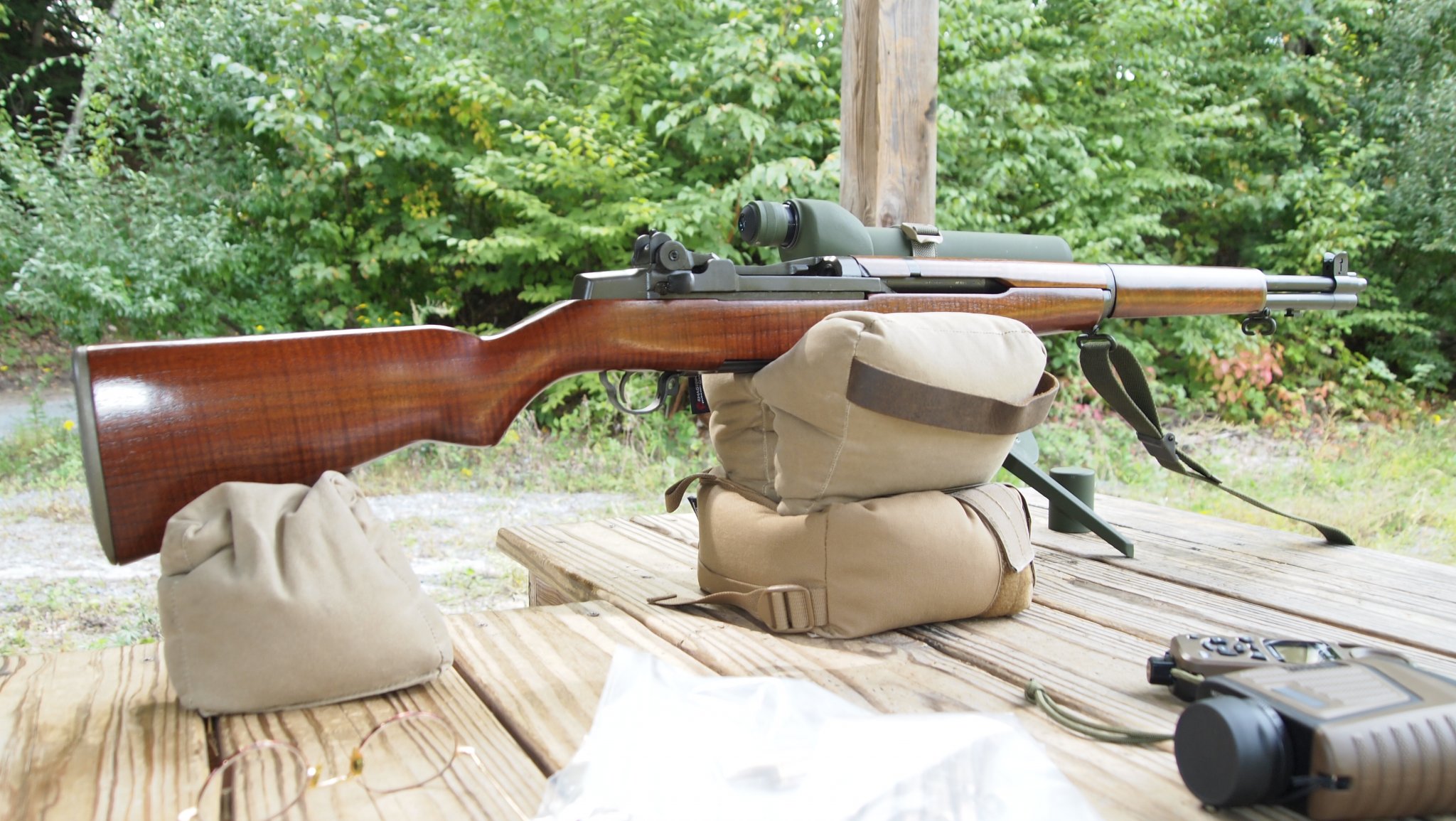

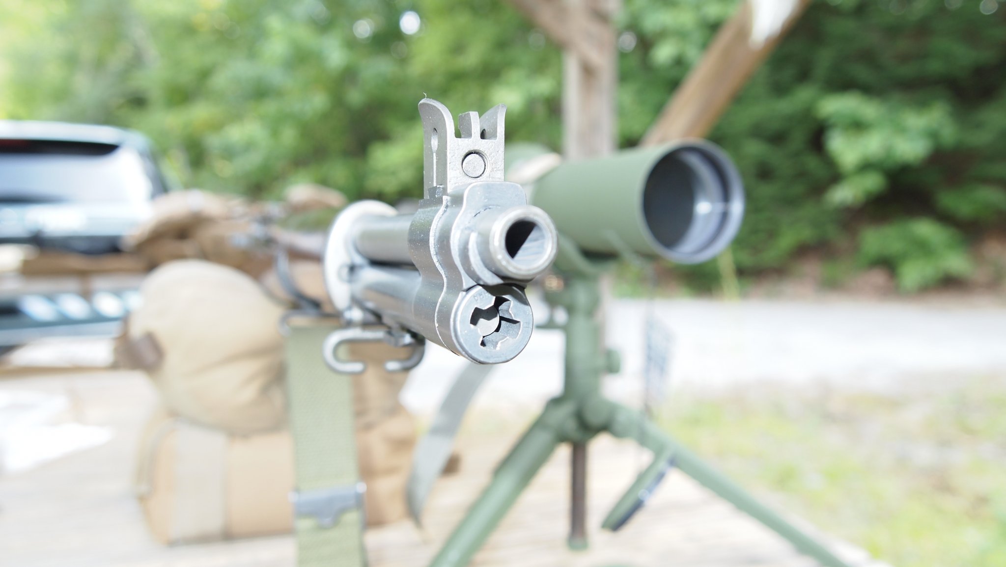

    Brought my Garand to work today and will be taking two hours time at the end of shift to fire up some reloads I made the other day.
    My load is 48 grains 4064 with a 168 SMK, WLRP, HXP 1X brass.
    I did some workup some years ago and found that worked really well at the 200 yards I was testing it.
    I think for 4895 with a 168 I use 46.5 or so grains of powder in mil brass.
    There is tons of info out there for loading up 150s to make a sort of M2 clone round.
    Note M2 is kind of a hot round. The mil had parts on hand to replace/repair rifles. You may be more comfortable, find it easier on the rifle, even more accurate with mid range loads.
    Ill try to remember to come back here with pictures of my shooting results today.

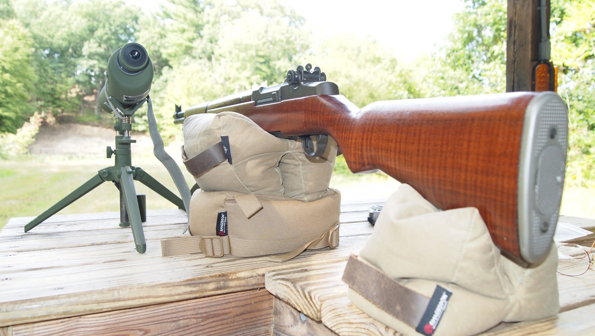

    A recent practice at 300yds with the reduced 600yd target:

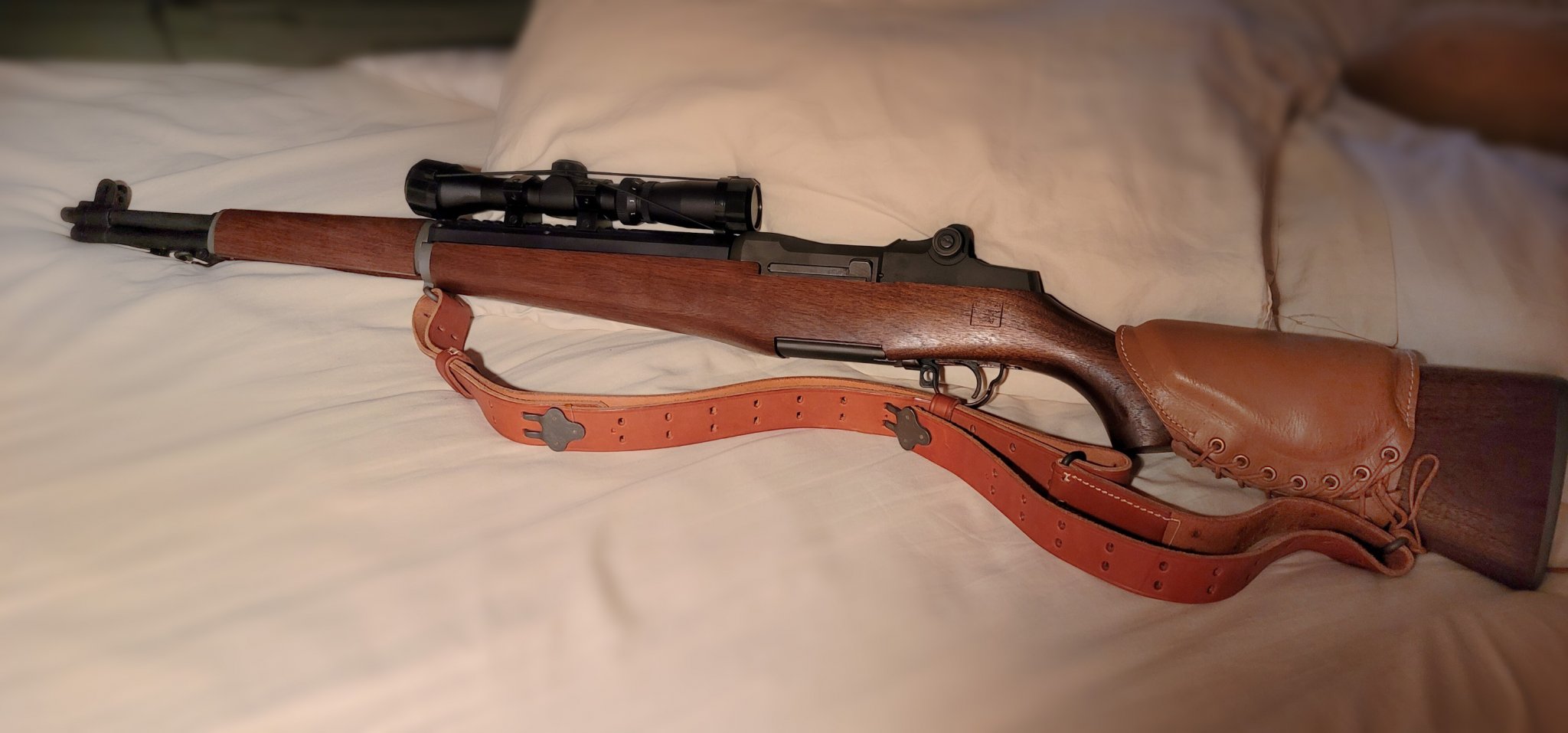

    Ditch the scope and replace the wood where that abomination of a mount is. Irons and 150gr Hornady FMJ work pretty good at two to three hundred. 168 BTHP past that.
    Reactions: spmcpeek
    Aw crap! See that? I bought the scope mount rail and cheek pad years ago... thinking it would be an asset.
    Brand New only shot it with that stuff on it once... and the bummer is I probably can't even sell those parts now... bc nobody is dumb enough to buy theml I guess that's a hard earned $250. lesson down the drain.
    That's what happens when I didn't have this forum to bounce my decisions off of... Thank you for the constructive feedback gents.
