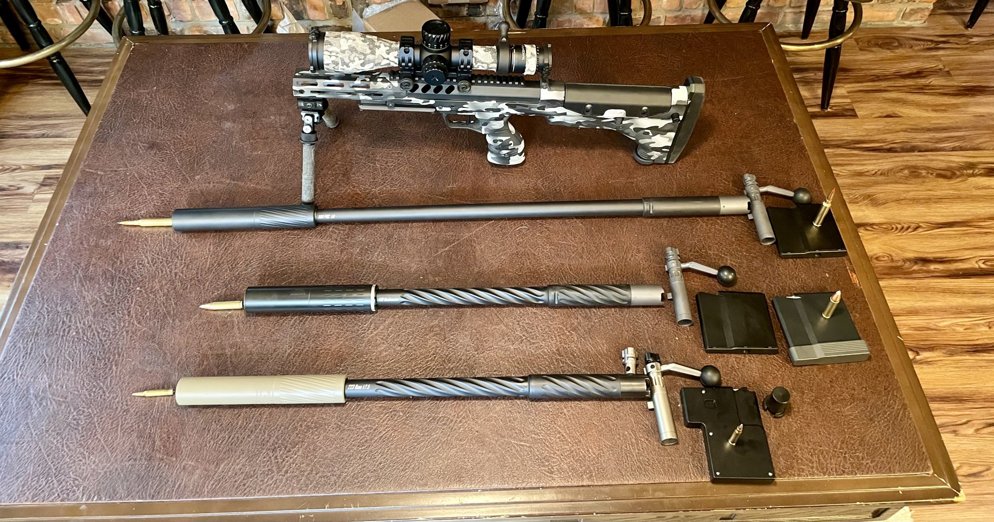

Desert Tech SRS/M2/HTI. The wrench you need is small enough to fit in your back pocket. You can pick up a used A1 chassis for under 3 grand and start snapping up barrels. I change barrels at the range all the time. Takes about 1 minute, very repeatable. I have .223rem, 6XC, .308win, .300WM, .338WM, .338LM.
Do you just torque using the wrench by hand or do you still give the wrench handle a whack to snug up a bit more like you previously mentioned?
as long as you get about 60lbft of tq using the flats on the barrel the repeatability will be better than just hand tightened
Usually i get .1-.2 vertical and 0 to .1 horizontal

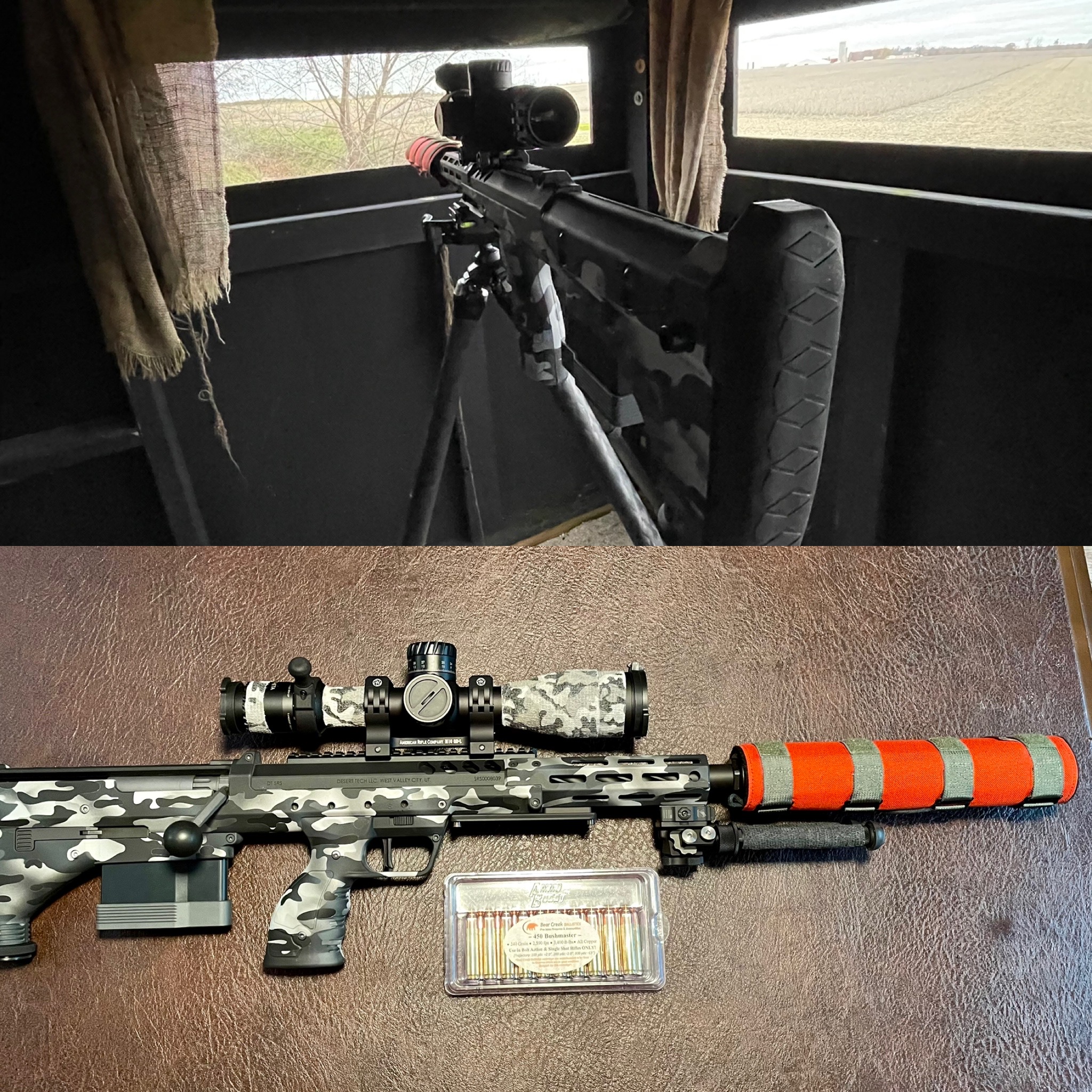

I ended up selling my AI and keeping my DT… easier barrel changes imo, repeatable (the ai was repeatable too), and way more versatile. Having the covert going from 16” 450bm for hunting or 223/300blk plinking to a 28” 300prc for long range is awesome.
Yes the mags aren’t nearly as good as a AI nor the buttery bolt throw of an ai, but they’re pretty sweet versatile rigs
