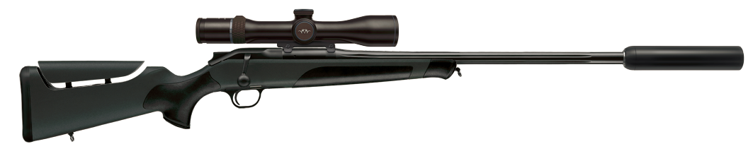

Blaser configurator: https://www.blaser.de/en/products/configurator/
Picture from configurator. 24" fluted matchbarrel. I'll configure it something like this with a S&B 4-16x50 PM2 on top for total weight less than 10ibs. I might go for a std weight hunting barrel to shave off 1ibs.
