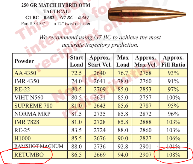

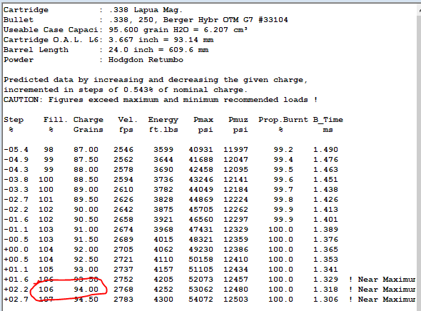

    I have a good reference load for my 338-LM using MagPro, but just got some Retumbo and pondering info from the Berger Load Data as I think about building a ladder test ... Berger 250's and Retumbo ... that shows a fill ratio as 108% for the max charge (94gr). My QuickLoad software lists that charge at 106% of fill rate. My question is ... Is it a bad idea to go over 100%, and should I look for Bullet/Powder options that keep me at or under 100%? Should I just compress it and head for the range? (Or not?)
    This question is slightly complicated by the fact that I'm magazine-limited on my Barrett MRAD and end up with a seating depth that's pretty big ... .6895" on a bullet that is 1.6405" in total length.
    Any advice from the "big bore guys" out there on over-filling a case?
    Berger shows it is max load. QL shows it is just about 10% below dangerous load. So, you have enough information to know that you should work up to that load in increments looking for pressure signs on your way up. If you start to see pressure signs than back off .5 grains and that is YOUR max load. No different than any other load work up. It's fundamental.

    Thank you ... no great surprises there for me regarding start-low and pressure awareness ... but excellent reminders on "process". My question was more about "Fill Percentage" and whether there are any issues (generically) going over 100%.
    It means depending on seating depth or case volume you may get compressed loads of varying levels.
    I don’t like compressed loads as it causes seating issues and or bullets getting pushed back out changing your seating depth.
    People have buggered their seating dies and creased bullets from compressed loads.
    A tiny bit of powder crunch isn’t a bad thing though.
    It doesn’t necessarily mean you’ll get pressure issues.

    You’ve already tried it?
    Just because some computer program says it might be a bit crunchy doesn’t mean it will or that it will be too much.
    It doesn’t have your chamber measurements, density of new lots of powder and probably a perfect case volume.
    If the program says I’ll be maybe at 104% I’d 100% be trying it.
    If it predicted 120% I might think otherwise.
