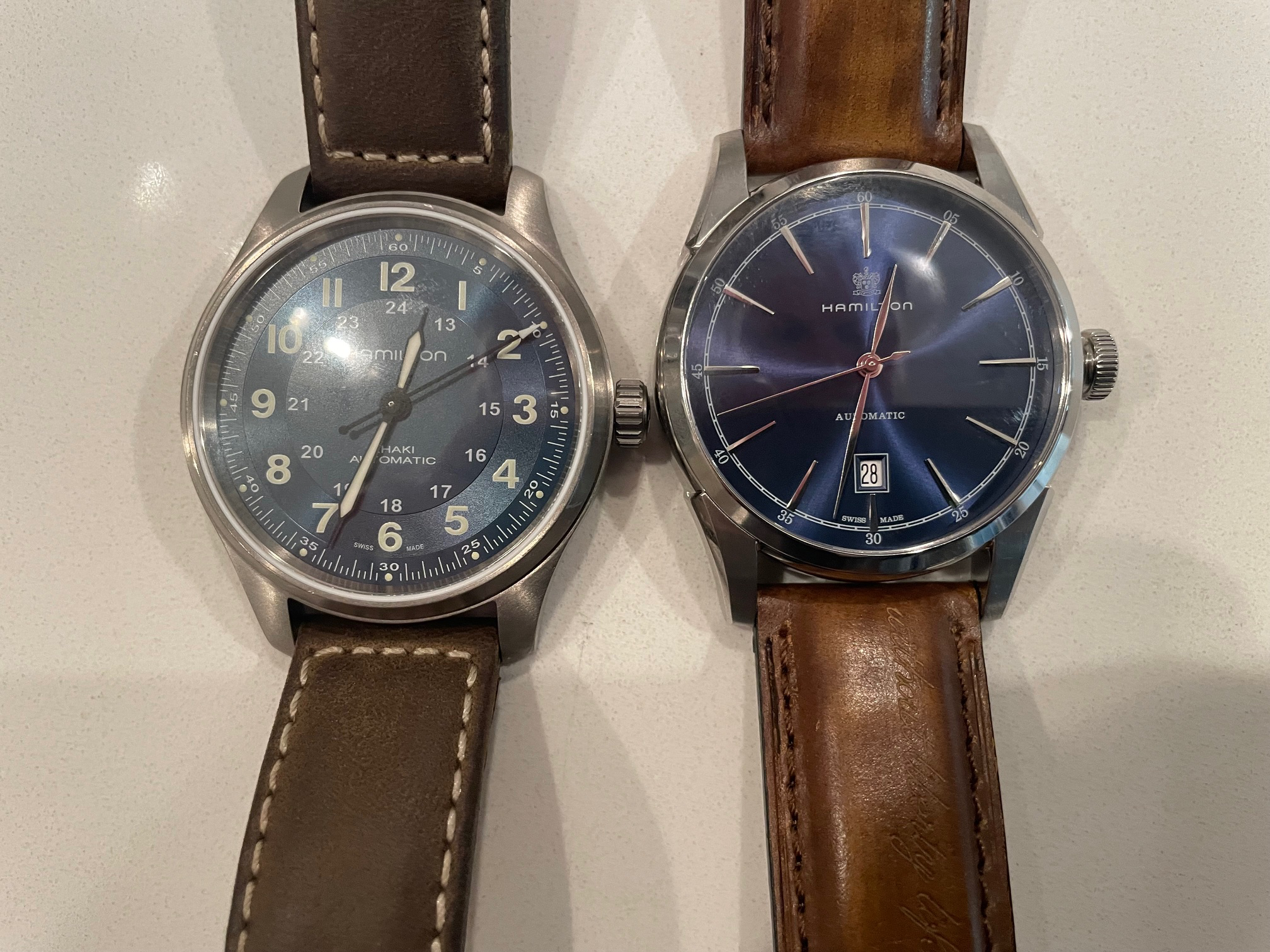

    Hi Hide,
    I recently got into automatic watches- I personally find the mechanics behind them to be absolutely fascinating. This should be a quick an easy question but for those that have more experience than I do with automatic watches- what has been your experience with their accuracy as compared to an atomic clock. Granted I know that a quartz movement is going to be be more accurate but it just lacks the 'nuances' I'll say that I feel is so interesting with this particular animal.

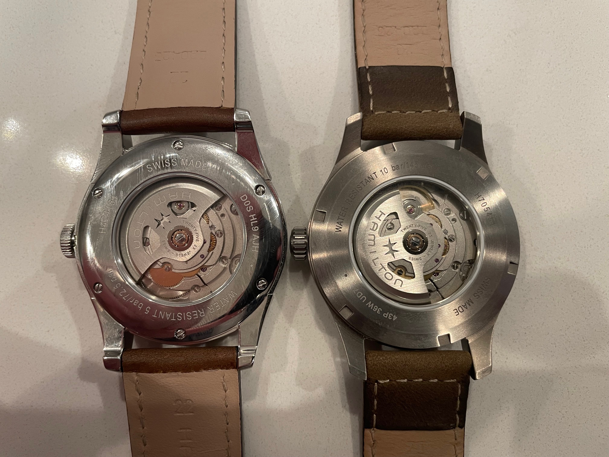

    If it's of any help- I'm happy to share what brands/models I'm playing with here & my experiences... They're both Hamilton's... from what I can tell both using the same Swiss movements, one field watch with a titanium housing, the other a more... dressy watch with what I'm all but sure is a stainless steel housing. The more dressy watch has a date box (so maybe a minor difference in the Swiss movement that they use).
    I've been playing around with the field watch almost exclusively trying to nail down the accuracy and my longest test has been a day or two over 3 weeks and if I'm doing my math correctly I'm running fast just about 8 seconds a day.
    I know that different brands have different tolerances but I was just curious what other's experiences were using automatic watches. 8 seconds a day (one way or the other) might not sound like a tremendous amount but the compounded effect can be... rather interesting I'll say. Likely this is just the 'nature of the beast' with mechanical timepieces but is +/- 8 seconds a day what you're seeing and if you use mechanical/automatic watches in your daily life- do you have an established protocol of when/how often you re-sync your watches to keep you moving forward?

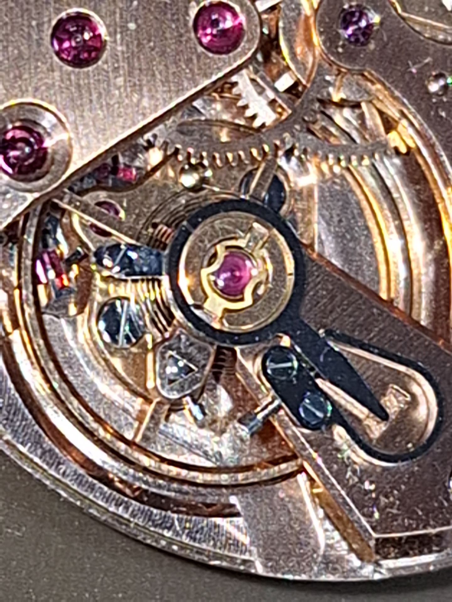

    Are you asking about regulating the H50 movement, or are you asking if you need regulation? Only you can answer the second question.
    Start logging your accuracy in a google sheets file. Be consistent in your wearing habits, and start with a fully "charged" watch.
    As a standard, use a Solar Atomic G-Shock synced at midnight each night, or your phone using tower time (not device time), or time.gov in that order.
    If you want to be closer to zero, try different positional regulation techniques at night- crown down, crown up.
    Do this for one month.

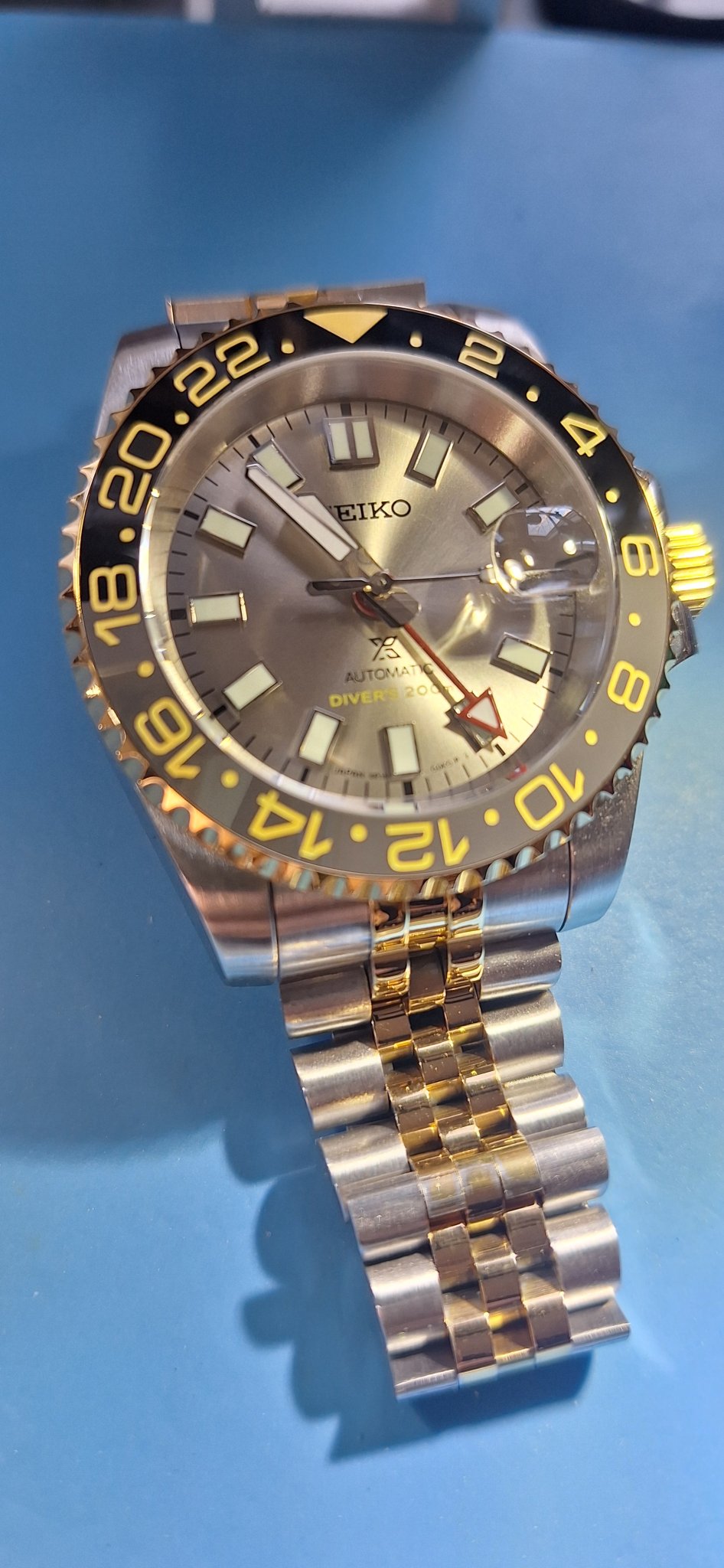

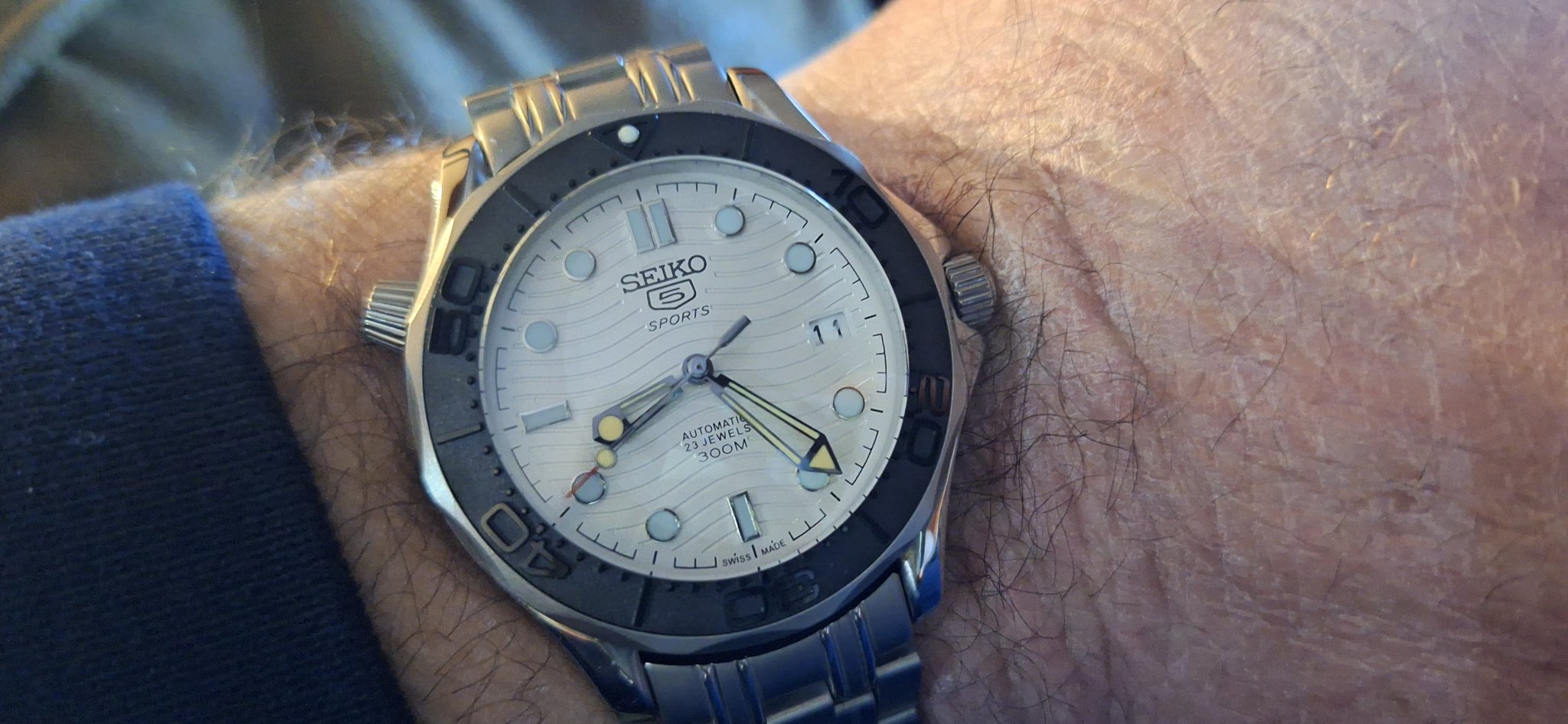

    I regulate the 7S26 and NH35/6 to a high degree of accuracy doing this.
    Skip that for this issue.
    They're not vintage timepieces with unknown service history and use, so he's not worried about amplitude.
    For the accuracy- Learn the art of patience.
    Dudes who timegraph for 10 minutes and then adjust, timegraph for 10 minutes and then adjust, etc do not end up with as good a result as someone who measures and adjusts once a day at a convenient, quiet time.
    One of the areas I decided I didn't need $3k worth of tools to save $100 every few years.
    It's definitely not $3K of tools for a basic hobbyist setup.
    An Aliexpress Jaxa wrench and a holder is like $5, and a pack of wooden matches from a fine drinking establishment is free.
    Staying on top of regulation can actually hide some issues where it might be more beneficial to overhaul, replace parts, and lubricate.

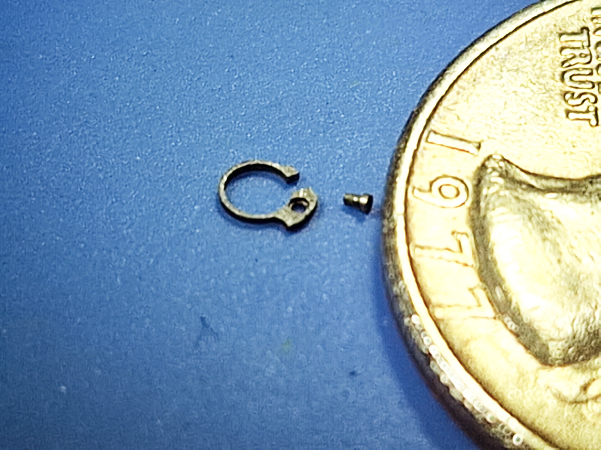

    The replacement for a screw I broke came this morning. Re-engaged in assembly. By afternoon I was searching the interwebs for another part that flew off the bench. By the time I finish this it'll have doubled in value from age.
