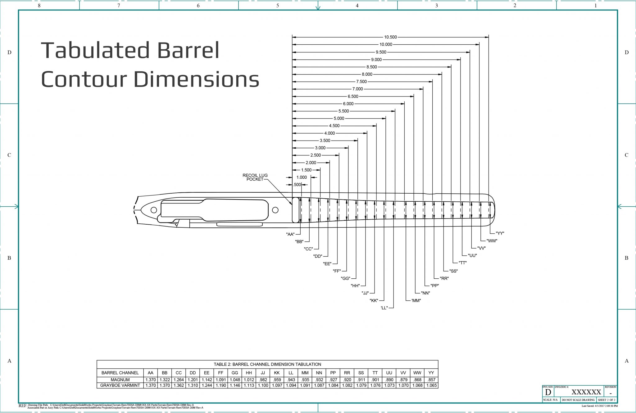

On their website the barrel channel dimensions seem pretty tight. Tight enough a m24 or MTU barrel should have no chance of fitting. Anyone have any pictures of those barrels in a ridgeback to see what kind of clearance they have?
Here is the diagram from their website showing dimensions:
They wont fit. Rem varmint is the largest. These stocks open as easily as Mcmillans and Manners. It would take just a few minutes to fit it yourself. I’ve done several grayboe, manners and Mcmillans.
