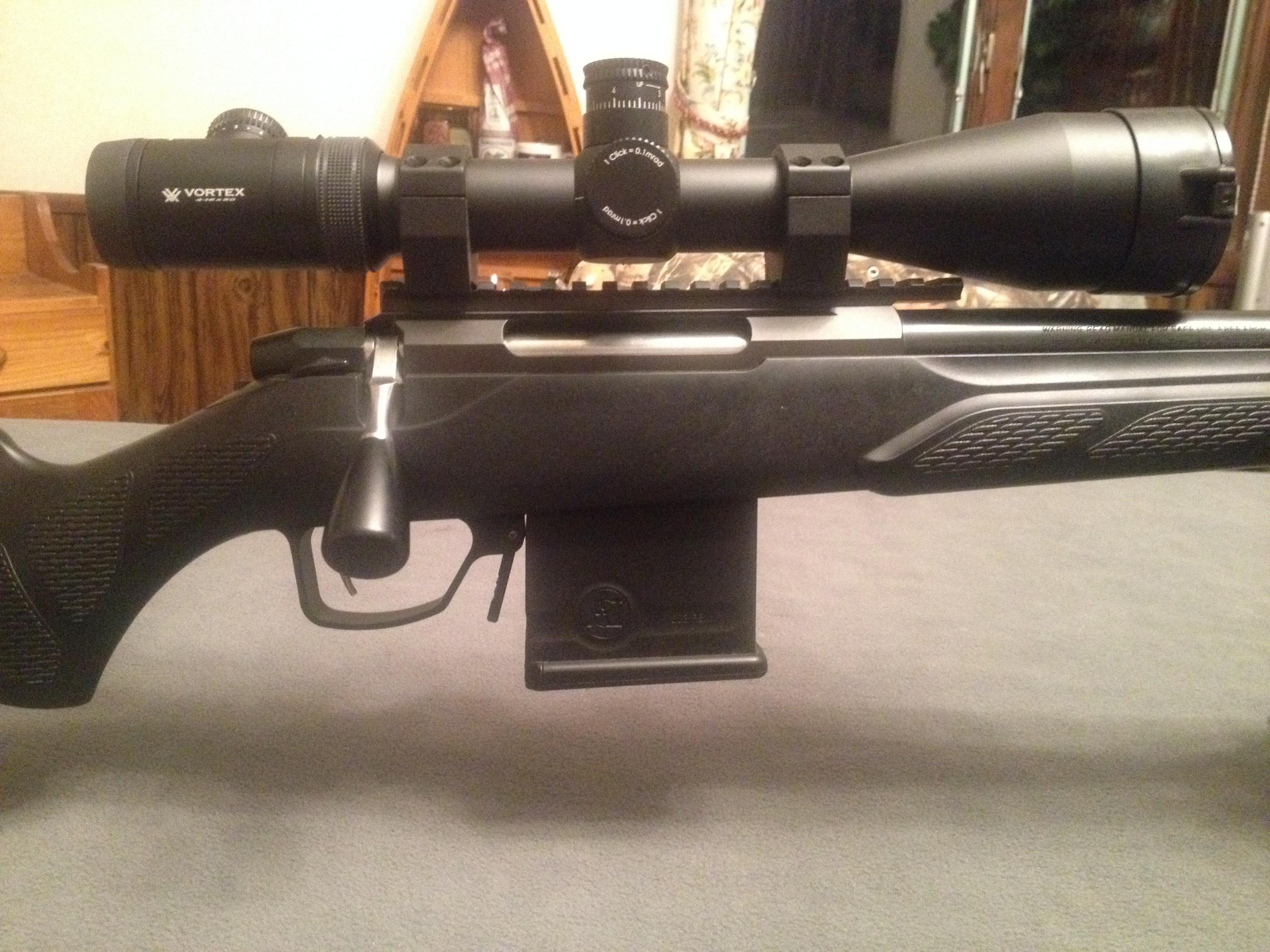

I have a Razor 5-20 mounted in Vortex (seekins) PMR-35-95 rings. This is on my 700 Sendero with Farrell 20 MOA base. They provide plenty of room for scope covers.
