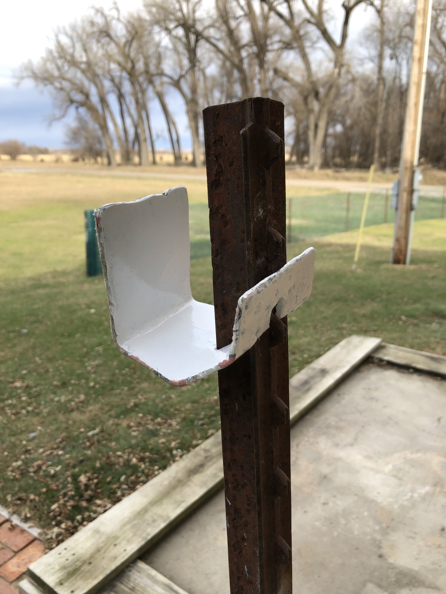

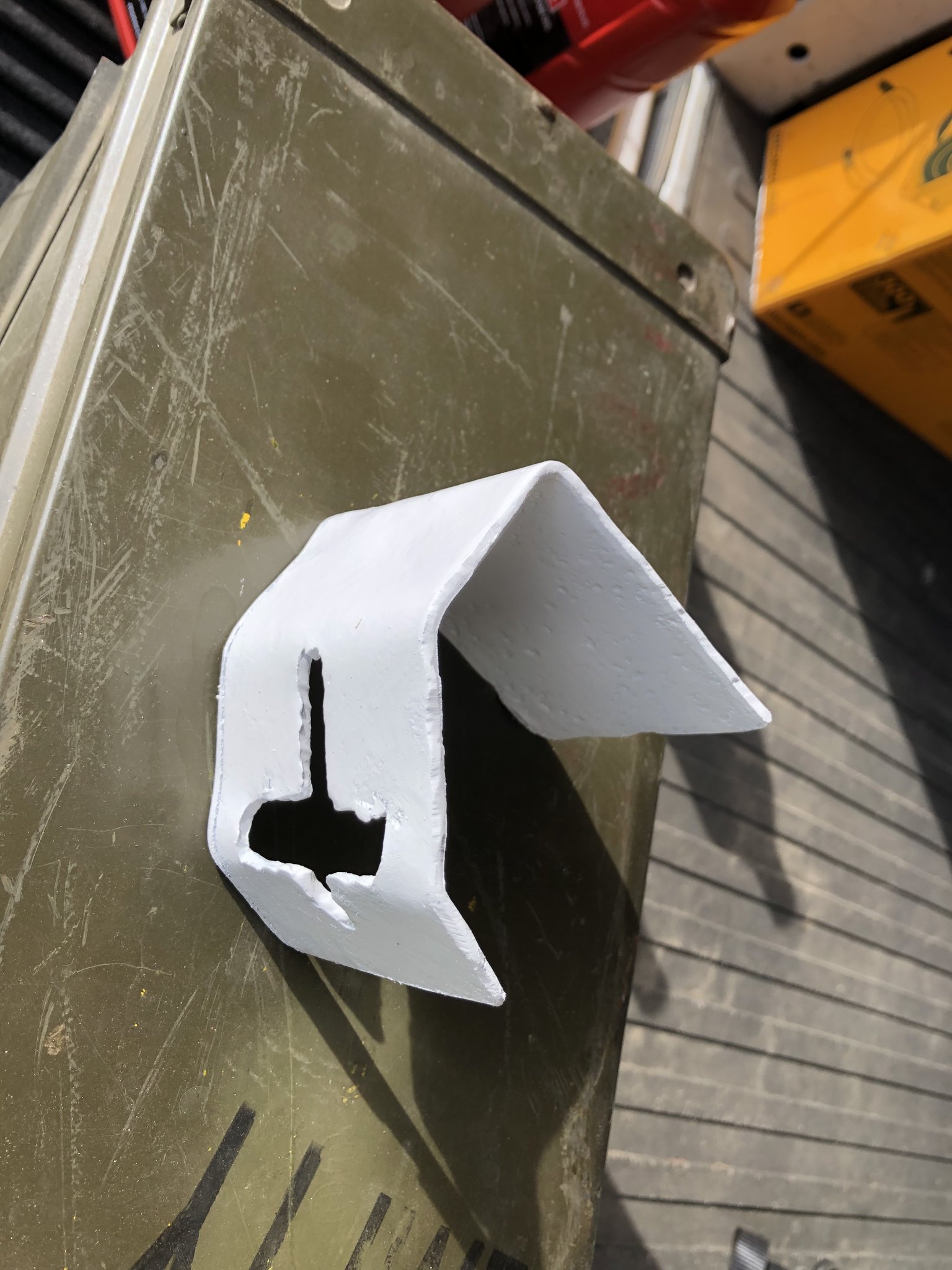

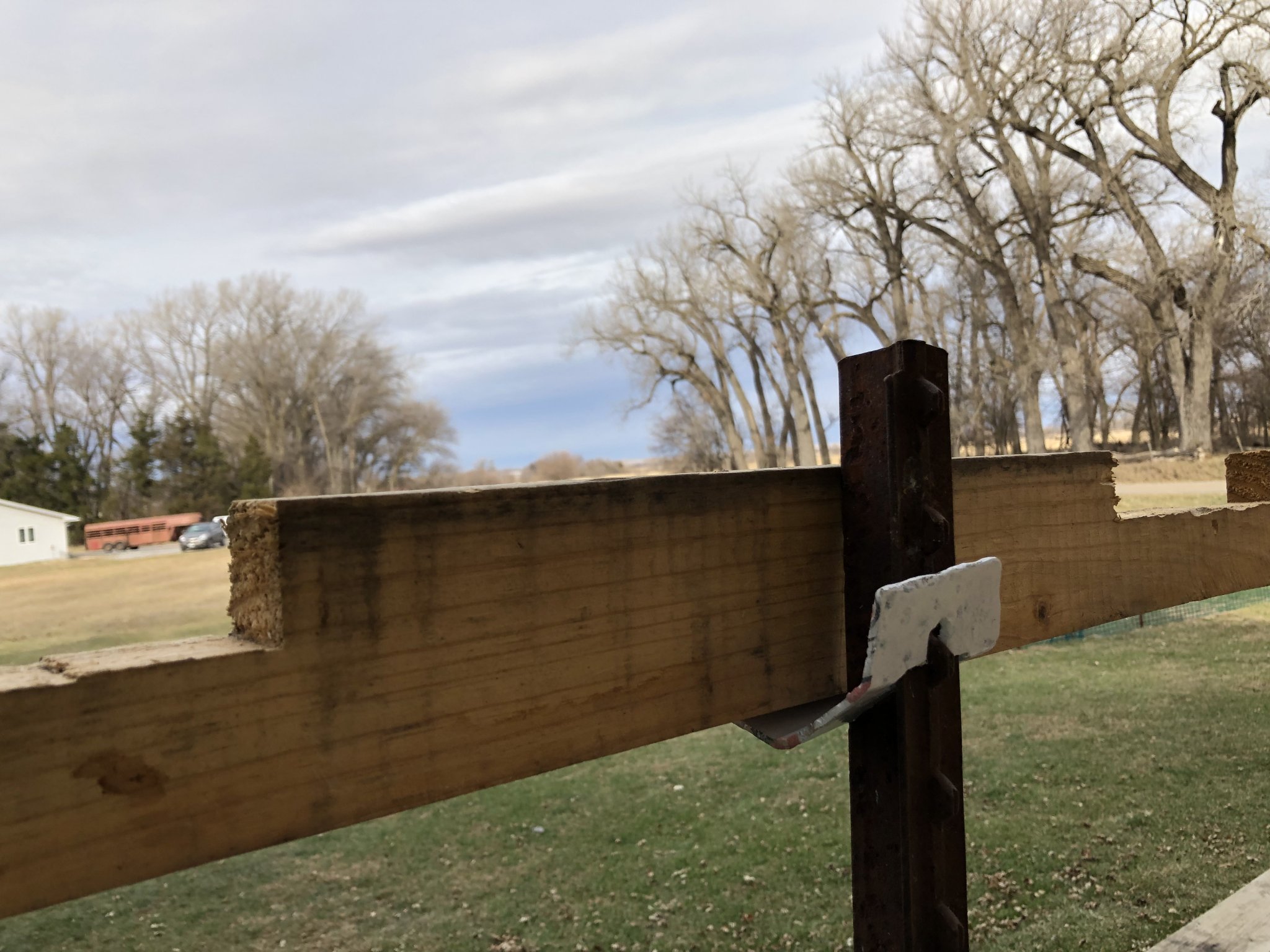

Whipped up a few of these brackets the other day and they sure are slick. Rick them up, slide down the post, Rick them back down, and slide your 2x4 in. The 2x4 keeps the bracket from unlocking, and no screws needed to keep it in place. Just attach your conveyor belt hung targets to the 2x4 and you’re in business. Makes rangeset up pretty fast for those of us who aren’t lucky enough to have a dedicated range. What do you guys think?

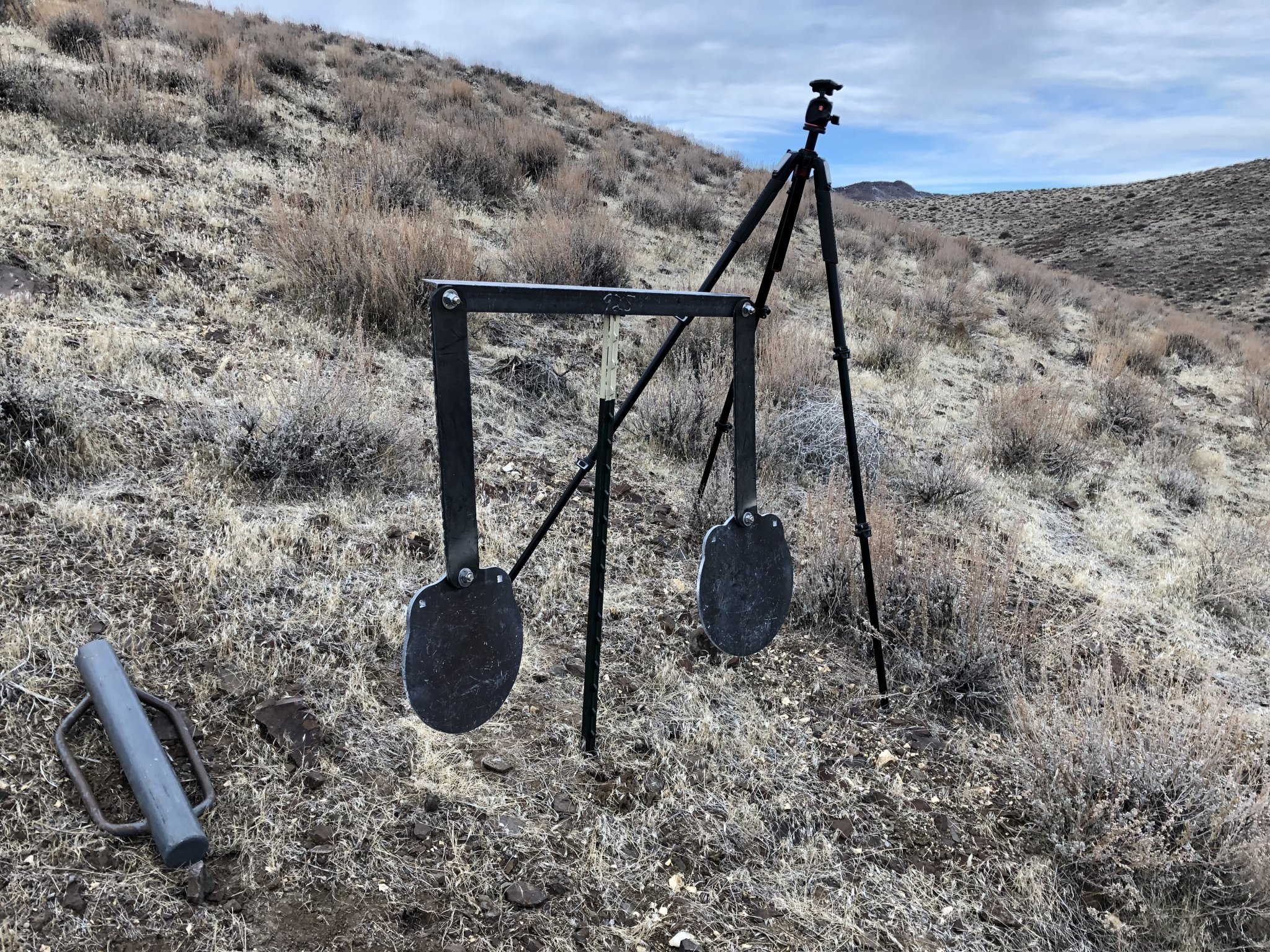

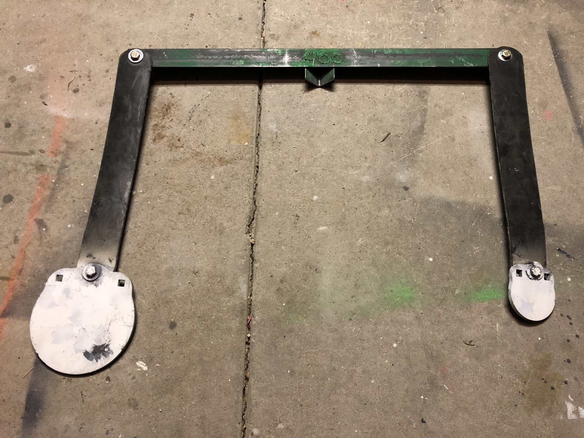

You obviously have some fabrication skills so here’s another idea for target hangers
Reactions: Mr. Z and Brent B

Start producing I’m in lol...Great idea!
47guy. I like it! May have to add something like that. I’m just screwing the belts to a 2x4 between 2 of these, drive the posts, drop in the 2x4 and you’re on to the next distance. Can do an entire kyl rack with 2 posts set up really fast

Very nice. I like the hanger idea.
