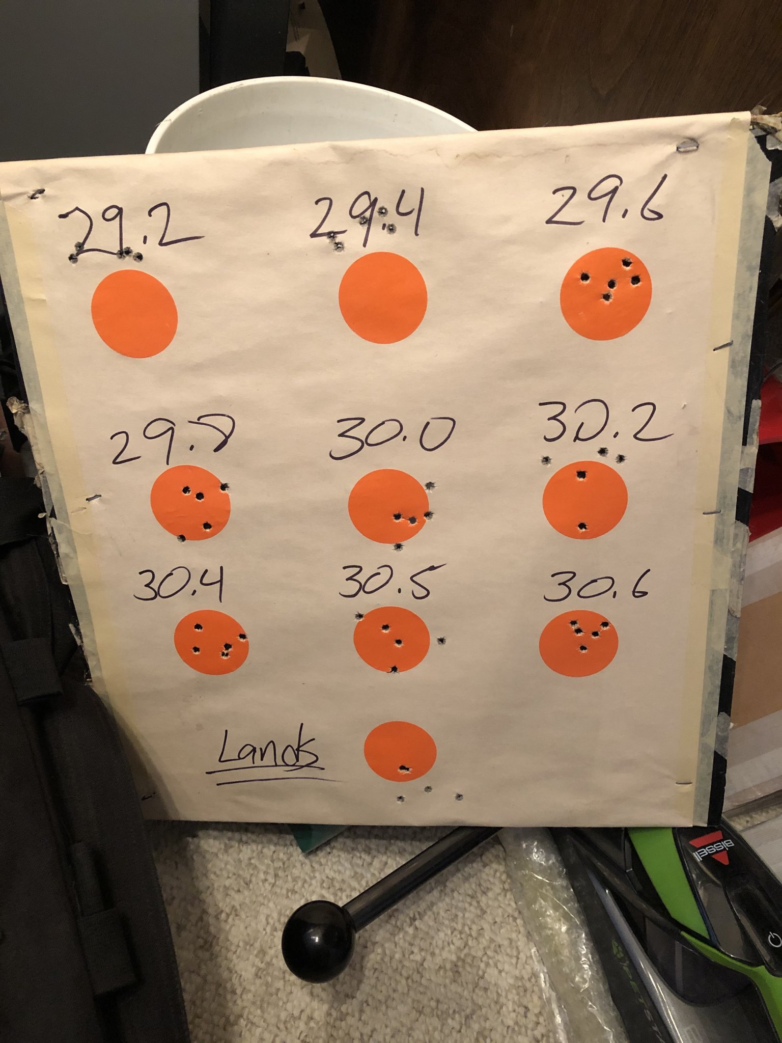

This would be a solid plan, though I'll say that my personal preference is to shoot 5-shot strings for added sample size.
Also, for targets I like to use orange dots on a big piece of blank news print or other light paper with the charge weights written above each in big writing using a Sharpie. This way you can make sure you're shooting at the correct target for each load. And I use the orange dots instead of something like a Shoot n' See because we will subconsciously try to correct if we see the previous impact. For load development, I prefer to have to walk down to the target to see the results. Shoot all your strings then go look - and at 300 yards, shoot with the scope magnification fairly zoomed out - just enough that you consistently put the crosshairs in the center of the dot each time.
Also make sure you write the charge weight on each case using same said Sharpie. Having your ammo box fall over will ruin your day in a hurry without. Ask me how I know...

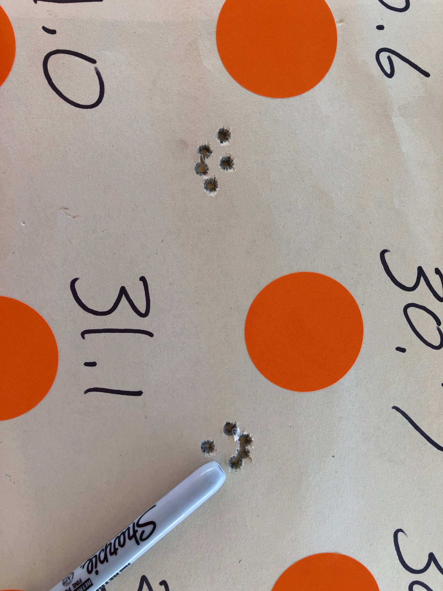

EDIT: I found a pic of my first load dev target for my 6BRA at 300 yds.
What did I do wrong here?
Well, my best group was at my top charge weight. I stopped there because during a previous ladder test, I got a sticky bolt at 30.8 gr. But I didn't test 30.7. This necessitated me going out for a second where I could test 30.7 gr and 30.8 gr again to validate the sticky bolt (which I did) - at least I doubled up on the second trip by also validating my ideal seating depth, which is depicted in the improved groups.
I got this:
Note that the 31.1 weight below is for a different powder and bullet, which didn't work out.
Reactions: ShtrRdy
