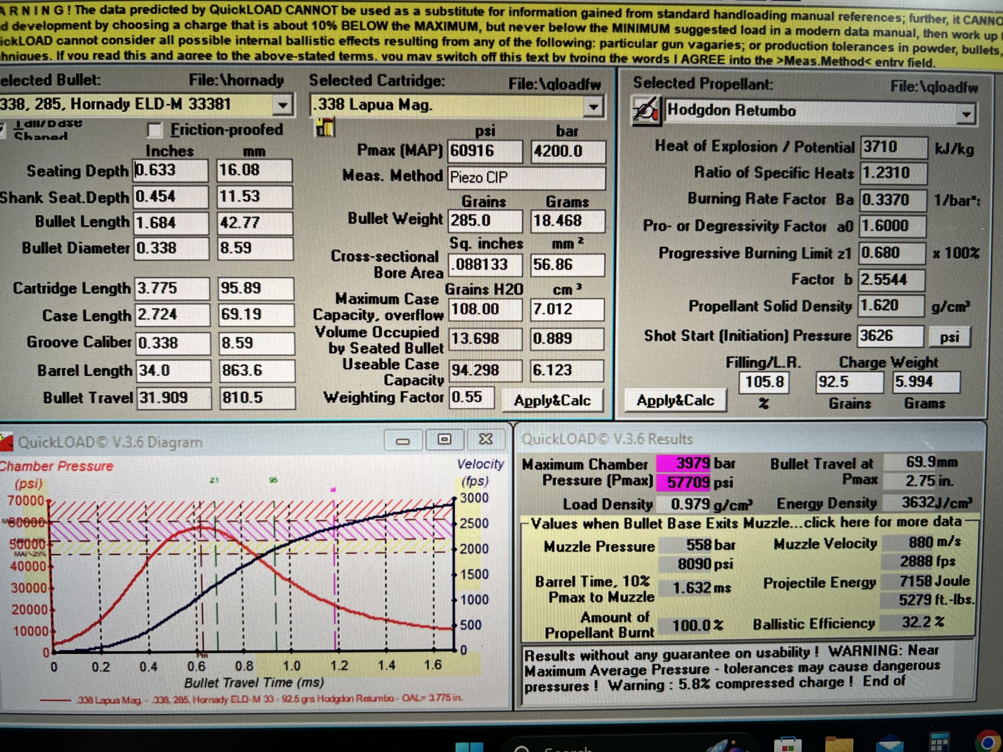

    Why does QL list 108 grains H20 as CC for 338LM? Over several chambers, my fired brass has 116 on the money. It throws off the calculations for the entire cartridge.
    It largely depends on the particular brass you're using. The good news is, you can change QL case volume accordingly, like for you it's 116 from the 108 default number.

    but then the pressure goes down and you have increase the powder charge to get anything near a reasonable pressure/velocity.
    Alternatively, if I leave it at 108 grains, and use my current powder charge, it gives a reasonable speed and pressure but the case fill % is well over 100%.
    There must be an error somewhere.
    And I'd wager that there is not a single 338LM brass with a capacity of only 108 gr H2O. that's like 7% below what my Lapua (thickest/heaviest) case weighs.

    For curiosity, I just checked a few cases here and they averaged....... 116.2
    Anyway, I was going to suggest you could pose the question to the support folks at Lapua/Capstone and to QL support and see what they say?
    Adjust the volume and you can even permanently adjust it. Then make sure all of the other measurements match your setup. If the calculations are off at that point, adjust your powder BA burn rate until it predicts matching velocities. Then save that ba value for the burn rate for your lot of powder. You always need to adjust the default values to match your lot of powder as it could change between lots. Also don't ignore the shot start pressure that you can edit also as it also matters.

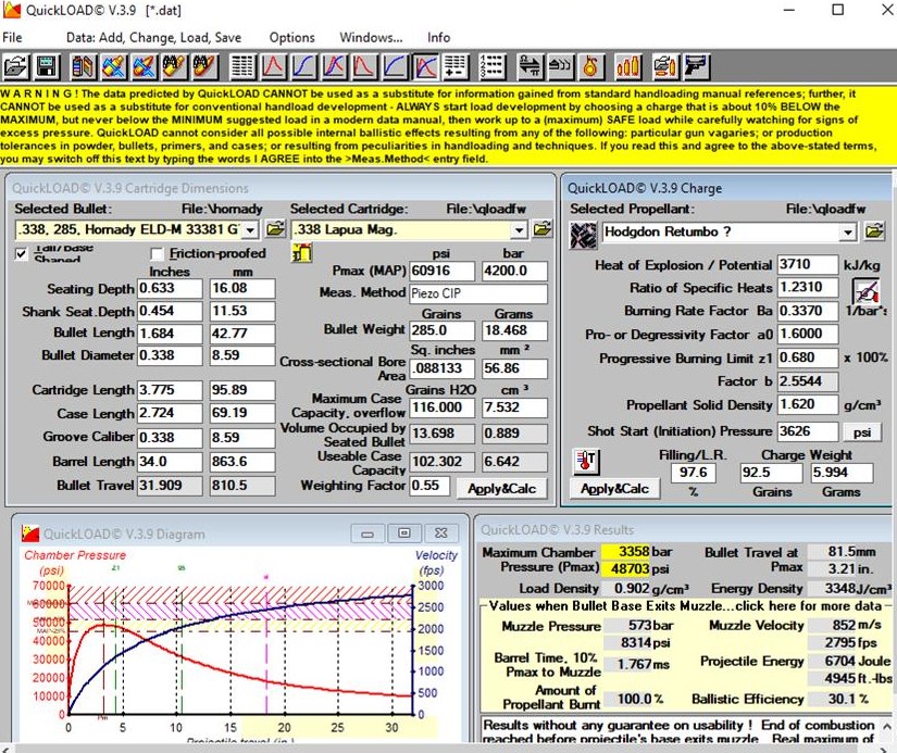

    Thanks guys. I’m pretty familiar with most of these nuances of the program.
    The thing I am stuck on, is that the case volume in grains of water does not correspond to what percentage of the case is full with a particular bullet and a particular COAL
    I understand there are numerous adjustments I can make as you all have enumerated. But this seems a simple matter, right? If I seat a 285 WLD-M to a COAL of 3.775 inches, and I can hear space in there when I shake it, the program should not tell me I have a 104% case fill compressed load

    Here it is. 338LM. load cartridge then bullet and it populates with 108gr capacity which is 8 grains or 7% too small.
    When I load this into a Lapua fired or resized case, like every other normal person on the planet, that case is 116 gr capacity, and I feel no crunch and there's room when I shake it. The output says I'm 105.8% full which should be a compressed load. It is not.
    With that load, using 116 gr H2O the case fill is at 97.6%; plenty of room for more powder and with an adjustment for powder burn, I don't see any real issue. . . .??? 🤷‍♂️
    Adjusting burn rate and not temperature to get your velocity of 2888 fps:
