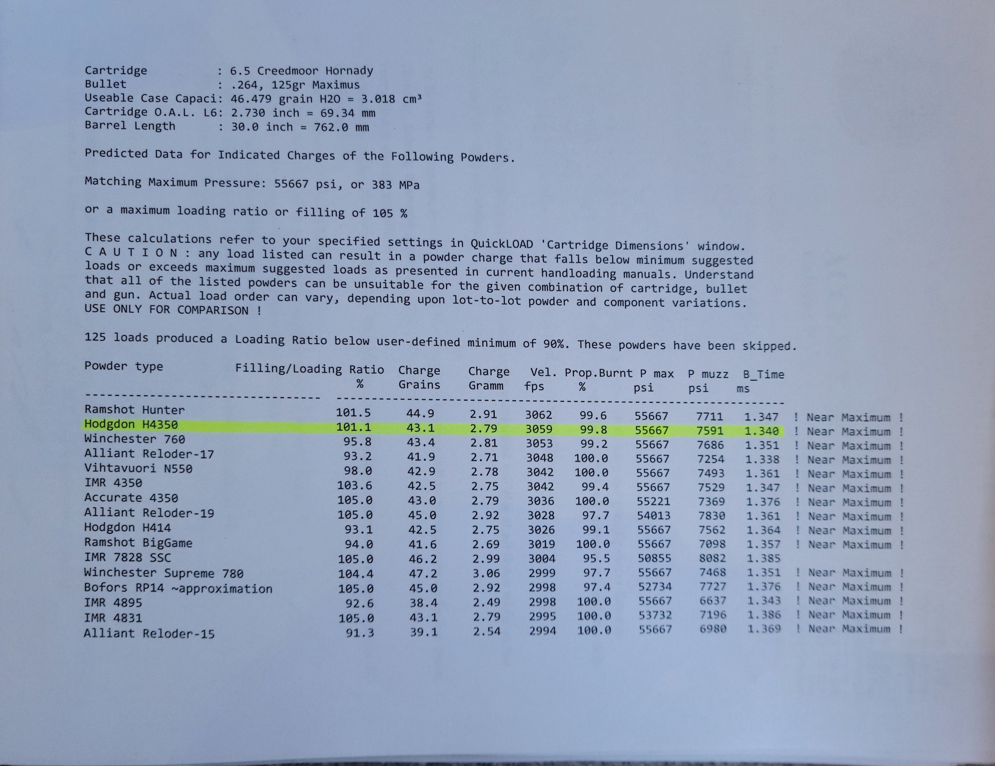

Anyone be willing to run some numbers for me? for 6.5 Creedmoor
Cutting edge bullets
.264, 125gr Maximus bullet
IMR 4451 powder
Lapua LRP brass.
22" barrel
Id really appreciate any help with this. thanks in advance.

Cutting edge sent me this data they had
Just with a 30" barrel
Didn't have 4451 on the list of data they had.
Is H4350 close enough to imr 4451?
I'll just start my loads way low on charge and work up. Wish I could get faster powder but this is literally all I have been able to get in months. Apart from 4451, I have about 10lb of varget and 10lb of reloader 23. And then about 6lb of H335.
What powder would you recommend looking out for preferably? I might be able to trade some of my varget for reloader 17 with a buddy.

IMR 4451 and H4350 are close in burn rate but Quickload is telling me 4451 is too bulky a powder to be useful.
I won't use a powder without published data from either the powder or bullet company which I then fine-tune with QuickLOAD.
I would look for one of the powders on Cutting Edge's list.

Thanks for the info. ill talk to a buddy and see if i can trade for some reloader 17 then. i like it had 100% burn with only 93% capacity of case filled.
I use 4451 for 140 ELD-Ms in my 26" Proof CF. I'm getting about 2860 fps with 42.3gr and got started to receive pressure signs around 43.6 gr with Peterson brass.
I have been using Gordons Reloading Tool which has been extremely accurate with all my cartridges, only being off 10-15 fps with actual velocities. Its also open source, and is constantly being updated with gathered data from the community. Its database on bullets, powders, and cartridges is phenomenal, I don't have QL however, so I can't compare.
