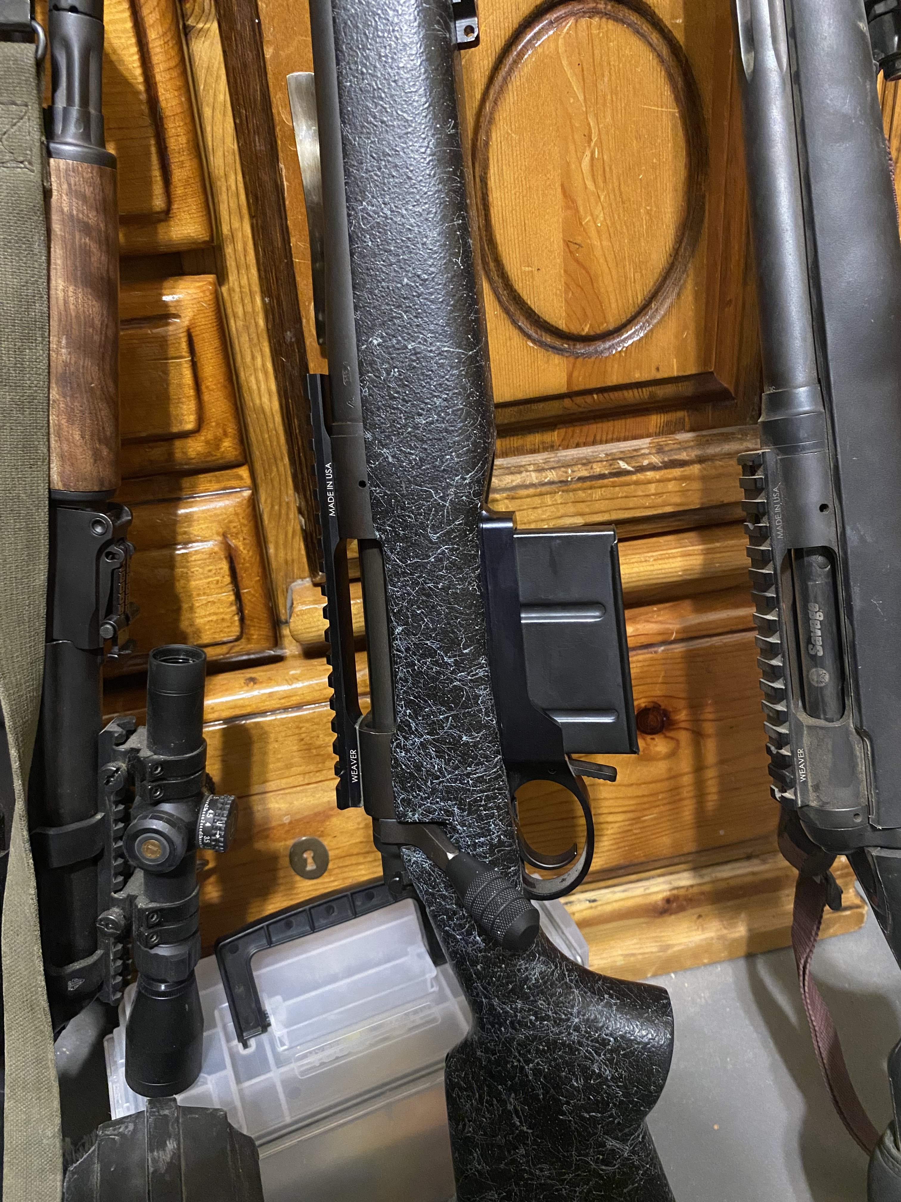

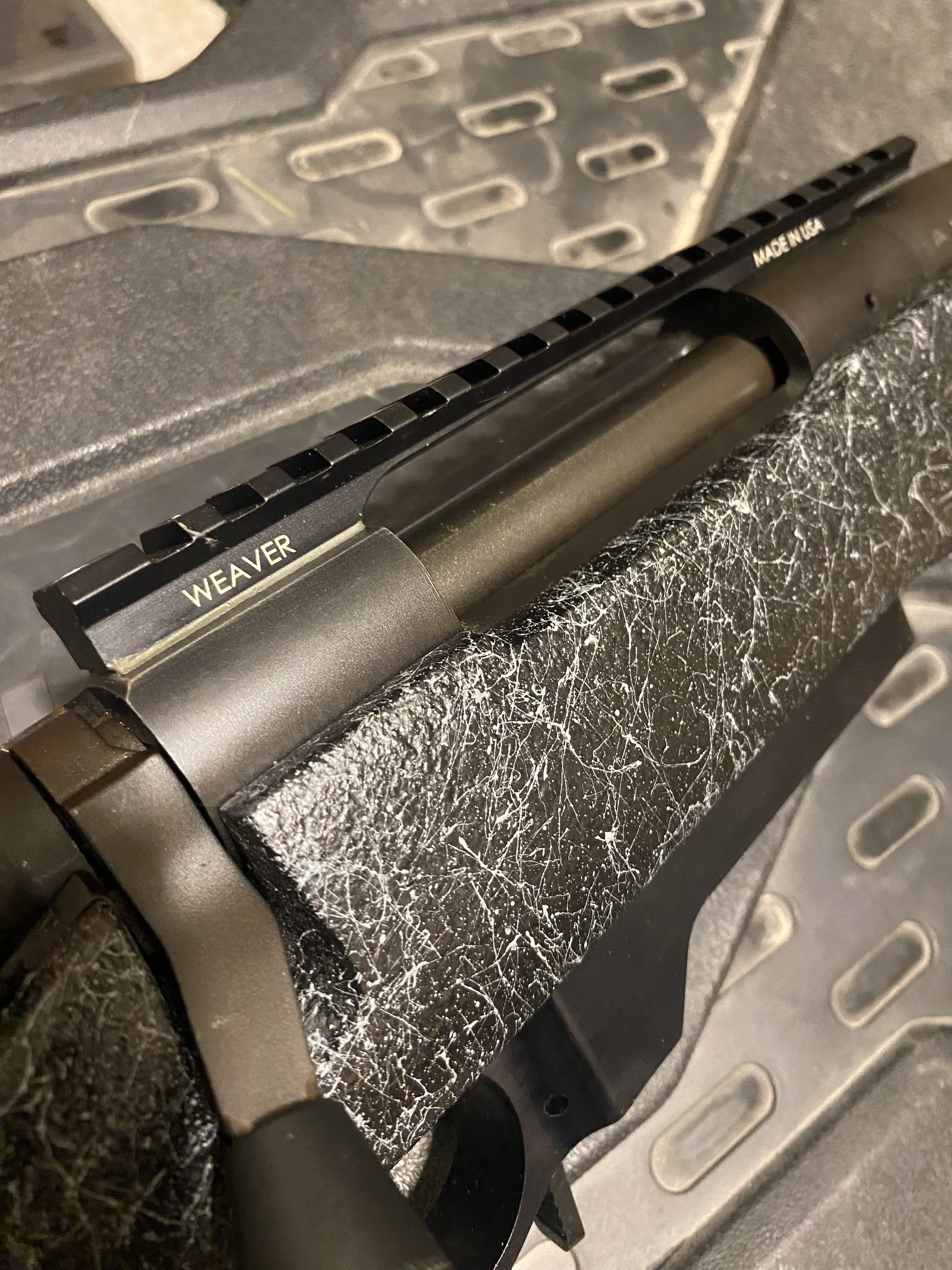

Just got an elk tag and pulled an old 300wm out of the safe, it probably hasn’t been shot in 7 years. I noticed the muzzle threads are messed up, I sent it to be threaded years ago and there is no relief cut between the threads and shoulder so a suppressor or muzzle device doesn’t have a square shoulder to index on. Anyways I want to order a new barrel for it and am thinking about going the 7prc route. Everything I read says going from 300wm to 7prc is just a barrel change, I read they share the same bolt face. My question is will the 7prc cartridge fit in an old AI mag designed for 300 wm? I also need to decide on barrel length and profile, I’m kinda leaning towards 22” sendero, but open to any advice.

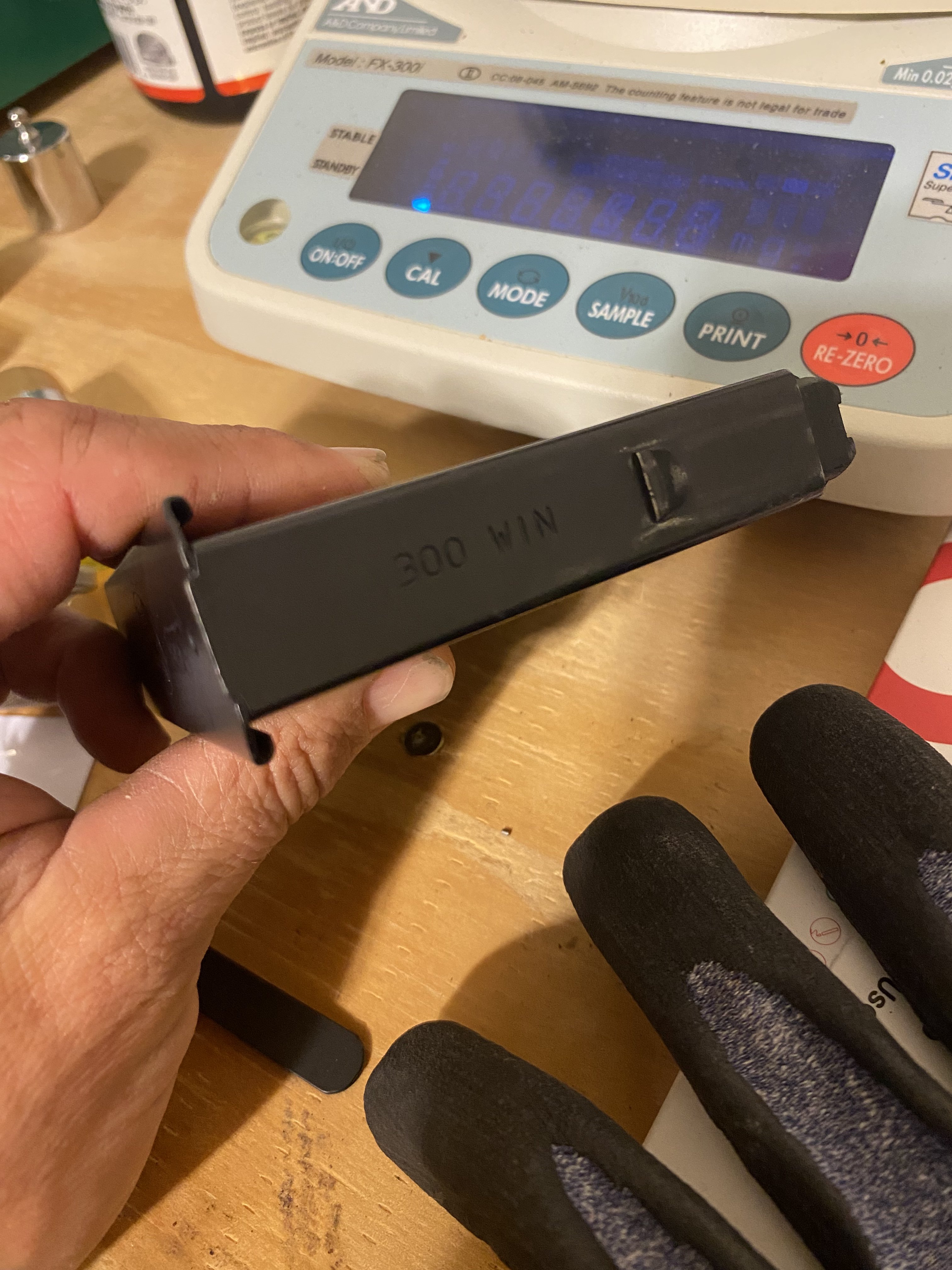

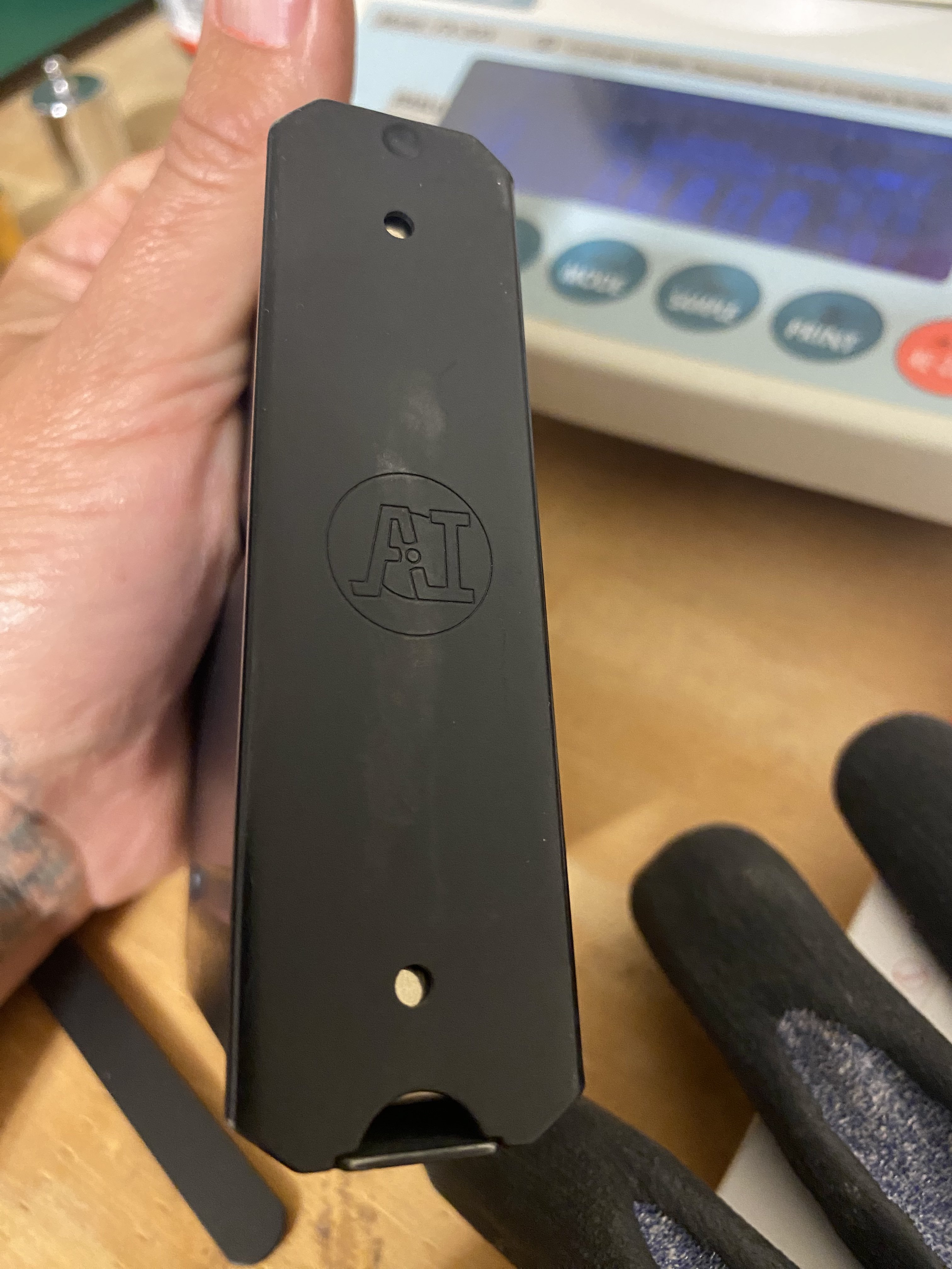

That mag should work fine. At most you’ll need to make a feed lip adjustment for the more square shape of the PRC.

Thanks for the correction on the magazine, I thought since the prc case is shorter it still fit in the standard length mag. A CIP length mag isn't that much.

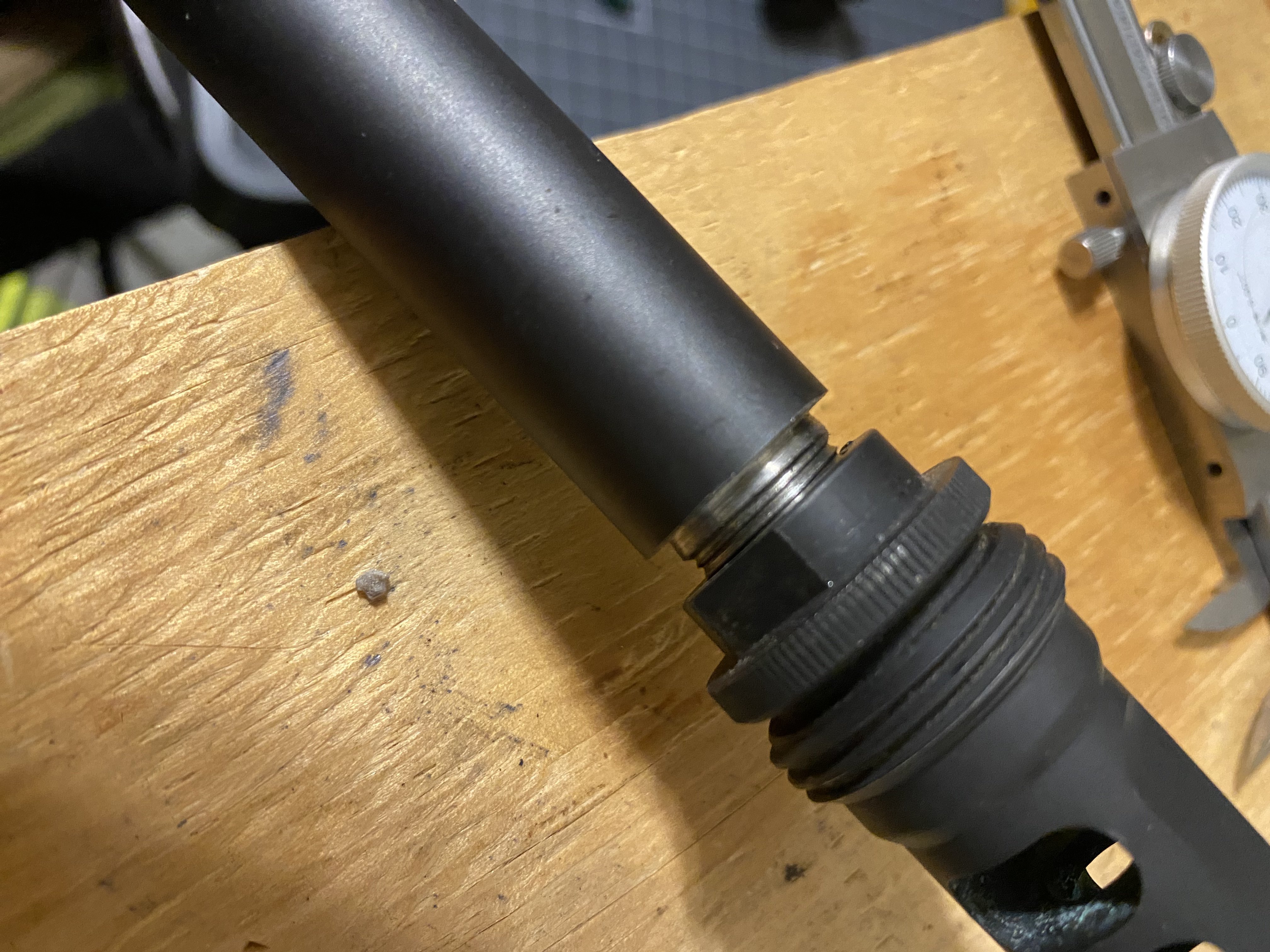

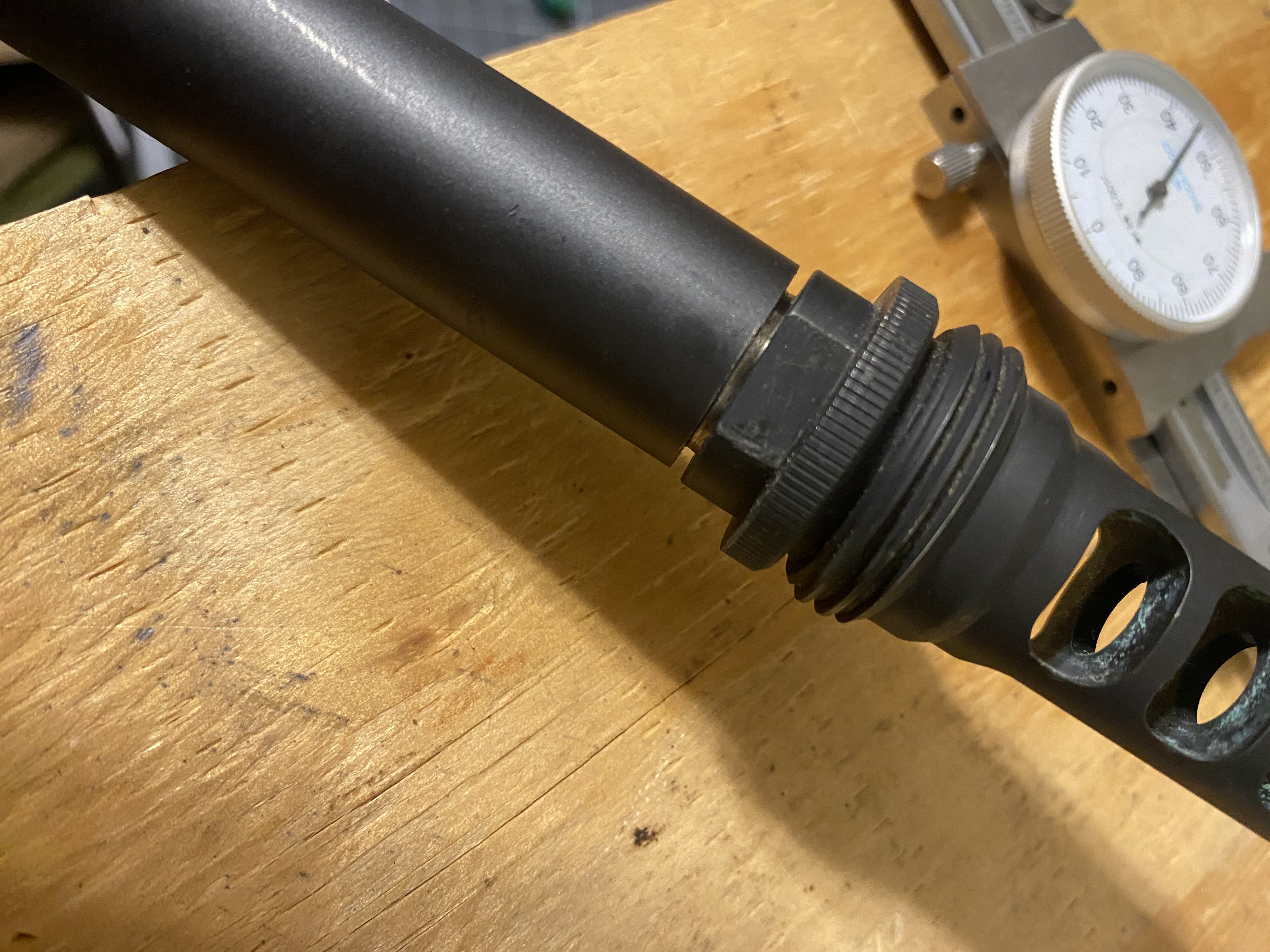

Also, what makes you think the shoulder isn't square? A relief cut isn't mandatory, some folks pride themselves on being able to thread without one.
Maybe I’m not using the right terminology, I’ll send a couple pictures of a brake threaded on as far as it will go.
Yeah, that's ugly. They stopped the threads short, a relief cut should fix that and allow the suppressor to seat. Would be an easy fix, but if they fucked that up, I wouldn't trust it to be concentric.
