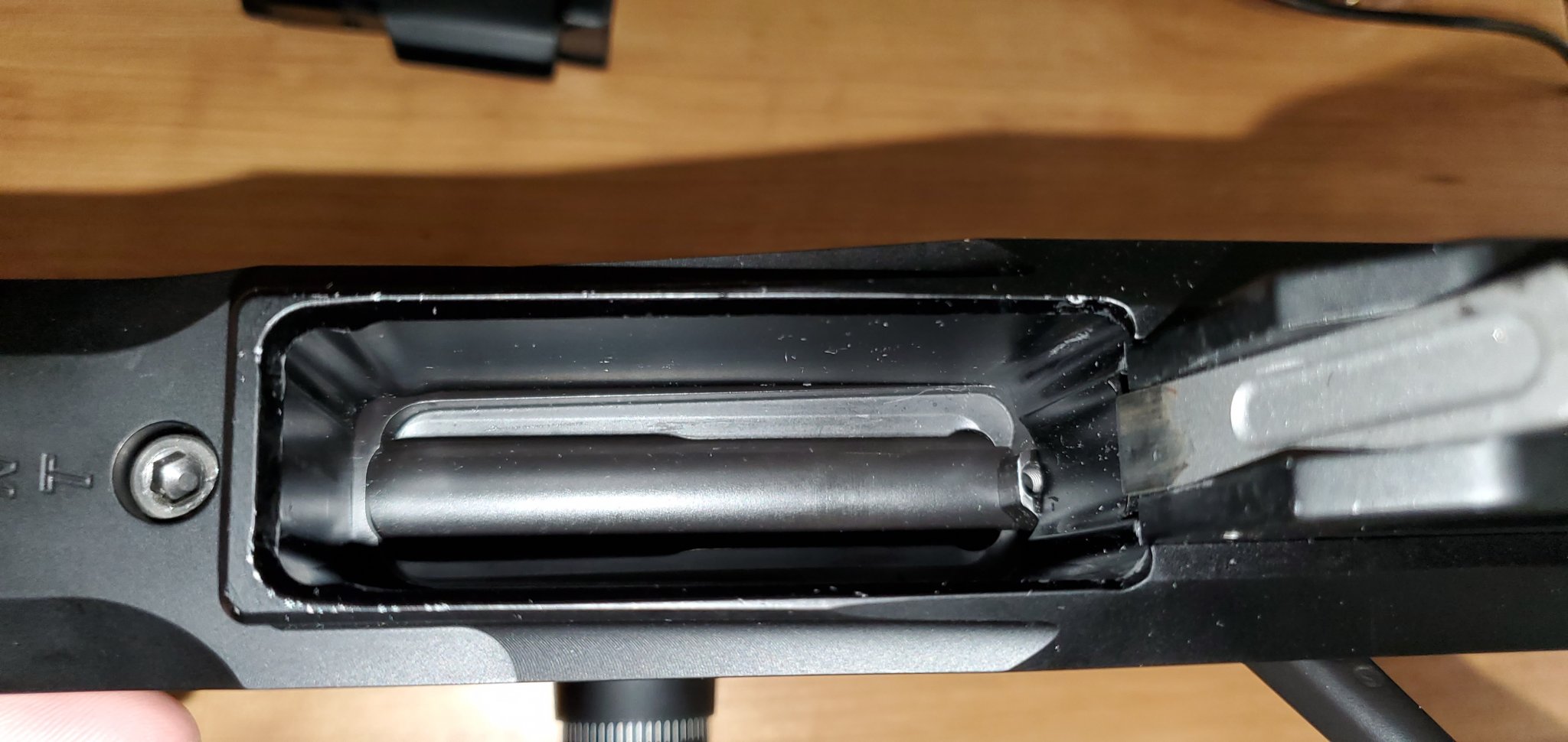

Sorry i left this post hanging with no details and i appreciate everyones input very much. Here are a couple pics, and yes, im not an idiot i took the metal mag box out lol. Also, truing the front of the action too much would move the bolt holes further ahead on a stock or chassis after the recoil lug is put in place, since that is where every bolt guns stopping point is and where measurements are based from. I couldn't get a great picture showing the rear action screw hole is in relation to the chassis. What i can tell you is my sps tactical was in this chassis and bolted in fine. Ive put this gen 2 5r in the factory sps stock and had troubles fitting in there as well. I sold the original hs precision stock and ended up chucking a drill but and slightly making the rear action screw hole on the xlr chassis larger to accommodate the issue I've got here.

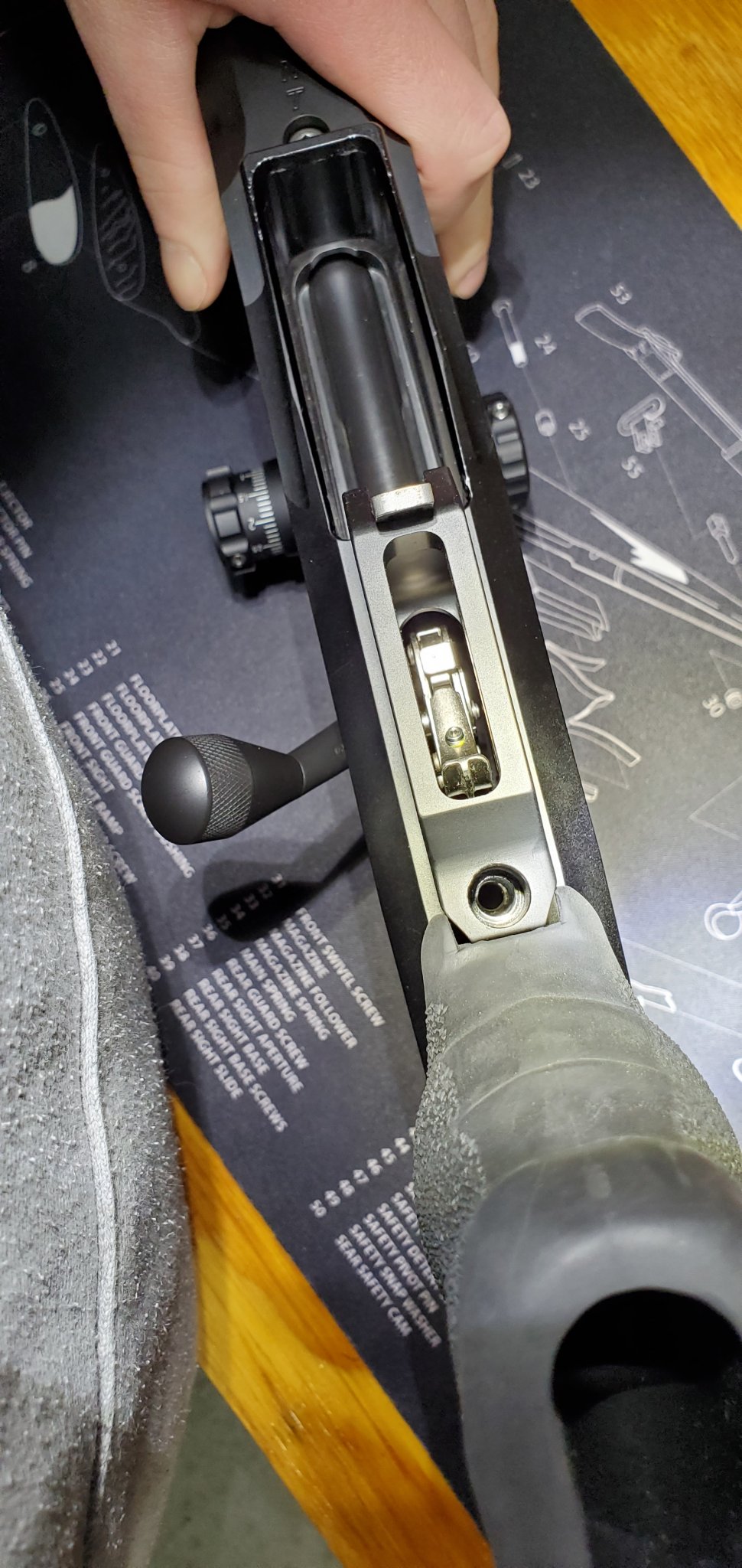

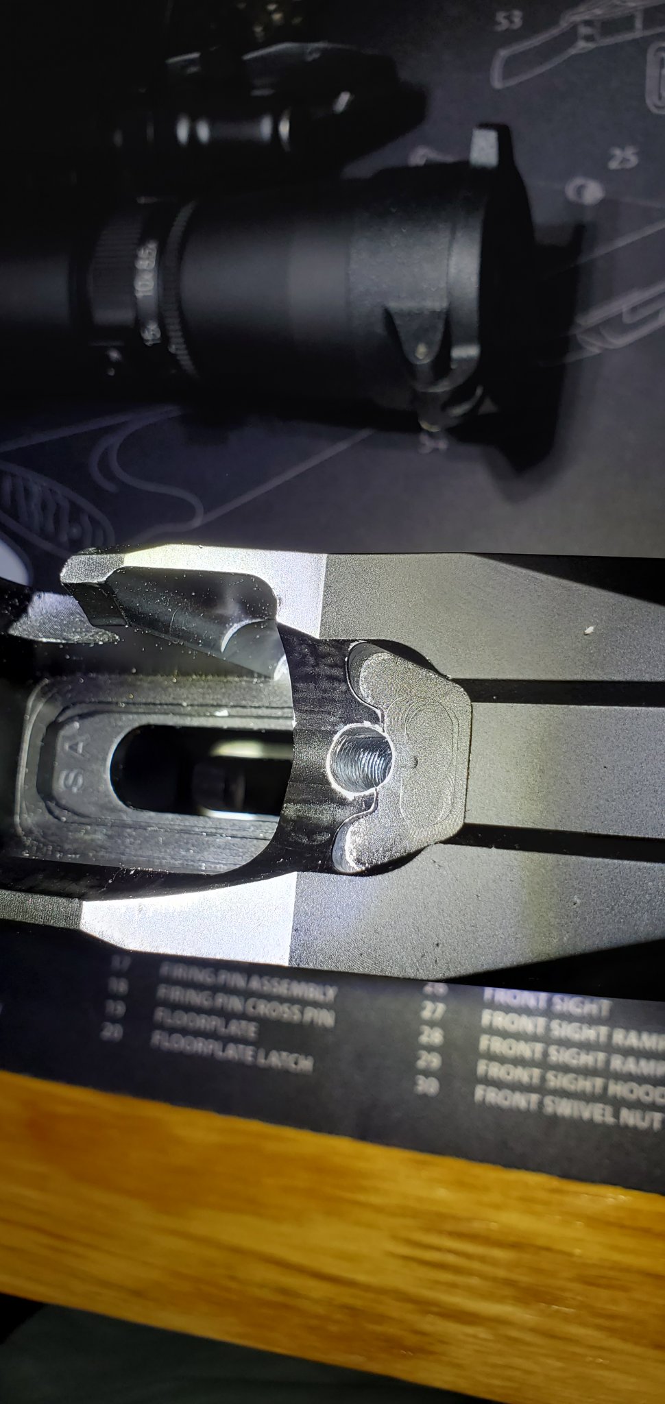

Heres a couple more pics of each rifle inside the chassis viewing through magwell. The little tab in the back is whats stopping the magazine from being inserted on the 5r. I believe that little tab is used for adl models.

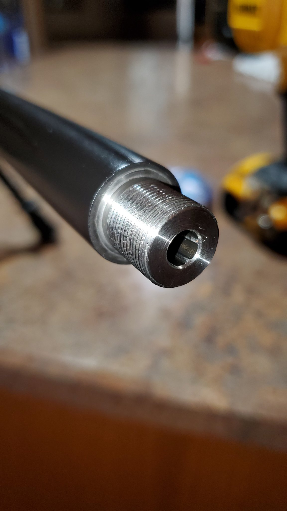

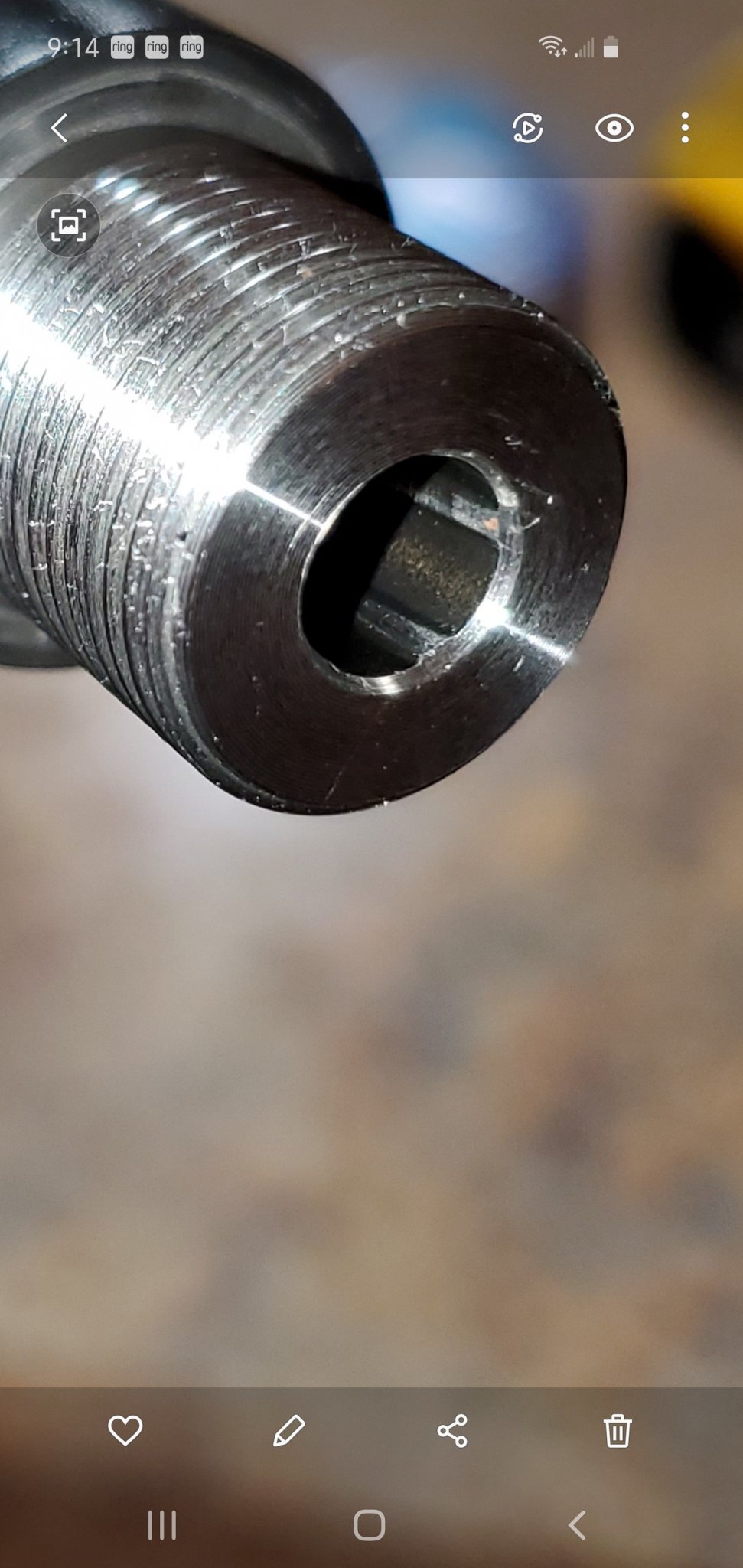

In my reply i was saying how no, the metal box wasnt in there, and i took a drill to the rear action screw hole. I mean you can see the screw still hits it just slightly on the way in, but i really dont think at this point its affecting accuracy. I wanted to shoot it in the chassis before i debated whether to send it back for the crown issue. Getting half moa with it, which is what my 308 rem700 shoots with handloads so i guess im done dicking with it for now. Still kinda bummed i cant get an accurate mag in it without grinding the rear of the mag but it's the price im paying for typical remington qc.
Sounds like your rifle was made after Remington informed their employees that they lost their insurance and retirement and Remington was belly up. They worked hard to mess your action and barrel up.
You can try to get someone at Remington to fix it but good luck with that. The fix isn’t that hard if you have a welder, mill and lathe. There’s a few real gunsmiths still in business but they aren’t cheap.
You obviously didn’t inspect the rifle before buying. You might not could have discovered the action screw in the store, but the muzzle was easy to see. I’m sure the action didn’t sit in the stock right so you should have seen it too. Live and learn, just inspect next time and don’t be afraid to tell the salesperson, no thanks or get another one this one is shit. Going forward The easiest thing to do is sell that pos. Shine it up, price it right, include targets with your sub .5 moa groups and see what happens. ‘‘Tis the season, Ho Ho Ho and all that good stuff.🎅🏻
