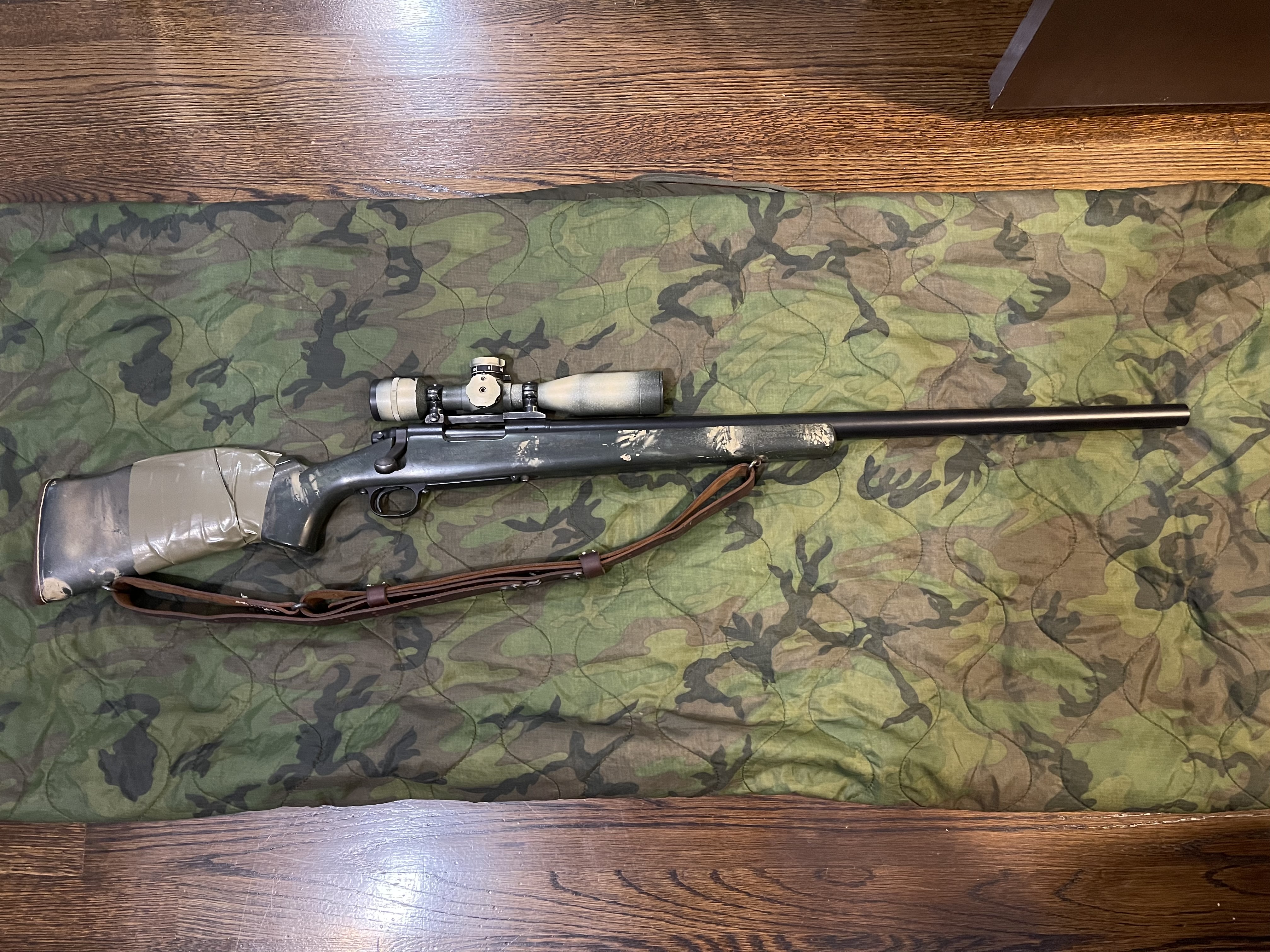

Little more retarded than normal…. I finally talked myself putting money down on an m40a1 clone from GAP. Unless I find the correct scope/base I am going to use a Leupold mark 4 hd4-18 scope as a place holder so I can shoot it/see what it can do.
I’m assuming the scope mounting holes are still using 6-48 screws.
I’m thinking just going with a badger base and rings but wanted to see what other suggestions are out there. Scope is big so I am worried about issues with base/screws.
