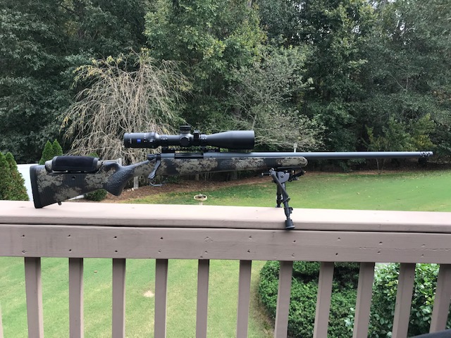

Here is a BART #4 finished at 24” in 7Rem Mag threaded 5/8-24.

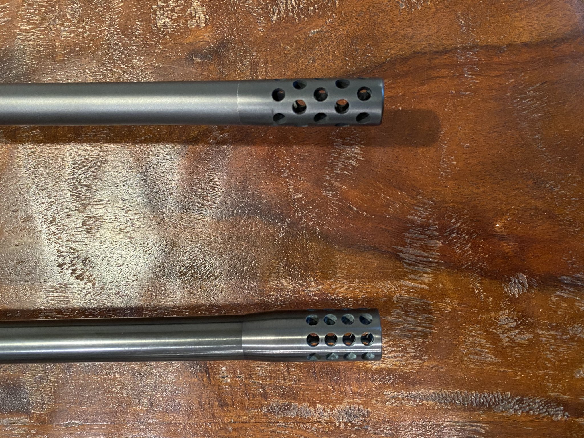

Top barrel is 0.645 at the muzzle. KDF brake, that has a very gradual taper to 0.685 at the tip. I don’t know what the barrel is threaded as it was not threaded when it was dropped off at KDF in Seguin.
Bottom barrel is 0.656 at the muzzle. Vais brake that swells to 0.745. The barrel is threaded 9/16-32, and wears a Vais brake because KDF would not do that thread on their brakes. I called Vais and gave them the specs. They shipped the brake to me in a couple of weeks.
Is one better than the other? I’m not sure, and it would be an unfair comparison. The top rifle is a 7mm rem mag and the bottom rifle is a 300 Weatherby mag. But, the recoil on the 7mag is very manageable, and the recoil on the 300 weatherby is... tolerable. I prefer the look of the hole spacing on the KDF brake.
Edit to add, both muzzle brakes are very effective at reducing recoil, but the 300 weatherby starts with a lot more than the 7mag. Radial brakes can be very effective, though they are not popular on this site. Below is a shot of my son shooting the braked 7mag...
OP,
Don’t know if you’ve ever handled a #4 Bart barrel before but they are in the neighborhood of a Rem Sendero in profile. They won’t fit some of the narrow forearm sporter stocks. It won’t make for a sleek hunting rifle.
I originally had this rifle in a McM HTG and felt it was too much barrel for that size forend.
You can kinda see how the barrel fills the forend of the HTG.
