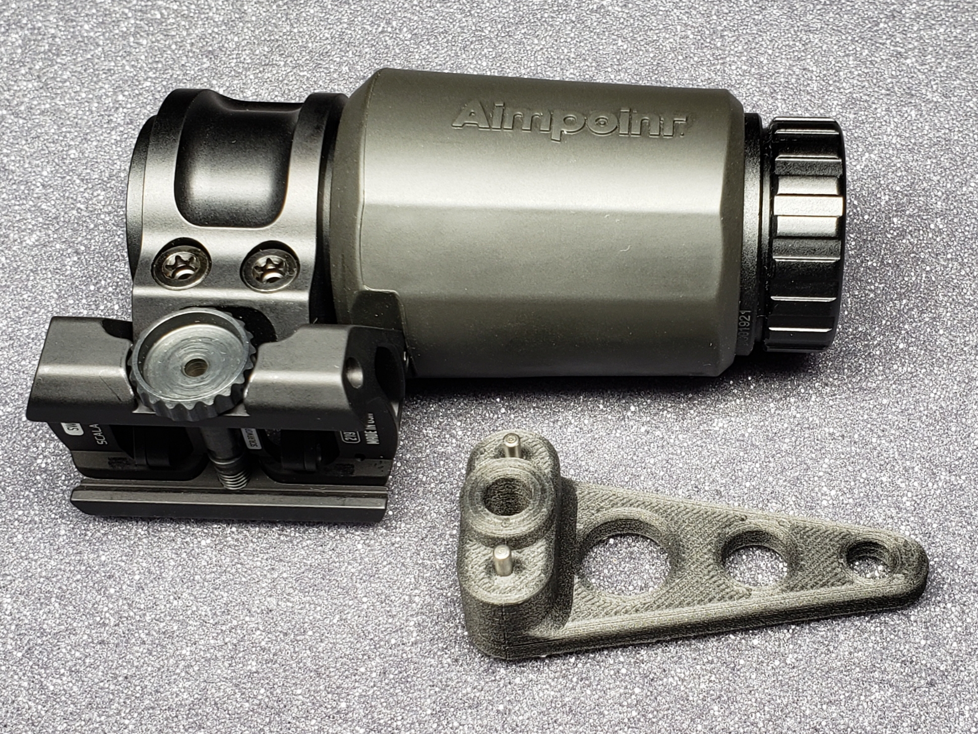

    Also has a tool for Scalarworks mounts called the click/nudge tool which makes tightening/removing those pain in the ass (fingers) tension wheels much easier. Lots of good stuff on his site. No affiliation, just glad he does what he does and the prices are reasonable.

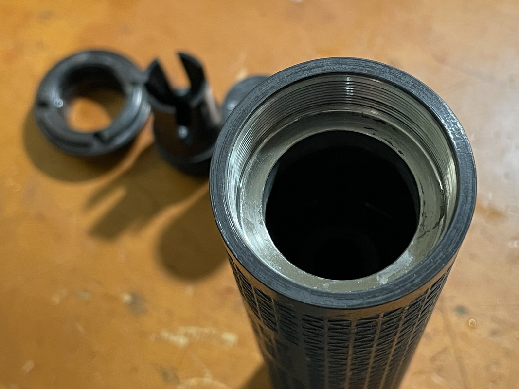

    The Suppressortools.com tools came in a day early. The ASR castle cap for cherry bomb socket did not work as the pins weren't spaced out far enough. The clamp did work and it held the suppressor snugly with no rotation. Went back to the standard armorer's wrench with no luck.
    Said f*ck it and hit it with some heat from a heat gun and then quenched it in water quickly. Put it back in and with one bow of the dead hammer it finally came off.
    I saw no evidence of Rocksett. WTF.
    Anyway...was happy to have it off so I could install the Huxwrx HUB mount and actually shoot through it. Unfortunately the Huxwrx has for lack of a better description, a cage which inserts into the back of the suppressor. I'm guessing this is for their Ventum line and really has no function on other suppressors.

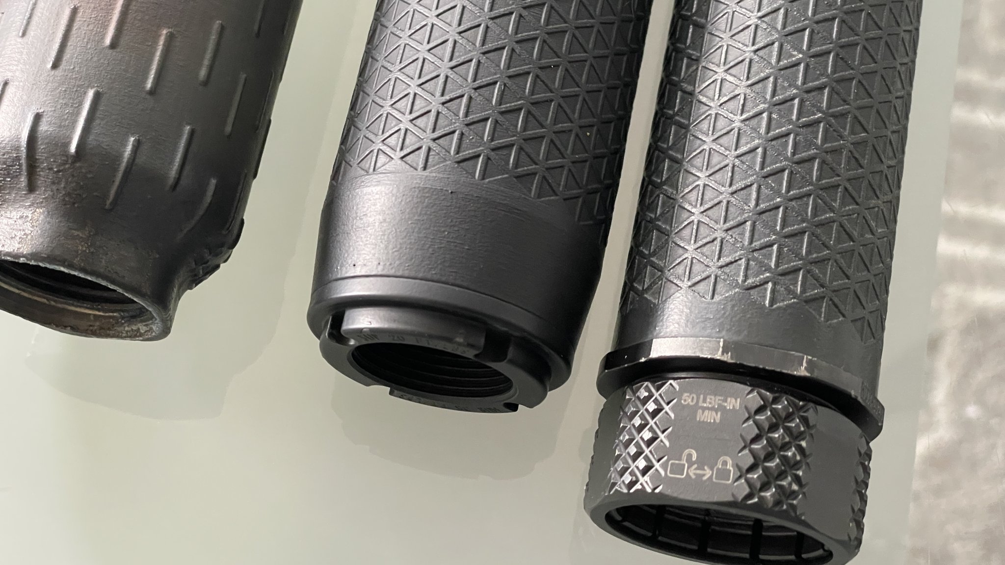

    Went to insert their HUB mount and there's a lip which prevents it from being inserted. Bang head. Can't make this stuff up. Works on two other suppressors.
    If you measure from the back of the last baffle to the back of the suppressor, it's spot-on at 2". The Huxwrx cage is just under 1.5" their and muzzle device does not extend past the cage. So I have more than half an inch of clearance between the front of the muzzle device and the last baffle. I am most likely going to just cut the cage off.
    The threaded portion on both the RD and Hux HUB adapters is almost exactly 1cm. The threaded portion on the suppressor body itself is longer than that. So the trueness comes from the back of the suppressor barrel and the face of the mount. It's not resting on that inner lip and relying on it to make sure the suppressor bore is concentric with the rifle bore. So if I cut off the cage and it's not perfectly flat it doesn't look like it'll hurt anything.
    Pics.
    I'm feeling impatient so I went ahead and cut the cage off. Super easy. Enough clearance that I didn't even need to grind the end perfectly flat. Now just waiting for my neighbor to cough up my .308 alignment rod. Eye sighting it through the bore looked good but it'd be stupid not to check.

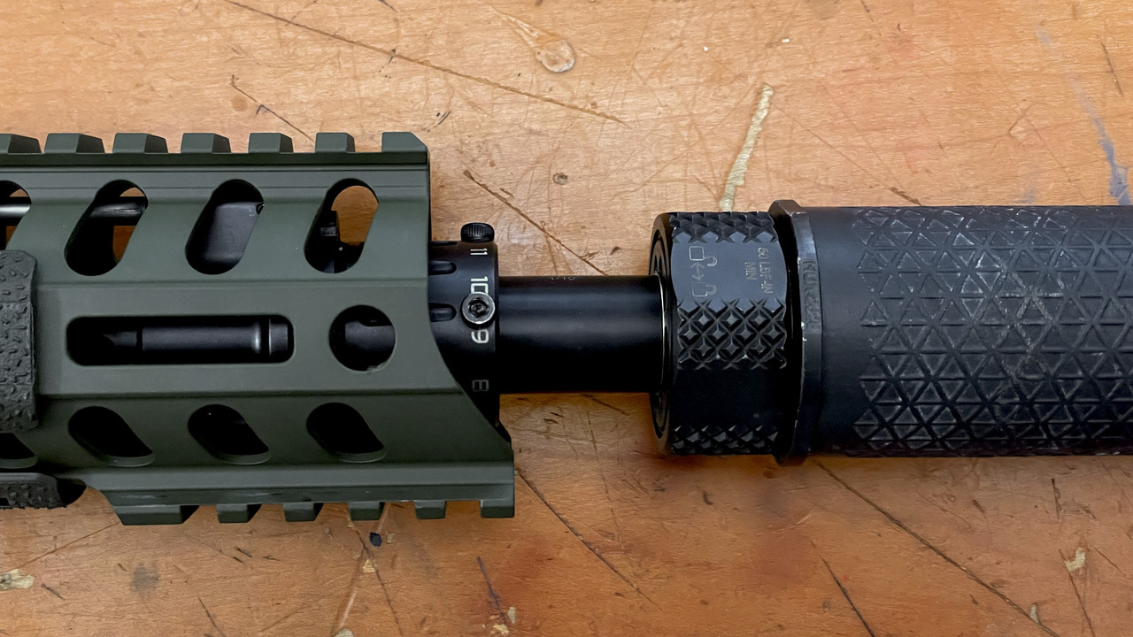

    All my rifles have adjustable gas blocks and I tested for function on each one, noting ejection pattern and whether or not the bolt locked back. On the 308, I have 12 settings (riflespeed) and the RD called for three to four clicks less gas than the Huxwrx depending on the round being used. I had some rather spicy Remington UMC 150 grain which was relatively cheap for 308 and I needed to break in the new barrel on that gun.
    On the 12.5" piston 5.56, I normally run the Sierra 5. It has a five setting gas block and I use the suppressed setting which locks the bolt back on an empty mag with pretty much every round I've put through it. With the RD, I had to go to the unsuppressed "normal" setting. This produced an ejection pattern between 2-3 o'clock with PMC X-Tac which was registering about 2700+ FPS.
    On the 300 blackout, it's a two-position gas block on a piston setup. I run the suppressed setting all the time and it cycles everything and locks the bolt back on an empty mag. So no changes with it. With supers, there is a difference between the RD and Huxwrx but it's hard to tell from behind the gun. I give the nod to the RD however. Using ear pro with subs, the Huxwrx is a tad louder/deeper. I did pull my left ear for a shot through each and honestly, the action was far more loud than the report. The ear pro likely filters out the higher frequencies and I'd really need to be a spectator to assess the ultimate difference.

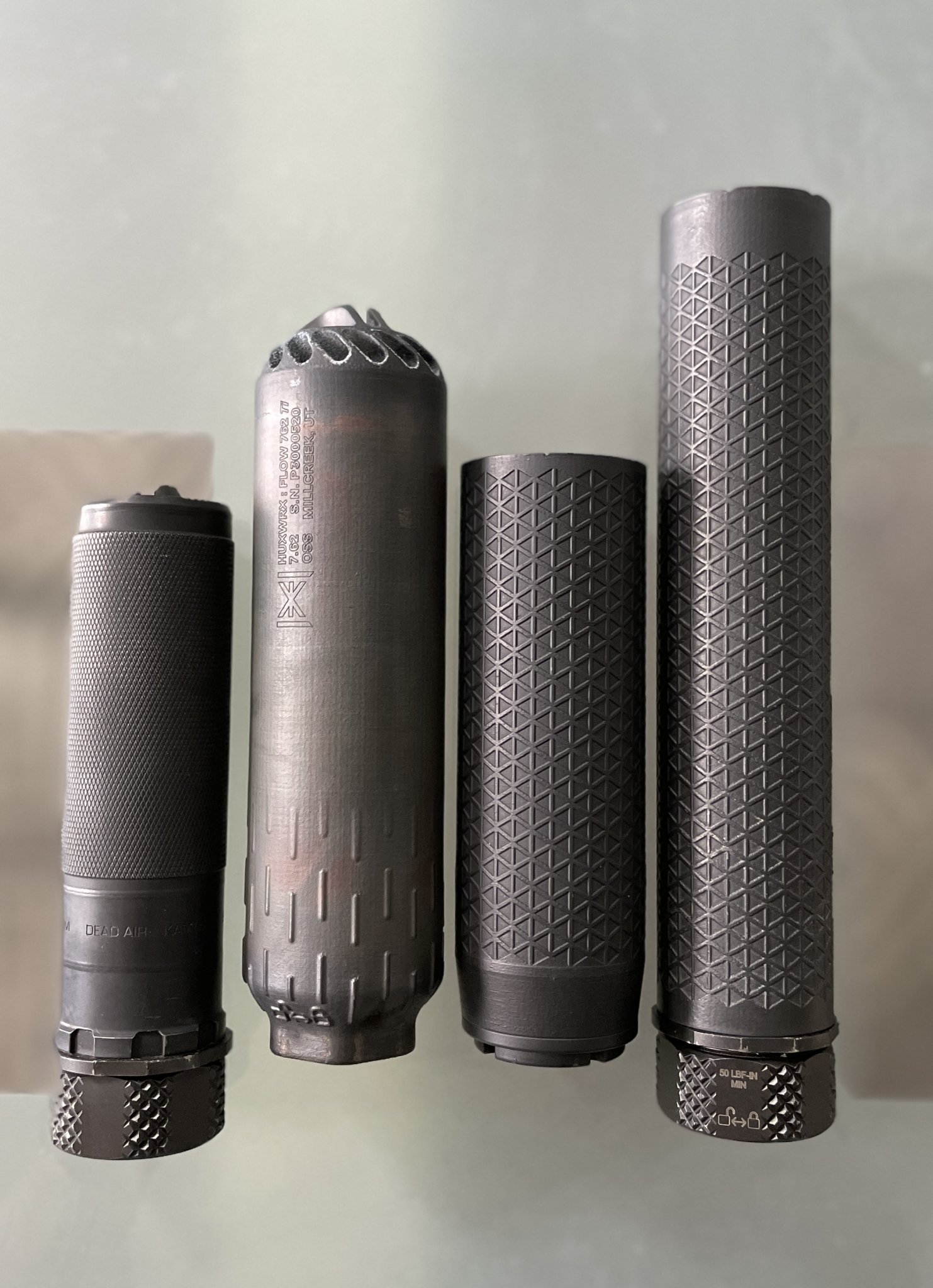

    My Radical Defense CS3 arrived yesterday. She's a chunky monkey, bout five inches long with a width of 1.74". It's tapered at the muzzle end unlike the LS3. Same everything else, this one is in Haynes 282 (nickel based alloy with lots of cobalt) so it's hard use mag dump capable and shouldn't suffer erosion like a Ti can.
    Weight came in at 18oz. with their mounting device.
    Here's a comparison, left to right, Sierra5, Flow 762Ti, CS3 and RD LS3 Ti. I have a QD mount on the Sierra and LS3 so I lined them up by the base of the suppressor to highlight the different lengths. The Sierra and CS3 are equal in length but the CS3 has a larger diameter. Assuming the CS5 (5.56) is the same length and width, it'd be a good alternative, with far lower back pressure, than the Sierra5, while being substantially quieter. I always felt the Flow 762 was fairly compact but the CS3 makes it look long and cumbersome.
    I had a chance, as a spectator, to listen to both the Flow 762 and Sierra5, Flow on my 12.5" and the Sierra on a 16", and the Flow was notably better in the sound department. Huxwrx has the new Flow 556 Ti which is longer than the stainless version. Will be interesting to see how the new, longer 5.56 compares to the 762.
    Anxious to see how this'll do on the 300 blackout with subs. The Ti version of the CS3 is quite light and it's heat-related performance parameters would be well within the acceptable range with subs.
