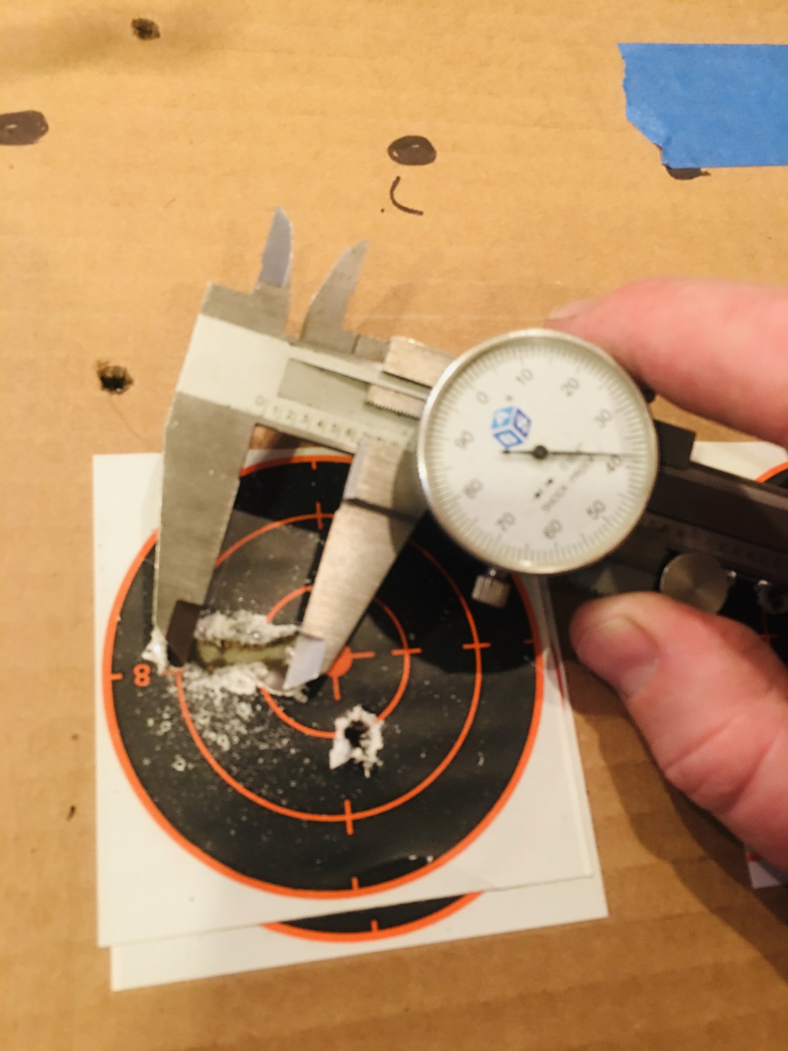

    The photo below was the one with I believe 55 or 40 grain varmint rounds. All of the ammunition I shot was High grade reloads on my Dillon 650xl.
    These were done with a mix of different cases 223 rem and some more 556 Federal.
    i’ll try next with some 69 grain Sierra‘s and some 68 grain Hornady with some Starline brass.

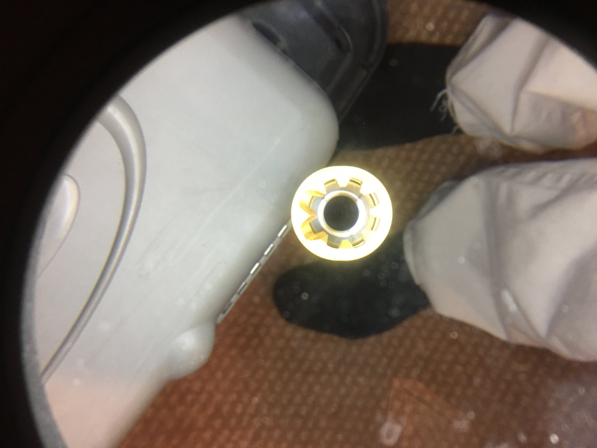

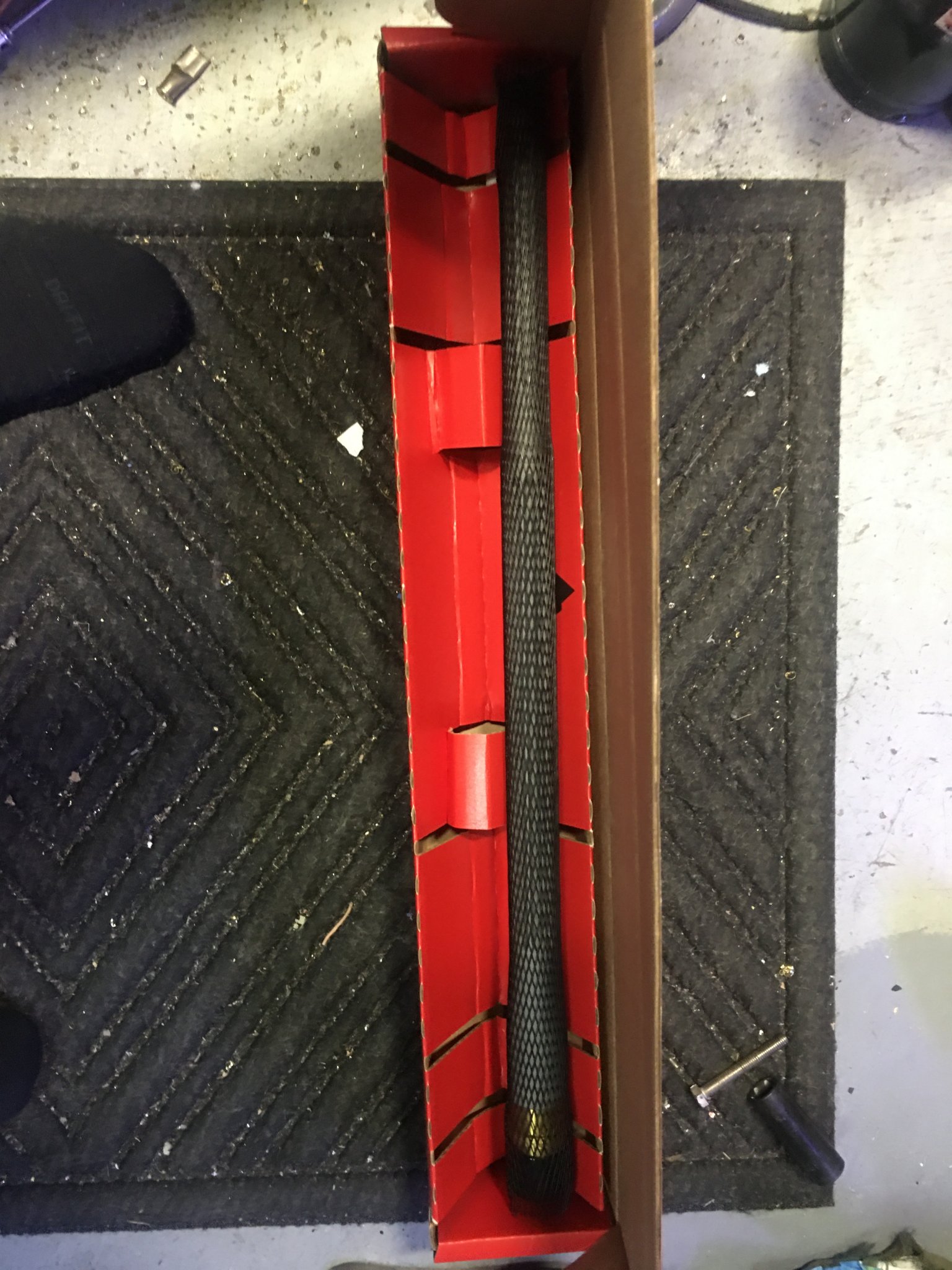

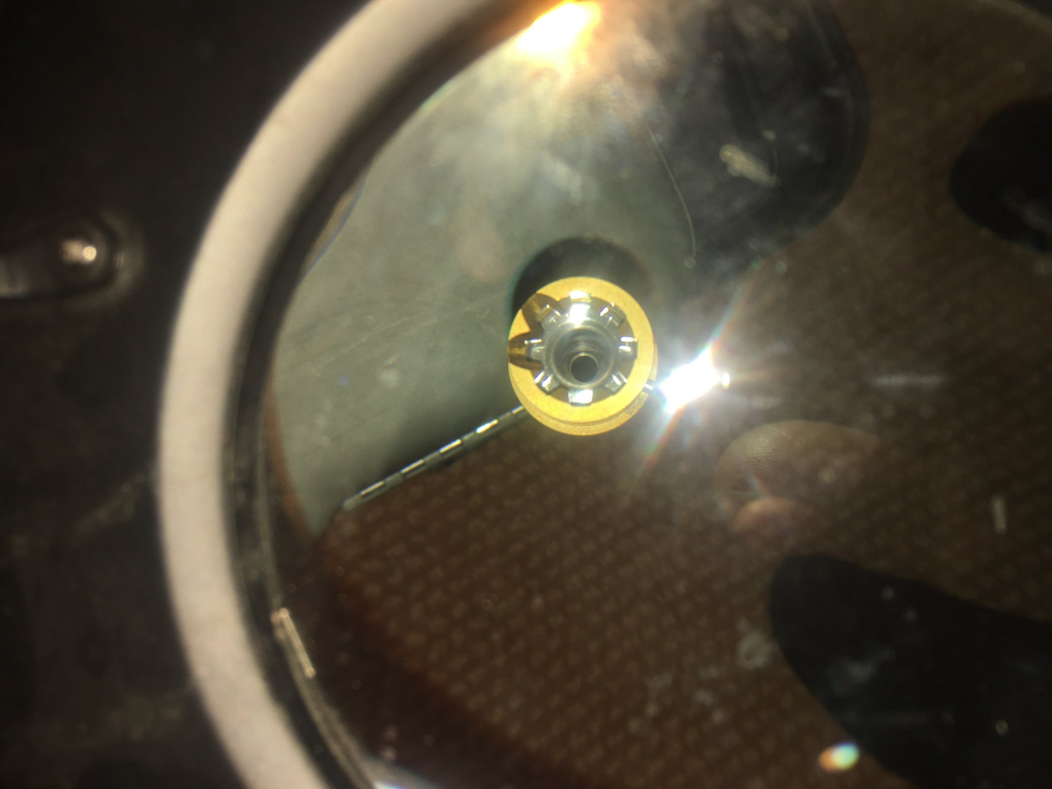

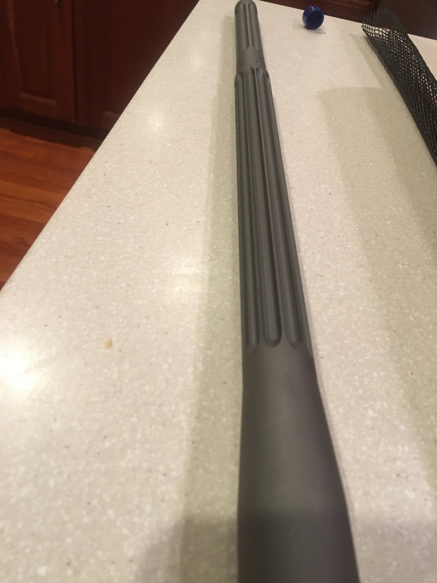

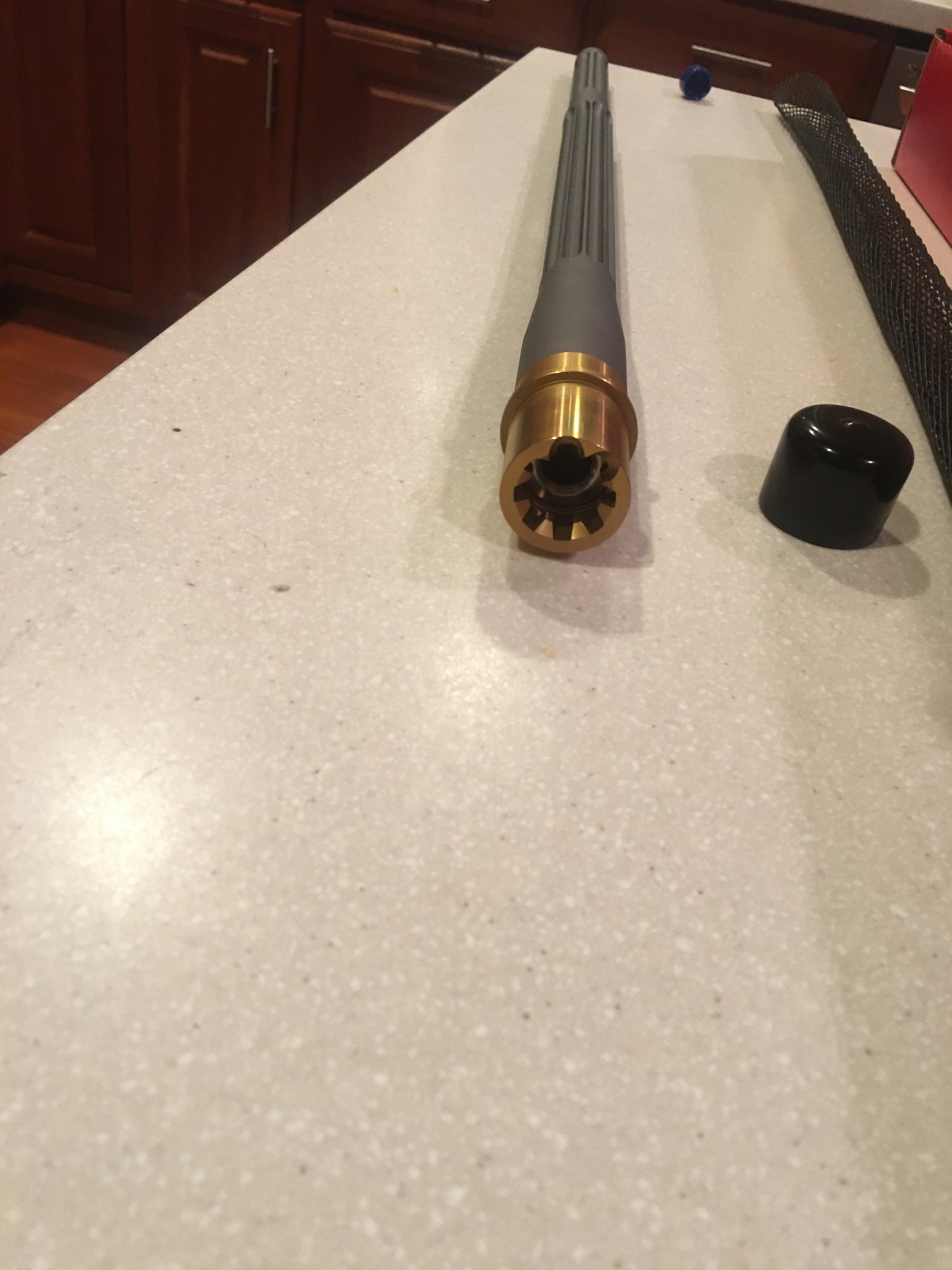

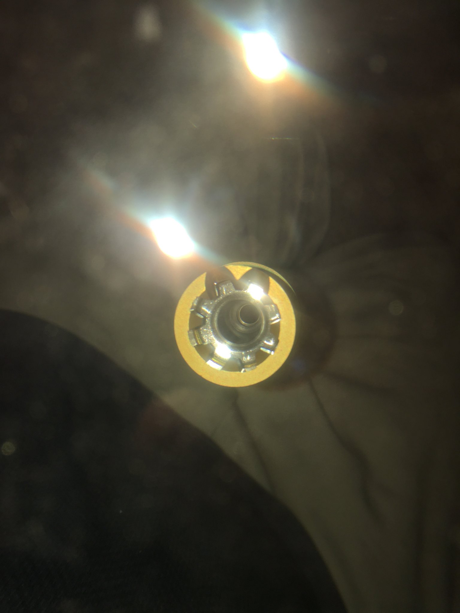

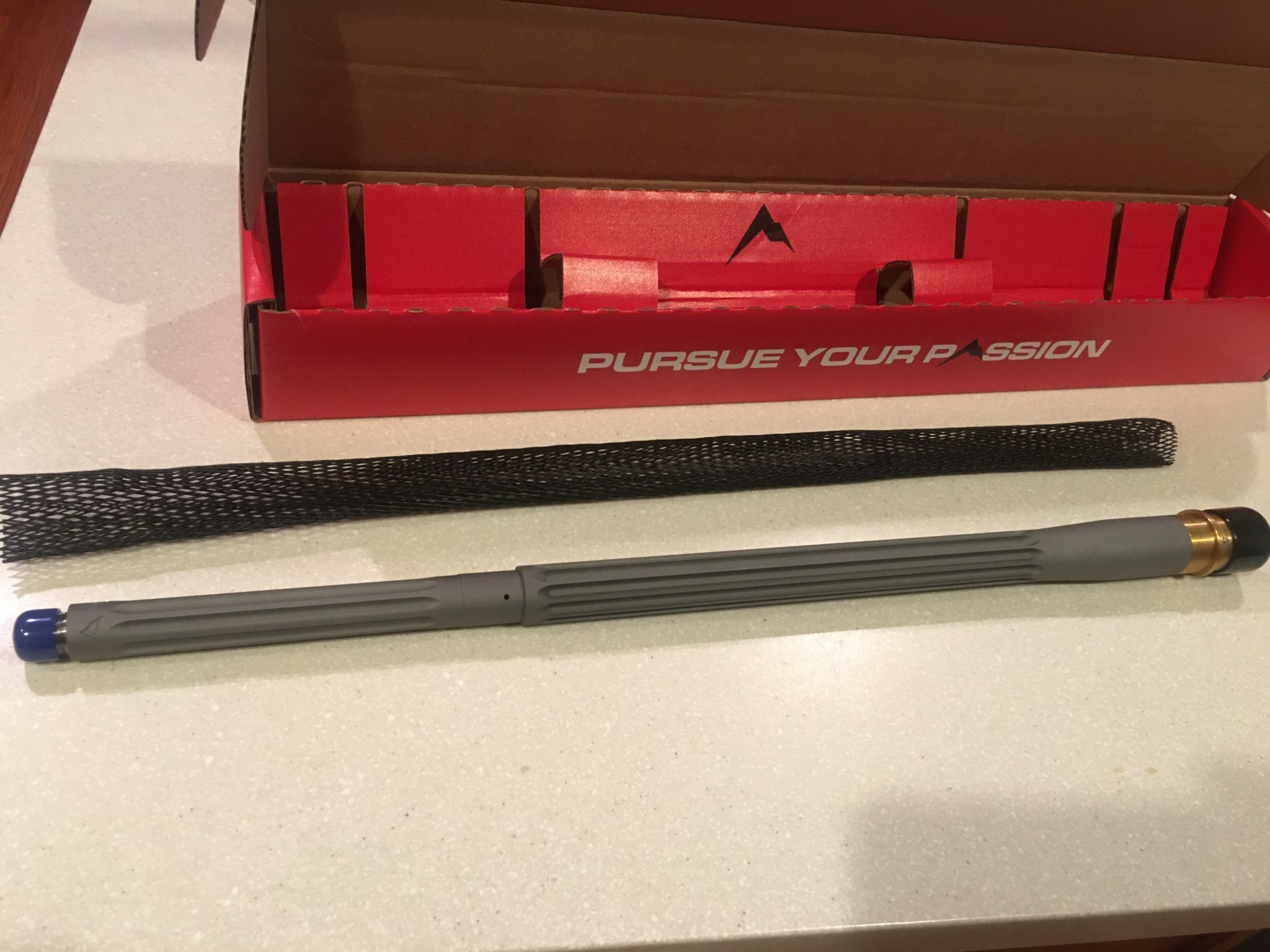

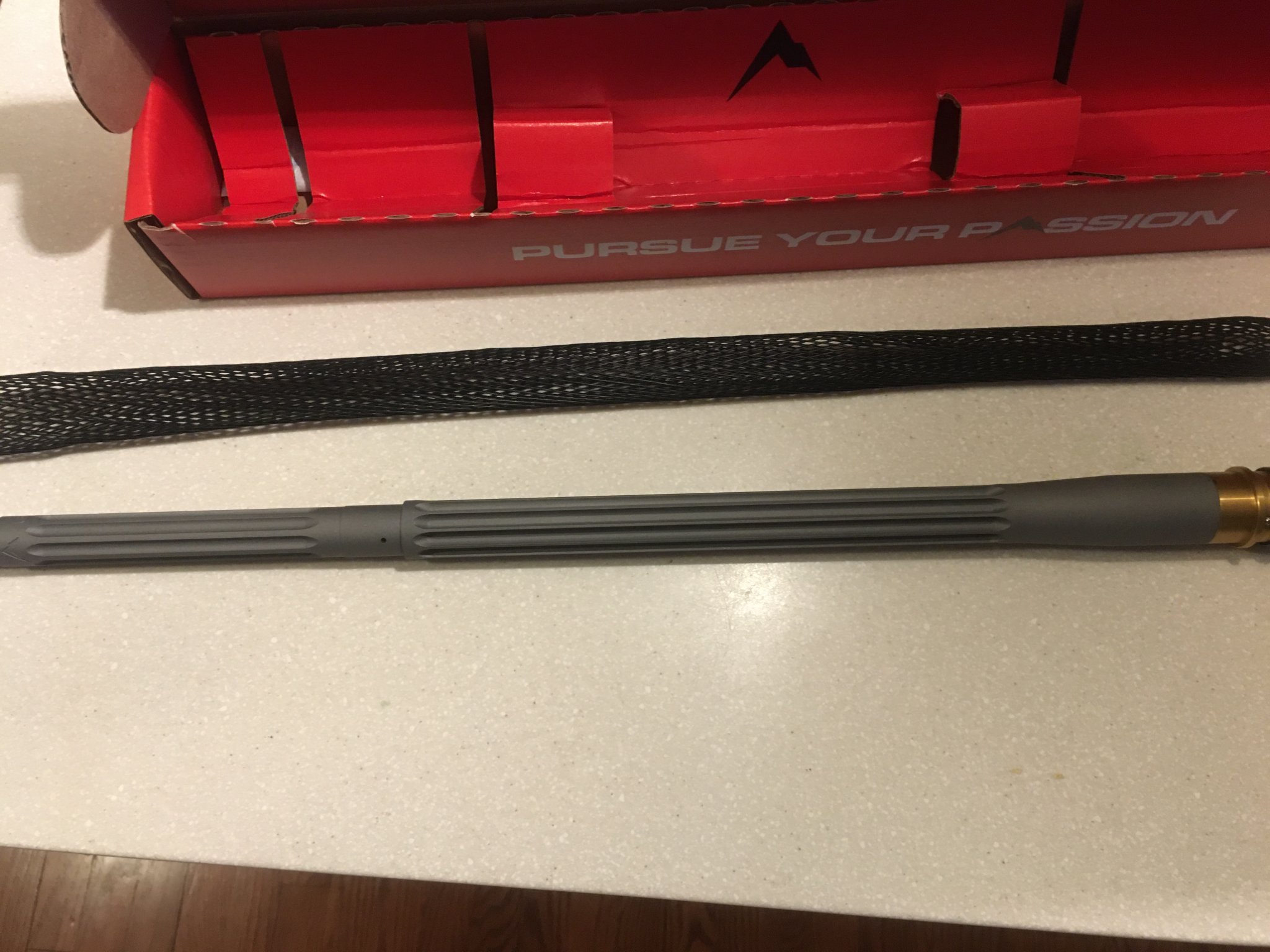

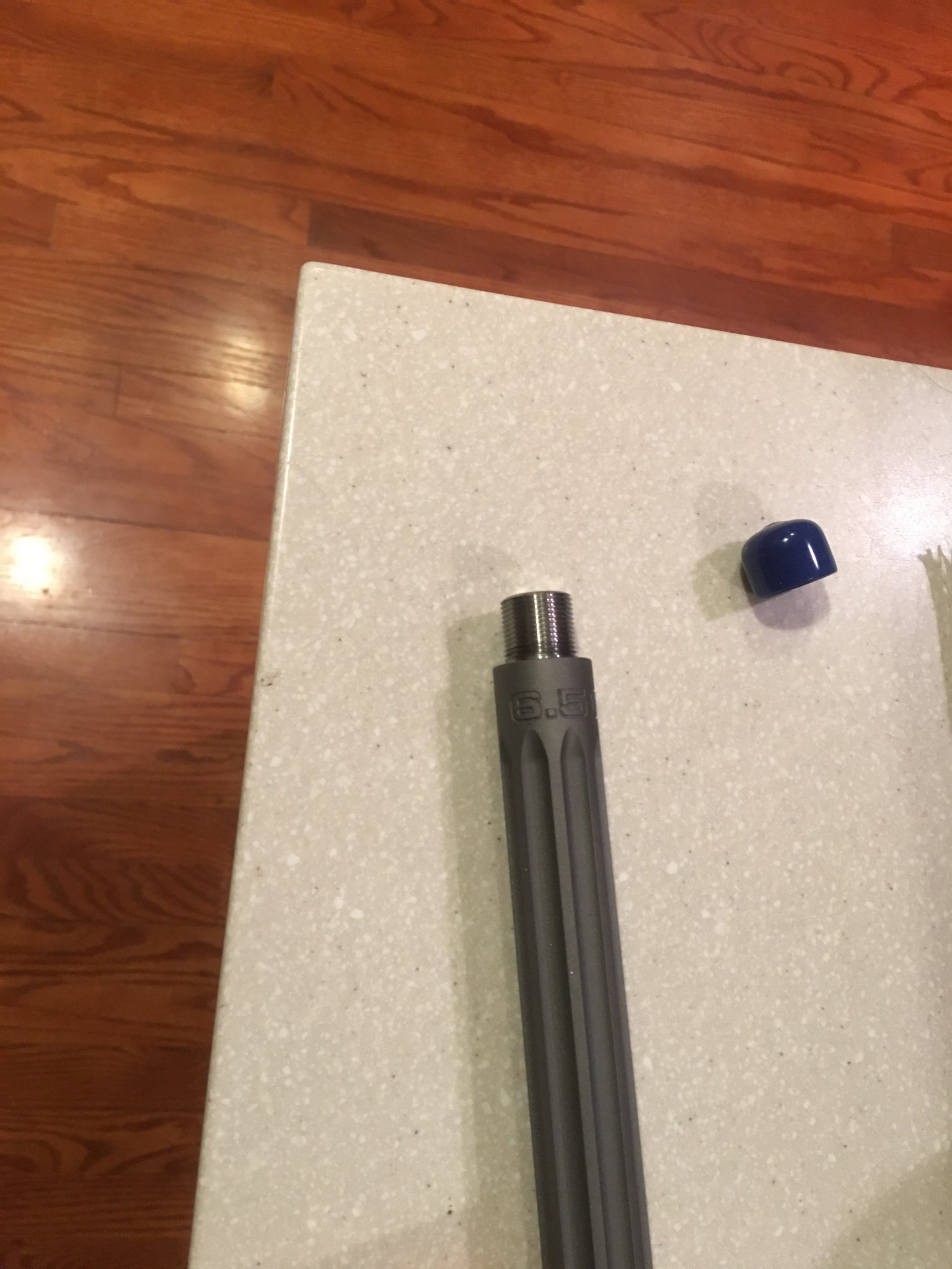

    Here are some photos of the barrel
    This is the 6.5 Creedmoor mod2 it is a sharp looking barrel to say the least and unfortunately my second time and in a different caliber, different time frame,the barrel pin and the extension was pushed in side ways... just enough to not seat properly.
    These Ar15 and AR10’s can’t have extension barrel pin off-center, as otherwise they will not work with these upper receivers. Things are just too tight in that area.
    And this is not to knock them it’s just a review of what I’ve ran into so others know what to expect but I do expect the same great level of customer service to take care of this issue rather quickly and hopefully I’ll have something up this week with results.

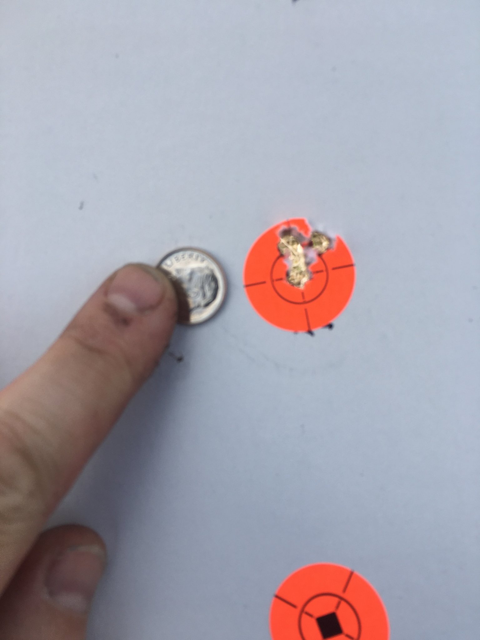

    have been shooting for a bit and took up some p-dog hunting so apologize for no updates:
    Rainier arm stood by there products
    They had an issue with the barrel extensions and they got them sorted
    They allowed me to return the 6.5 creedmoor until I wanted to try a barrel again, I did and went with a 22creedmoor match barrel
    24” and 1/8 twist I believe or 1/7.
    At fist I had some load development issues until I could actually get hold of powder that was correct burn rate. Imr 4350 and sw4350 are the ticket have some 6.5 star ball to try next.
    60grain vmax 41 grn imr 4350 3400ftps
    10shot continual group. And 1 flyer.
    I would say that most would be happy with this at 100 yards, I know I am.
    Will continue to develop and keep shooting.
