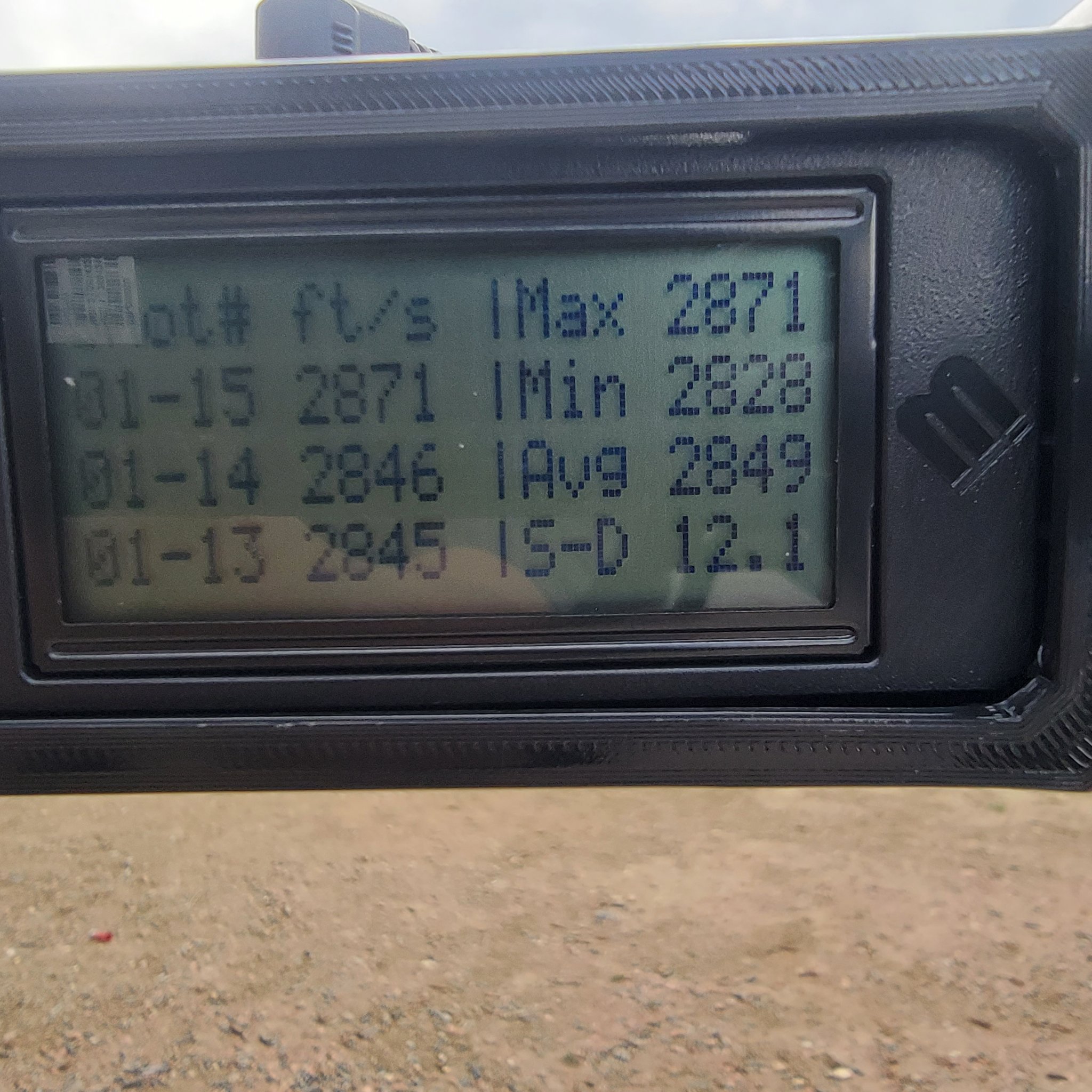

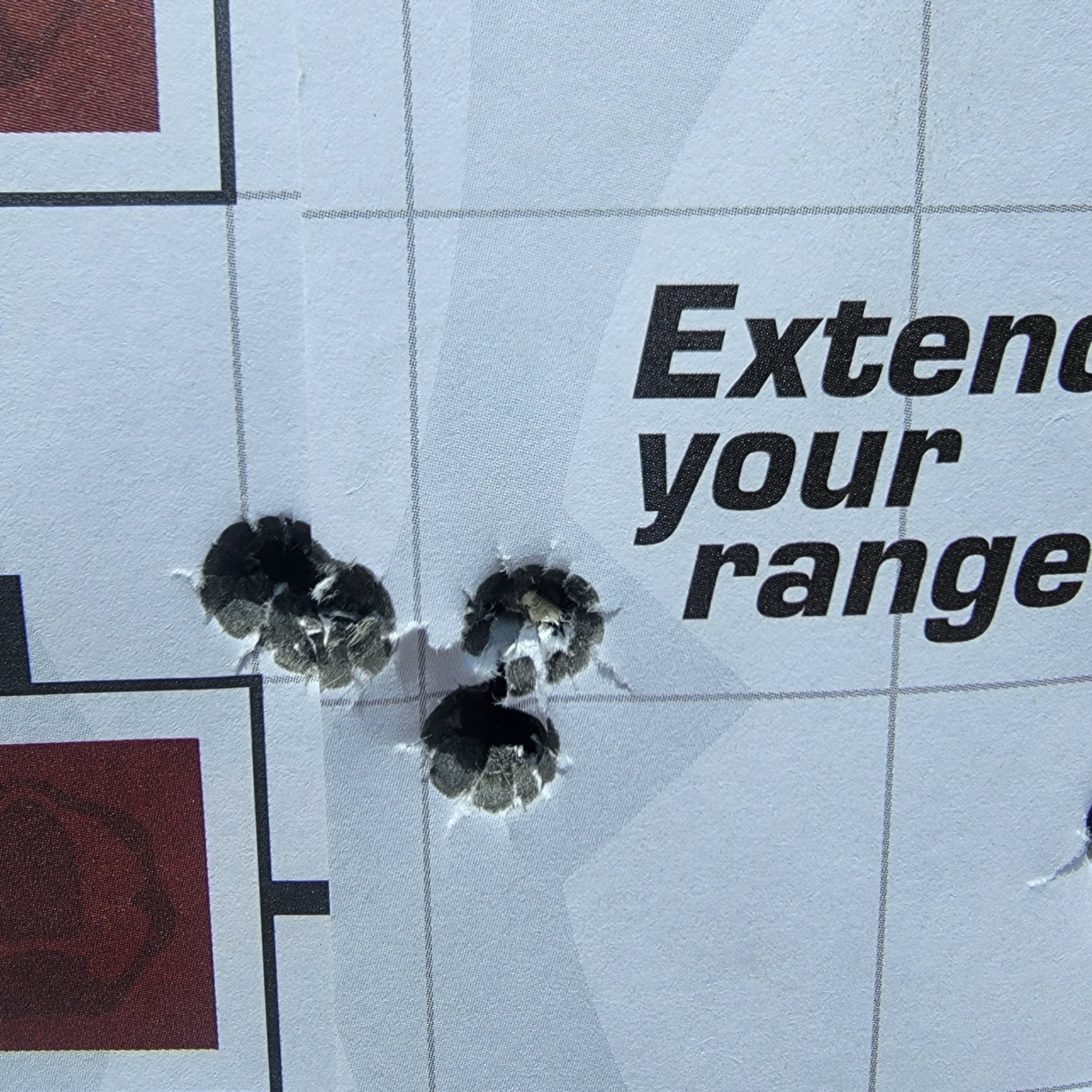

I just tested lrt and had some pretty good results good accuracy not top notch but good. Sd in sigle digits 6.8 for 8 shots up to 15 shots in a row it got a little bigger 12. Shot from 50 degrees to a top of 82 and never seen any crazy temp sensitivity. 30 nosler 250 a-tip 2849 avg speed.
Decent results so far
