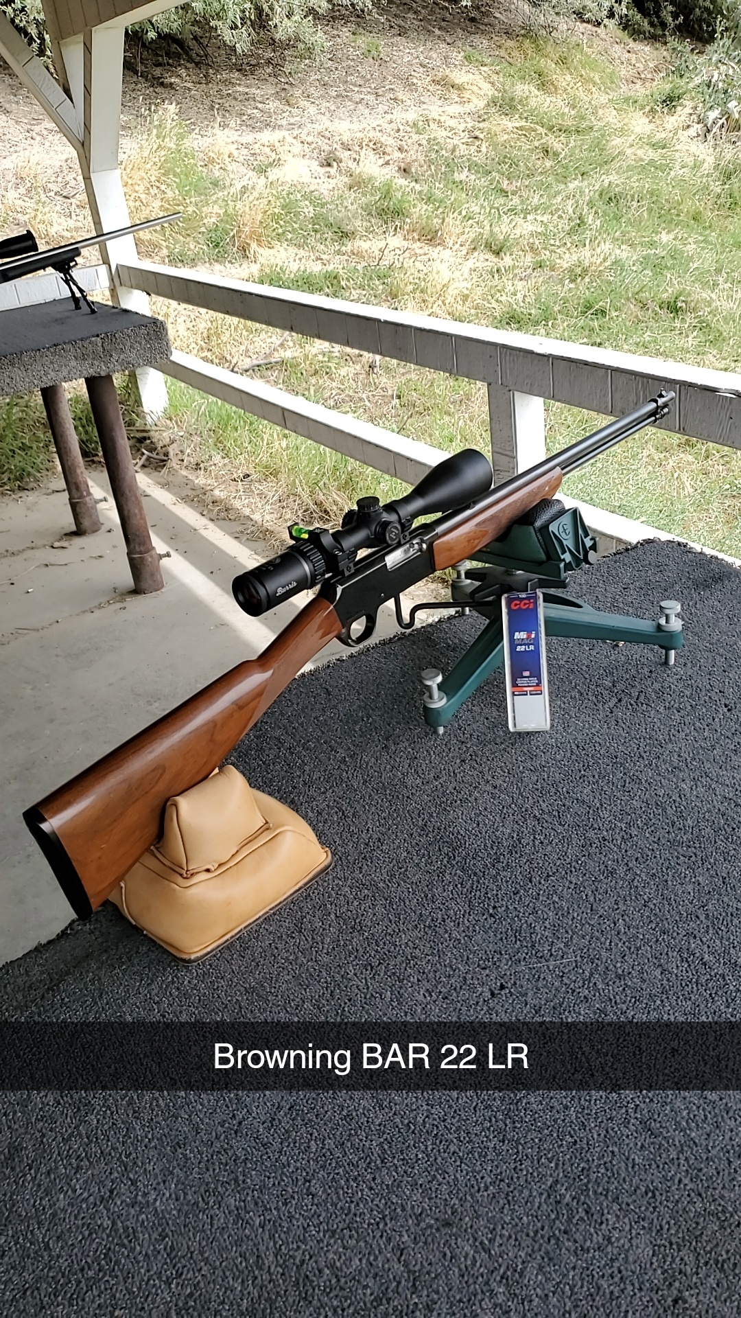

I'm not sure I've ever had this happen while trying to sight in any rifle in 30 years, but I ran out of upwards elevation trying to get this Browning BAR 22 zeroed at 50 yards. I'm topped out on the elevation turret and still 2-3" low from center. Not good...
I'm using a set of Warne medium height 22 rings and a Burris Fullfield E1 4-14x scope. Scope has 60 MOA of elevation and reticle was centered. The Browning has a grooved receiver. Quality rings and scope, everything is tight and set up properly.
So what gives?

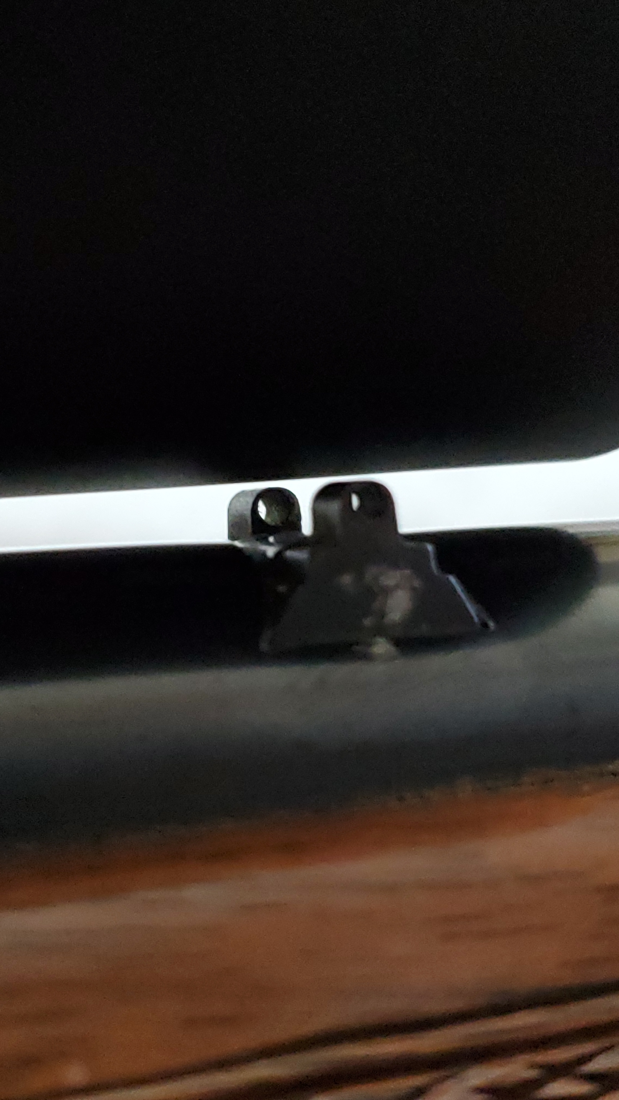

Mind uploading a picture from the side, particularly the objective end near the rear sight.
You won't see it as it is .030" and inside a scope ring.
You are likely misunderstanding what I asked.
The picture gives the impression the objective may be contacting the rear sight. Another picture from the side and not above showing the gap or lack there of in that area is what I was wondering about.

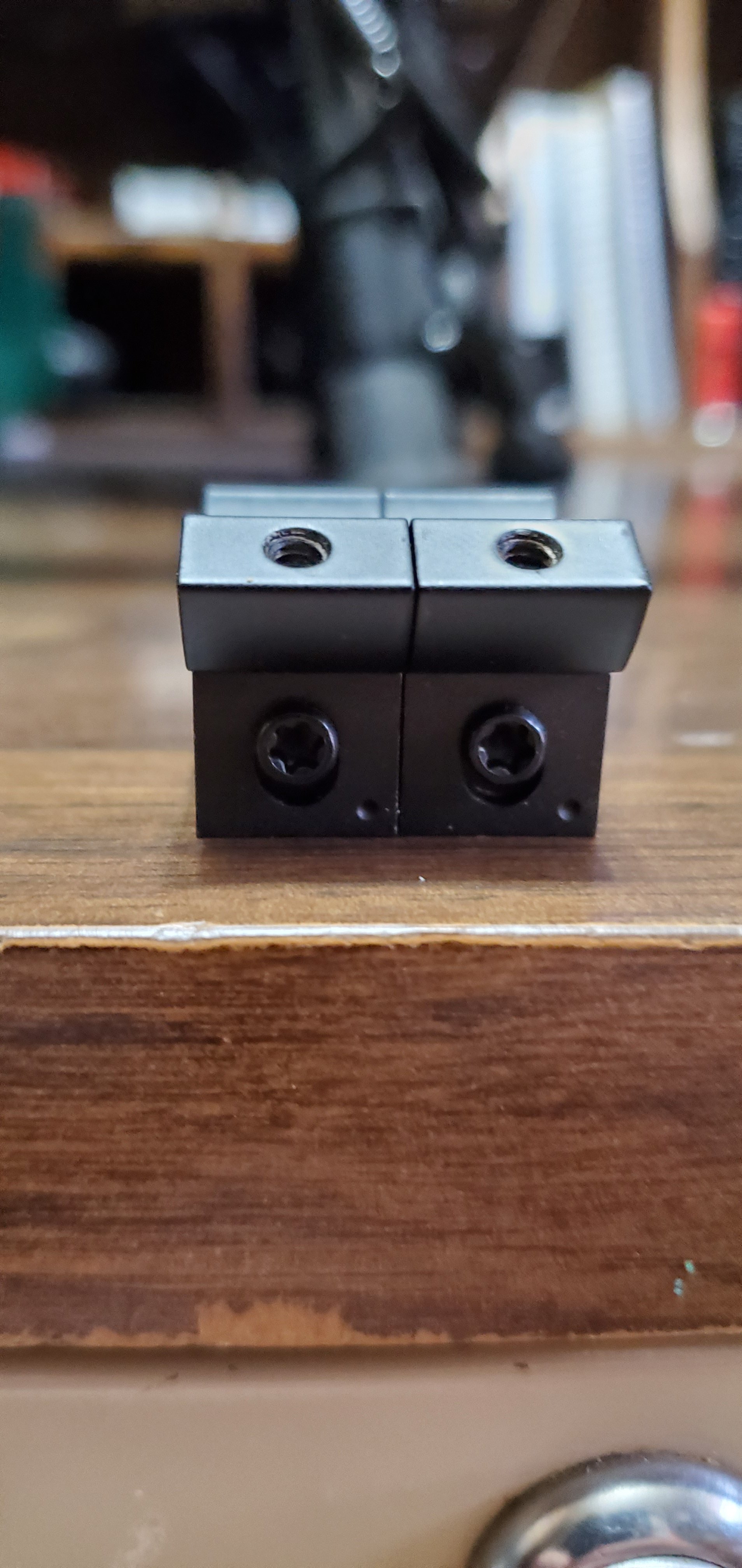

I noticed those small dots or dimples. I don't have the original packaging for the rings, but I thought they recommend them to be on the bottom, is that correct? The rings are suppose to be good for both either way I thought.
Also not sure if the Browning is an 11mm or 3/8" dovetail. There isn't a ton of info on these rifles. The manual doesn't specify either.
The rifle is nice, but it's almost more hassle than it's worth haha.
Bottom position is 11mm top is 3/8", allegedly the BAR is an 11mm but I'd take a set of calipers and measure it myself.
It is 11mm and measures .433" The clamps are in the right position as indicated by the index dimple mark on the bottom lower right.
For 3/8" you would flip the clamps around so that the dimples would be on the top upper left corner.

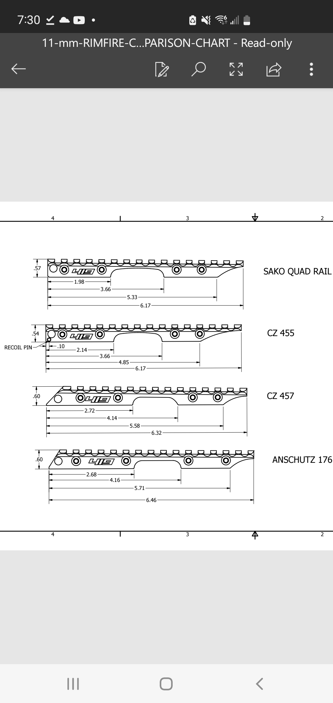

Would any of the Area419 rails work? I emailed them and they sent me the specs on 4 of their rails. They dont make one specifically for the BAR, however I don't see why maybe one of these wouldn't work. I have one on my CZ457 and it's been good.
I guess if they fit your receiver’s dovetail, the only thing I’d be worried about is recoil-induced slippage. Use some nail polish as a witness mark and keep an eye on it.
