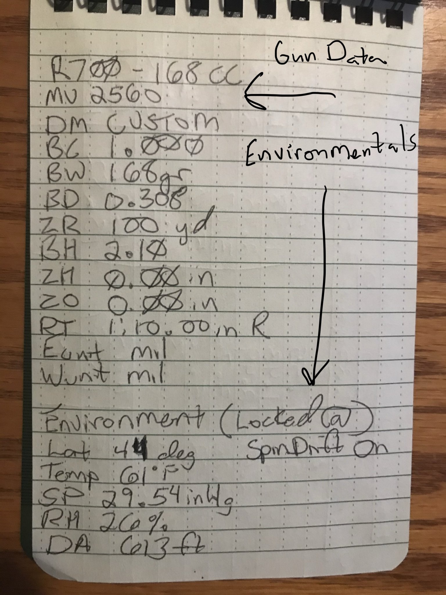

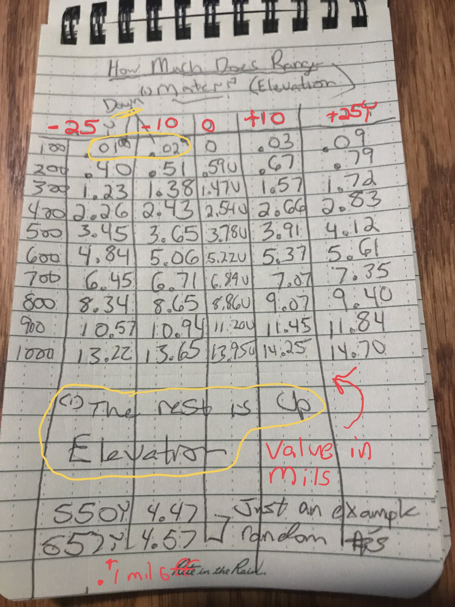

U USMC22 Major Hide Member Full Member Minuteman Supporter Feb 10, 2017 1,869 526 New Hampshire Oct 5, 2020 #1 Oct 5, 2020 #1 Another kestrel project today. Figured I’d share. Just checking what the affect would be if I measure range incorrectly. Attachments 1554435B-A0B8-4A63-97BC-17EA98A170F2.jpeg 506.4 KB · Views: 103 9739DDE8-1846-4513-B9D3-20285755D2D5.jpeg 420.5 KB · Views: 92 Reactions: Rokfor2K
ShtrRdy Gunny Sergeant Full Member Minuteman Sep 17, 2011 3,141 941 High Plains Oct 6, 2020 #2 Oct 6, 2020 #2 Did you intend on setting BC = 1.0?
D Dthomas3523 Account no longer active Supporter Commercial Supporter Full Member Minuteman Jan 31, 2018 10,739 15,793 South Texas Oct 7, 2020 #3 Oct 7, 2020 #3 ShtrRdy said: Did you intend on setting BC = 1.0? Click to expand... Probably running the custom drag
U USMC22 Major Hide Member Full Member Minuteman Supporter Feb 10, 2017 1,869 526 New Hampshire Oct 7, 2020 #4 Oct 7, 2020 #4 @ShtrRdy - @Dthomas3523 is correct. I’m running a custom drag. When you do that it turns the BC to 1. Reactions: ShtrRdy
