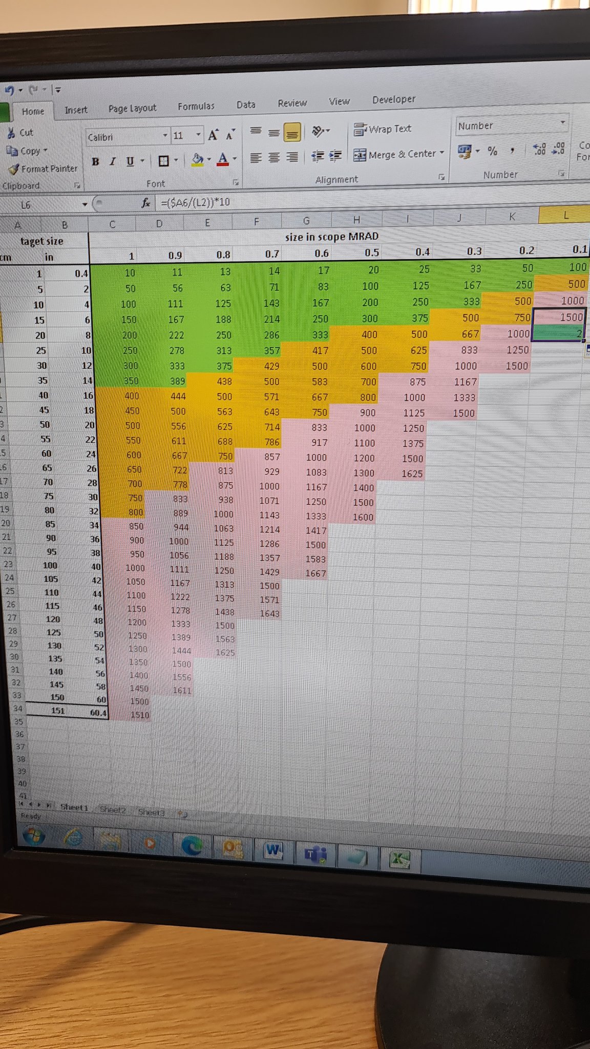

Howdy all, I wanted to be able to estimate ranges better, but don't have an LRF. I find myself thinking in knots when I have to make adjustments on fly so I am trying to make cheat sheets up front.
I made the attached for estimating range looking at known target sizes through my MIL FFP scope. Any interest in a higher res and/or MOA version?

I use Kestrel range estimation feature.
But for competitions not allowing electronics I have been recommended this:
I think you could print your own. It works like a charm, I got to try one.
Oh that's cool - works on the same principle but executed better!
@oldiephrt I'll do the this tomorrow. I'll drop you a line when I have it
