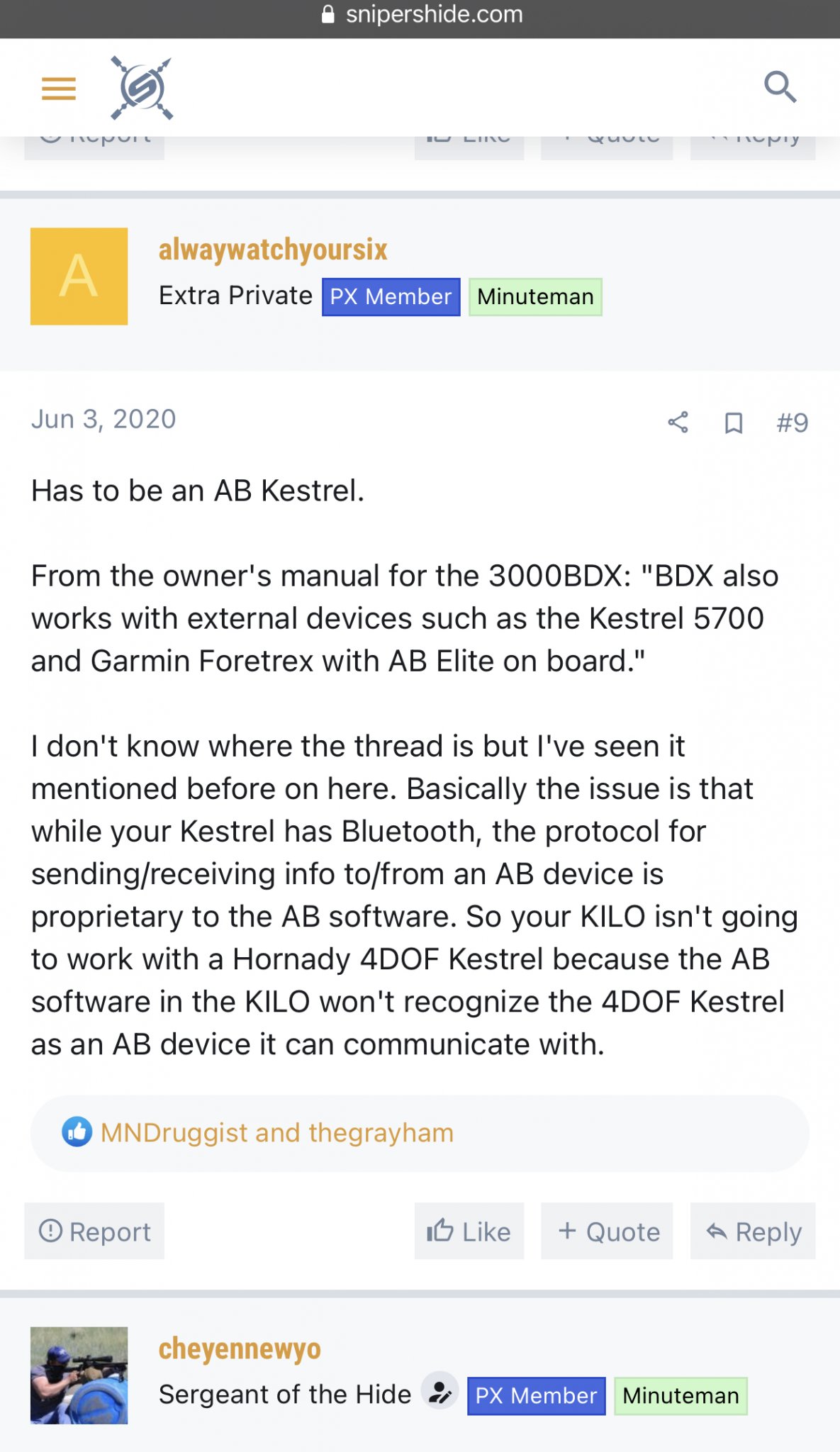

I find the Binos to be a lot easier to spot and laze your intended target, especially as you get further away or the target gets smaller. I have the entry level Leicas and think they are a pretty good value.

Best value are the Sigs which can be found in black for around $800. It will talk to the Kestrel EXCEPT the Hornady version. The ranging is spectacular, coming from a Leica mono owner, and the glass is good to very good.
