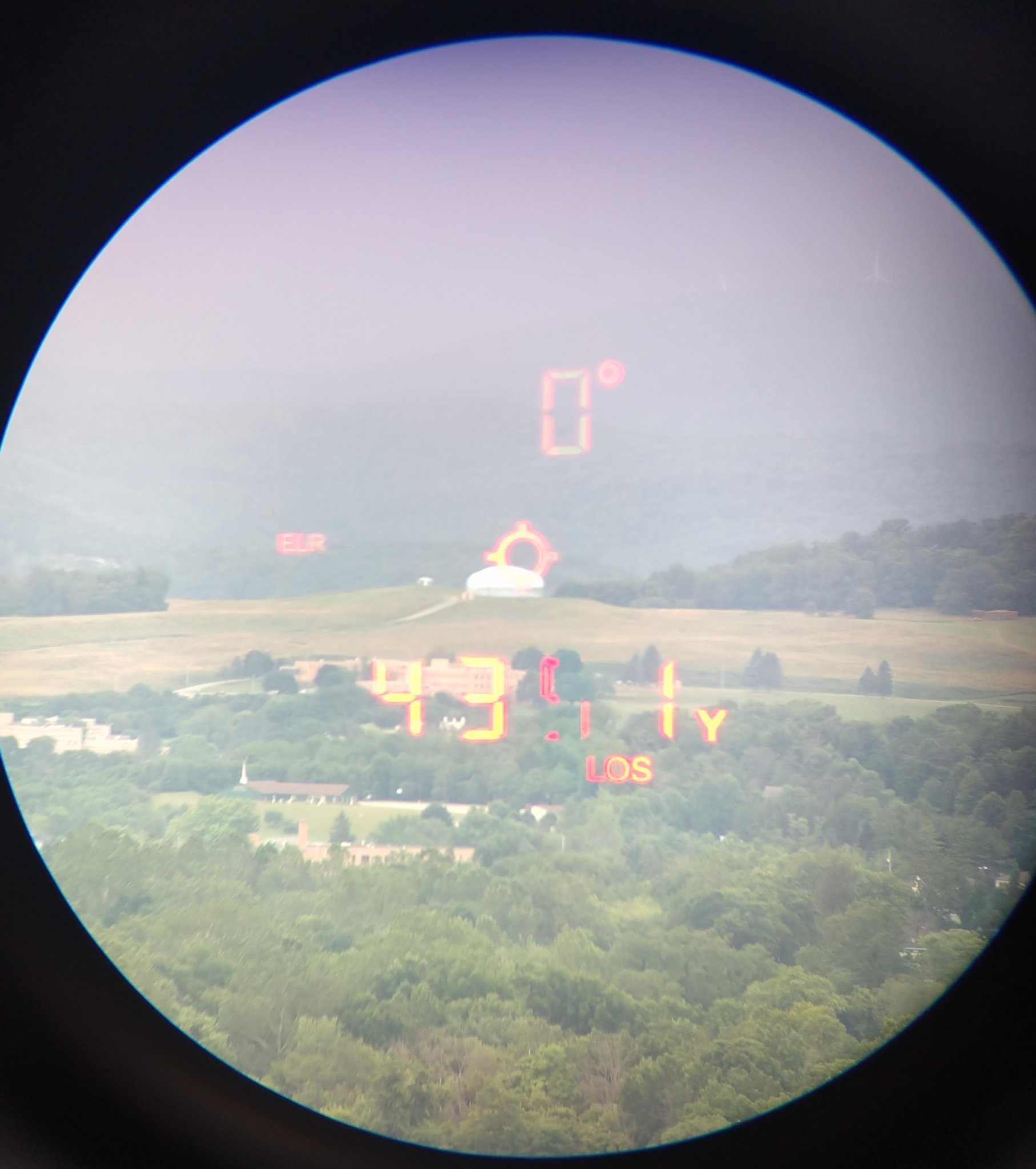

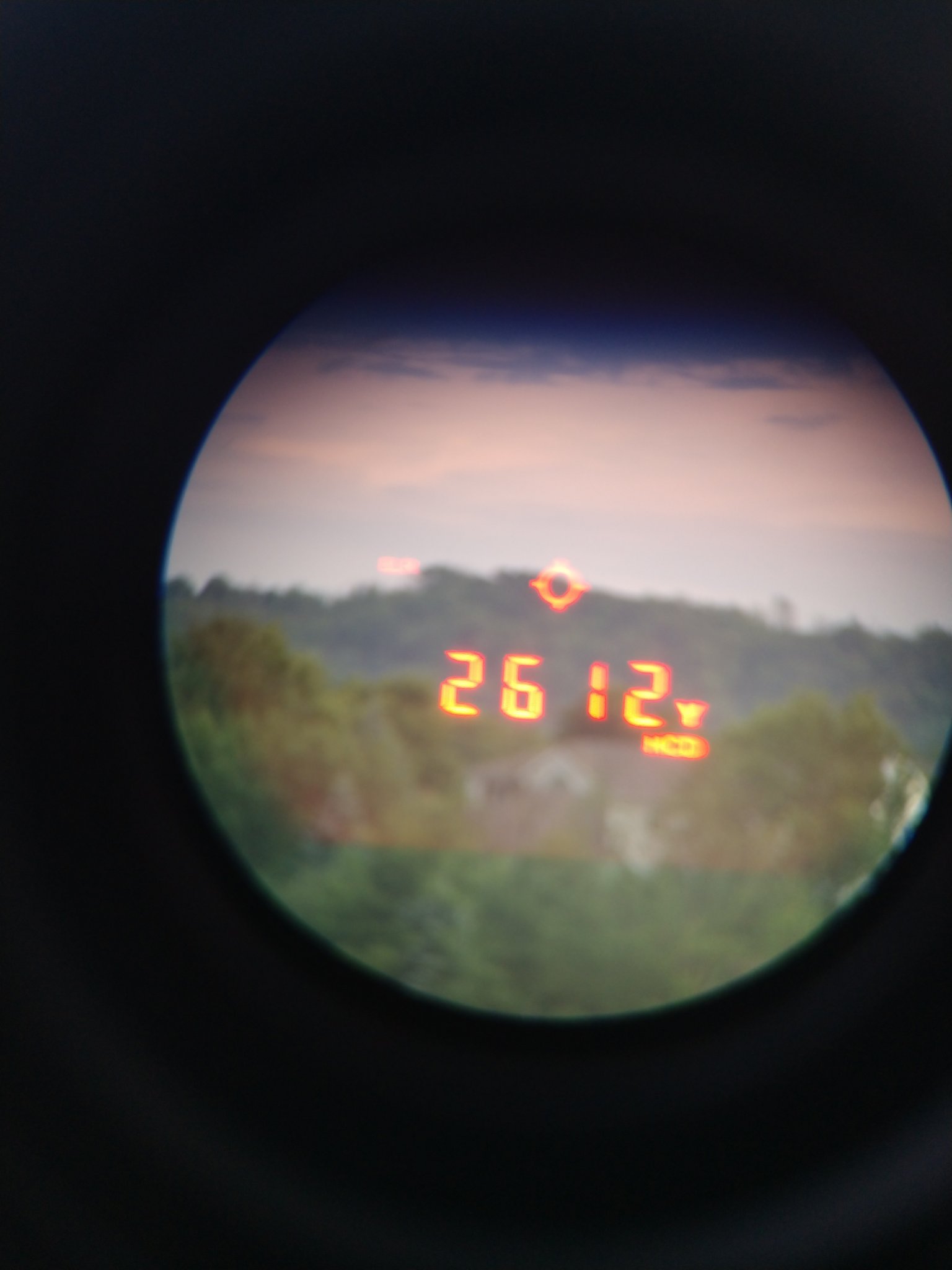

Here is part of a review i did on the Vortex Razor HD 4000 LRF. It performed far above my expectations especially for about $500.
In the "standard" mode, i was able to easily range trees to about 2100 yards in bright sunlight. In overcast conditions, or late in the day, i could hit trees at 2600 yards. The ELR mode is very impressive and works very well. It is important to realize that you have to hold the ranging button while the ELR mode "builds" on the target so it is best to use a tripod for sure. In ELR mode, I was able to range trees a little over 3000 yards and a house at 3238 yards in bright sunlight. Shortly after, as a storm rolled in and the sky became overcast, I was able to range a water tower at 4352 yards, WOW! That really sold it for me. On a side note, a buddy has a Terrapin X LRF and we ran these two side by side, the Vortex won hands down. The Terrapin basically stopped ranging between 2600 and 3000 yards depending on the target. The one thing the Terrapin did have is bluetooth connectivity, the Vortex did not. Some people may consider this a Con but I have no need for it so YMMV. To sum it up, HIGHLY recommend it and dare I say, the last range finder you will ever need.

View attachment 7357457View attachment 7357458
I'm assuming there really wasn't an issue with the readout in the second pic that it was a product of the camera? I am really considering the new vortex razor rangefinder. looks like an awesome "bang for the buck" range finder.
Definitely an issue with taking the photo through the LRF, readout was perfect. Obviously I would encourage you to try one. The pics should speak for themselves.
Are you confident that you ranged a water tower and not the tree line behind it in the second picture?
Also, the first picture is too blurry to notice much of anything other than the electronic readout.
I know how difficult it is to get good quality "through the scope" or in this case "through the rangefinder" pictures though.
So, on the lower pic, the blue water tower/tank was ranged. I think I had my hand on the back of the LRF to steady my phone for the pics, probably tipped it upward a little. IIt took a good 5-7 seconds for it to "build" on it but when the range came up I was F'ing impressed!
In the top pic, I wanted to see how far it would range on only trees. So i was ranging the very top of the trees on the furthest mountain I could see off of my back deck. Again, ranging trees at 2600+ yards was also damn impressive. Like you said, it's hard to get pics through optics sometimes, I'm sure that where the blurring came from.
