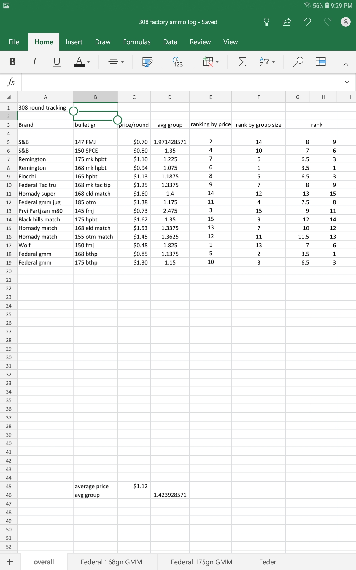

Just thought i would share how my rifle performed through the first 300 rounds down the tube and with lots of different ammo. I tested a lot of different ammo, either bullet weight or manufacturer so i could see if my rifle had any preferences. As you can see in the picture attached the price per round, average 5 round group size recorded. The next column is rank by price and next rank by group. I wanted a way to rank them using both price and accuracy so i just added price rank+ group rank/2= the blank column and using those a final rank of the ammo. I know it is a lot over analyzing but i enjoy it.
Most of the group data was 1 box of ammo so 4 groups of 5 rounds. I got 200 rounds of both the remington 168gn and GMM 168gn coming in the mail to refine those two groups data points. As i get a chance to try different ammo i will add it to the chart and update from time to time. So far the average 100 yard group of the rifle with any ammo is 1.42 inch.
