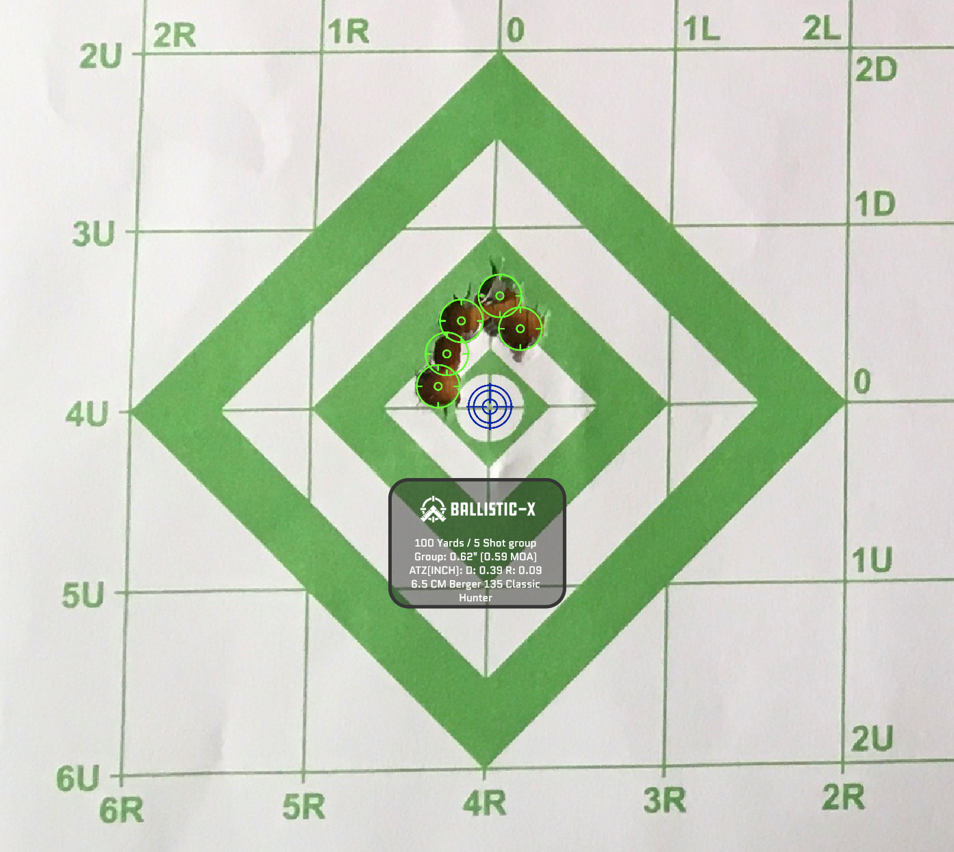

Since the Berger 130gr hybrid is unavailable, I tried a box of the 135 Classic Hunter. The stuff is just as good in my AI AT. Specs are:
avg velocity 2661 with Magnetospeed v3
sd 5.9
elevation 900
temp 40f
rh 51%
pressure 30.2
Group size .62” or .59 moa
Shot off bipod. I’m a newbie, and my 66 year old eyes aren’t great, so an experienced rifleman could do better.
Seems to be excellent ammo.
Steve
Uses small primers. I cant explain the low velocity. Have a 24” barrel. My first time using the chrono. Bought it used, maybe it has a problem. Factory velocity from 26” barrel is 2851.
Yeah...that MV would not be good at distance. Your measured MV is definitely off. The difference in barrel length wouldn't account for 190 fps. I can't believe the MS chronograph is that off. Did you have it attached properly?
At any rate, the data looks good and thanks for checking it out for everyone
