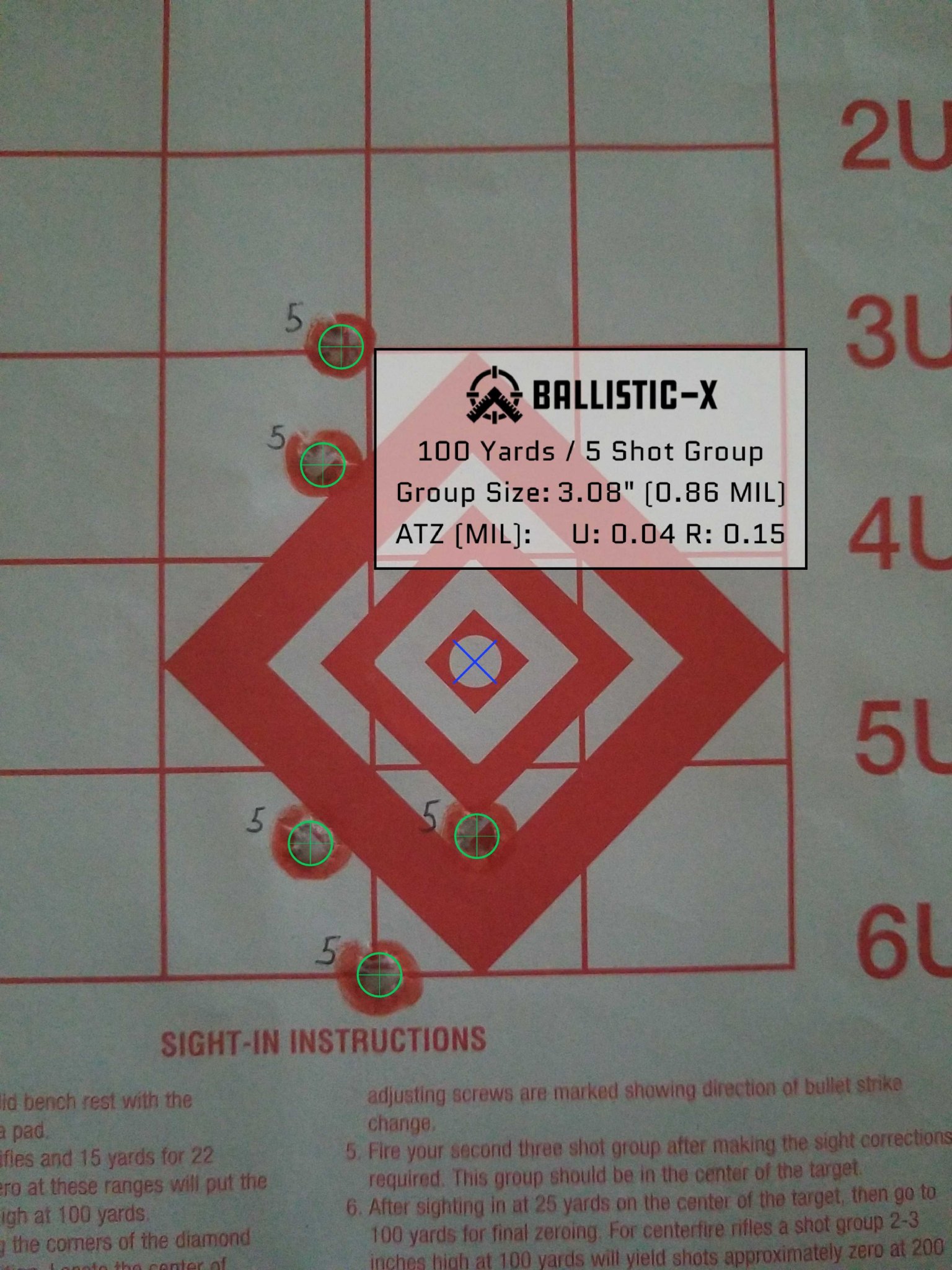

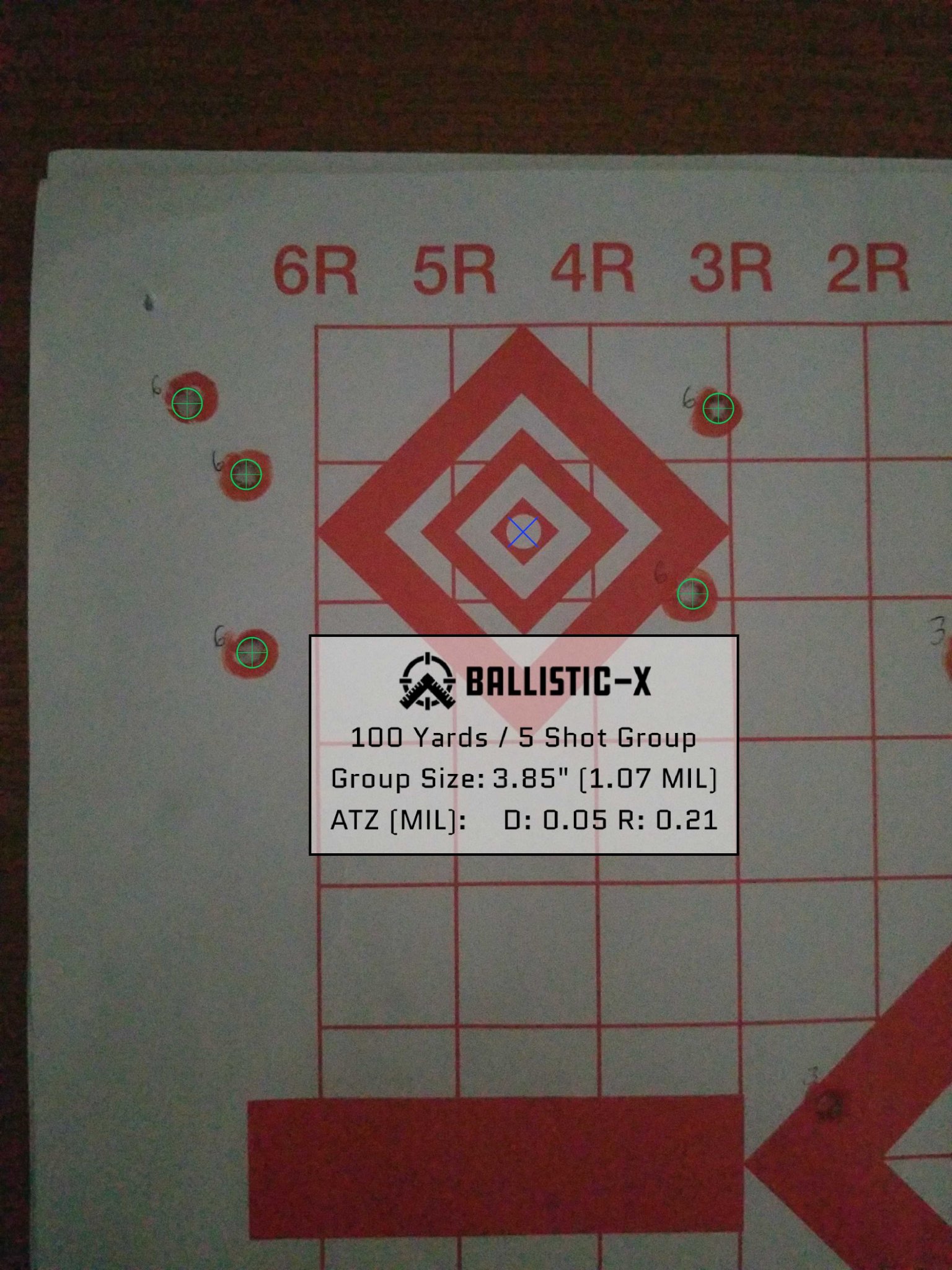

So thought I'd just create a "blog" of sorts on my precision shooting escapades. I'd also like to post up questions and polls to get some answers as well. We'll start with my first question: Shooting 55gr Federal Soft Points out of a 1:7 twist 12.5 inch .223 Wylde barrel, what would be the reason for these less-than-average groups? I was shooting off a bench with a bipod and a sandbag in the rear.
7045402
7045403
7045404
7045405
A result from my 6.5 Creedmoor gasser to show an "average" group from that:
7045409
I can consistently shoot the 6.5CM gasser in the ~2 inch group.

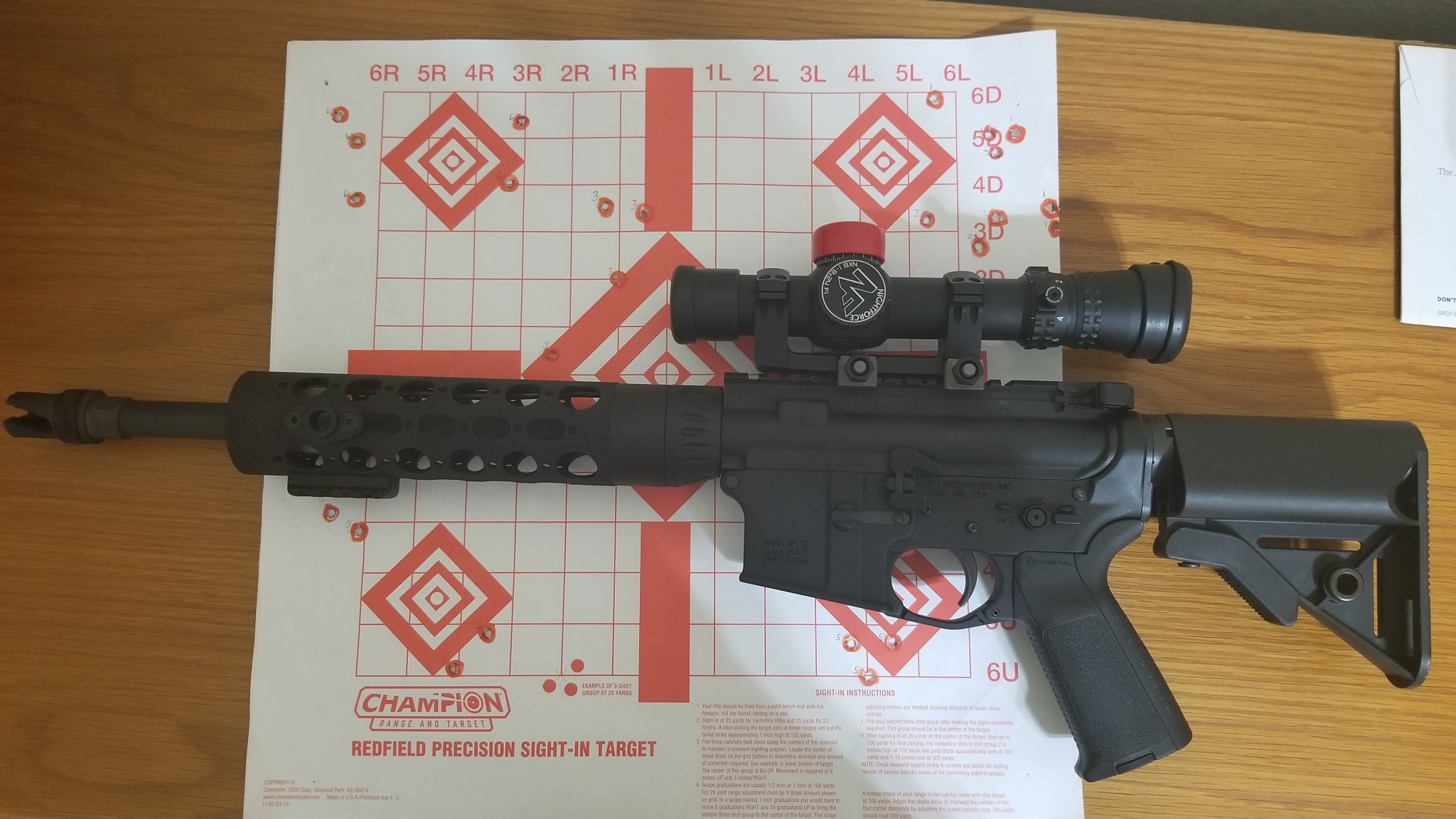

All I know was my form was horrible. I'm still learning on how to load the bipod but the bipod definitely hopped after every shot. The range provided sand bag offered a surprising amount of stability.
The rifle is a DIY build using JP parts, LMT PDW stock, and a Green Mountain barrel spun up by my smith, and an NF NX8 on top.
7045418
I try to buy a case of ammo at a time. But does this mean that my zero will shift from case to case? I think reloading will have to be in my future if I want to squeeze out as much accuracy out of both my rifles.
I don't expect to shoot tiny 1/2 inch groups from my SBR but I'd like it to be ~2 MOA out to 200 yards. This should definitely be a goal I can achieve.

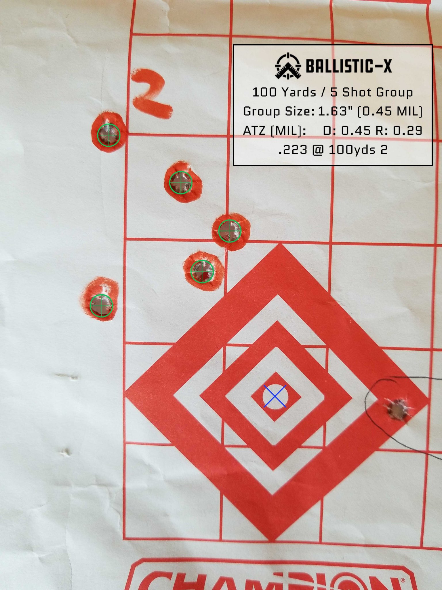

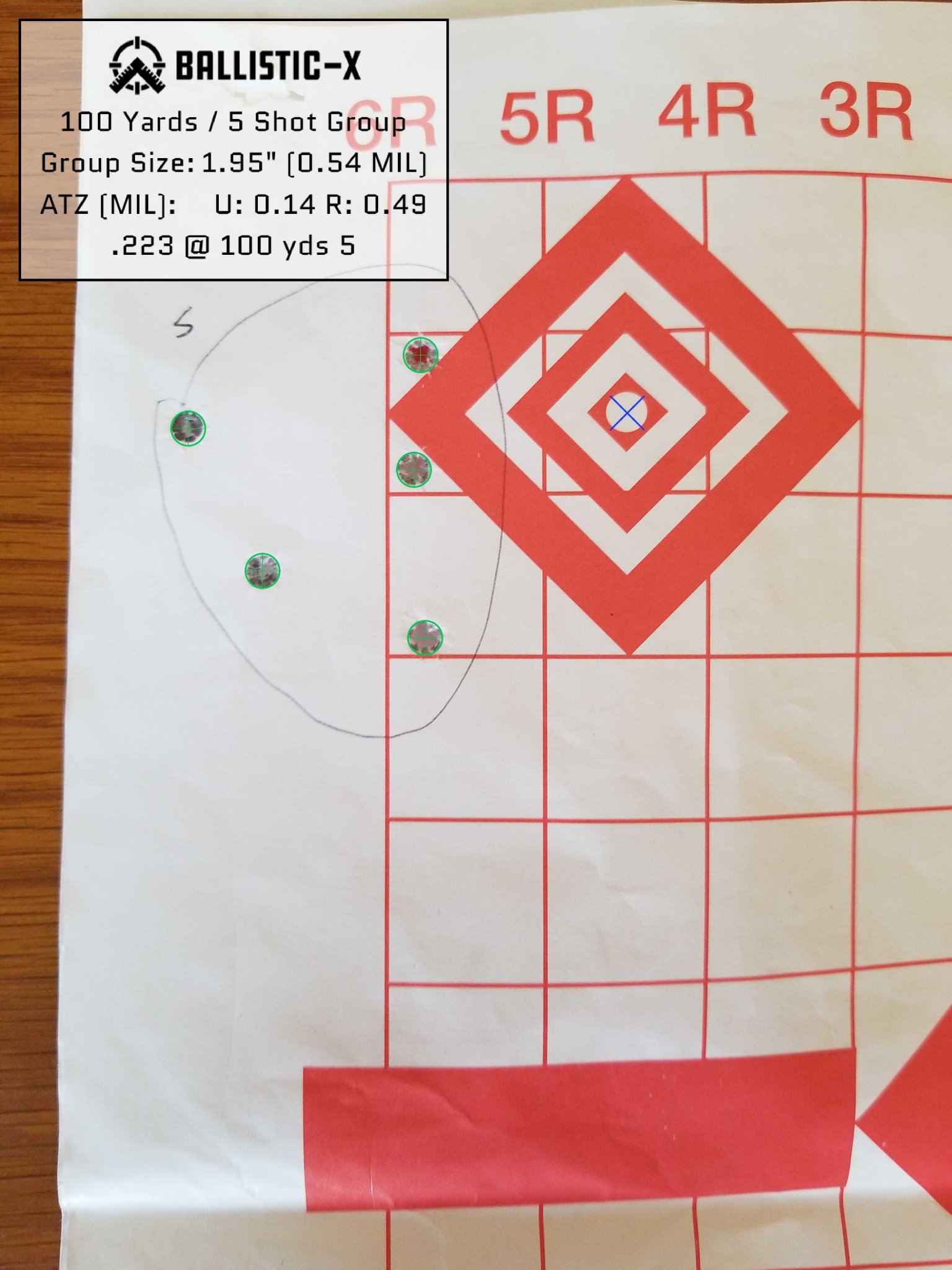

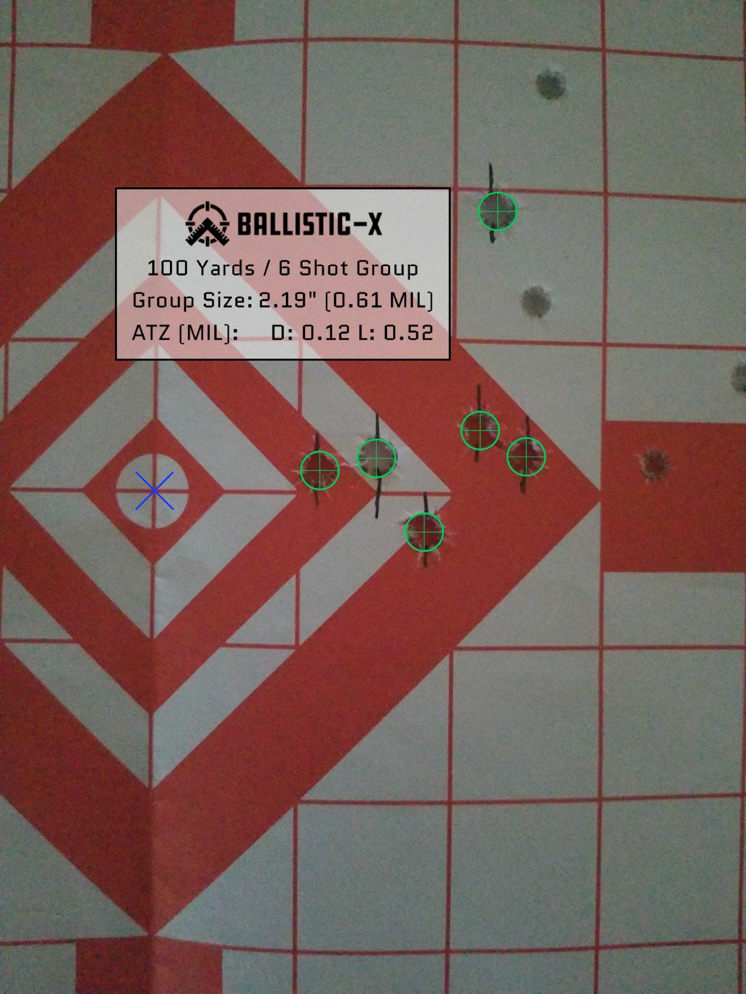

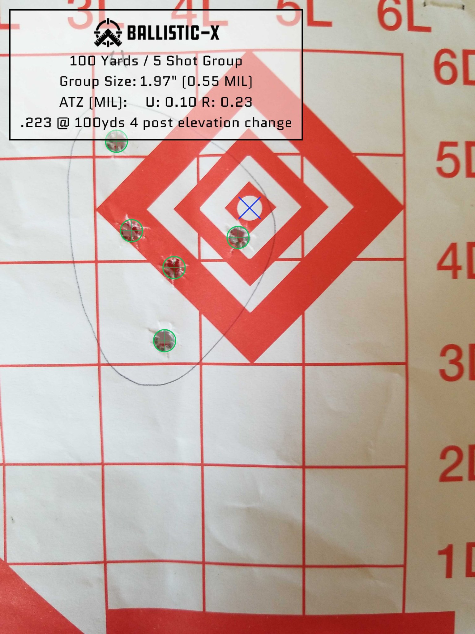

I talked to my barrel smith and he recommended a heavier, non soft-point bullet. So I went to my LGS and picked up two boxes of Hornady Match 75gr BTHP. I went to the range yesterday and started off at ~50 yards then pushed out to 100 yds. I also shot my last 15 rounds of 6.5 Creedmoor Prime out of my AR10 to compare.
50 Yards 223:
100 yards 223:
100 yards 6.5 Creedmoor:
I had all 15 6.5 Creedmoor in one magazine and lost count while shooting the groups so group 2 was a 6 shot group while group 3 was a 4 shot group.
For both rifles, I shot as soon as I was ready so I did not let the barrel cool down except for walking down the range to mark the targets. Group 3 for .223 at 100 yards I adjusted elevation so that I wasn't consistently shooting high. I never got around to adjusting the windage but I ran out of match ammo before I could dial it in. The accuracy I obtained during this range session is a lot closer to what I am expecting and what I am currently capable of. I went to a tac bay with full size IPSC steel setup at 60 yards and I could hit the targets with an 85% success rate from the standing position. The main reason for my misses was my shoulders tiring out so it's truly time to hit the gym. I've become such a fatass.
A couple things I learnt: Shooting a pdw stock in the prone is not fun, there is a lot of muzzle climb with my AR15 when shooting standing, I need to work on positional better, and my AR15 barrel shoots heavier bullets a lot better. I do not know how to set the diopter and parallax on my NF C618 so I need to figure that out.
