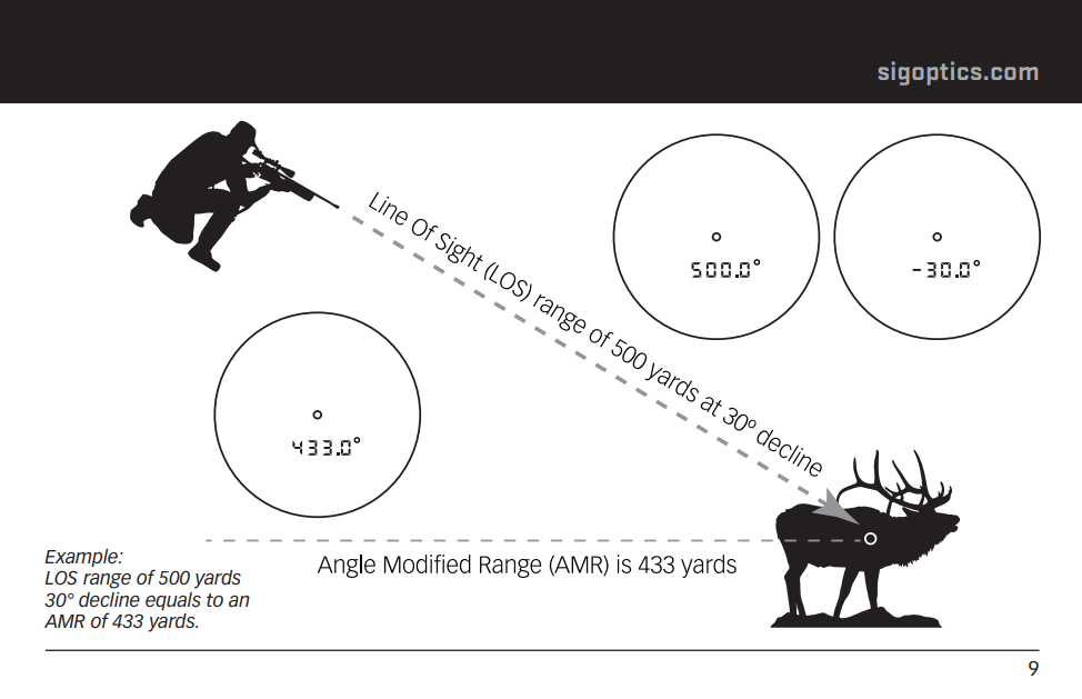

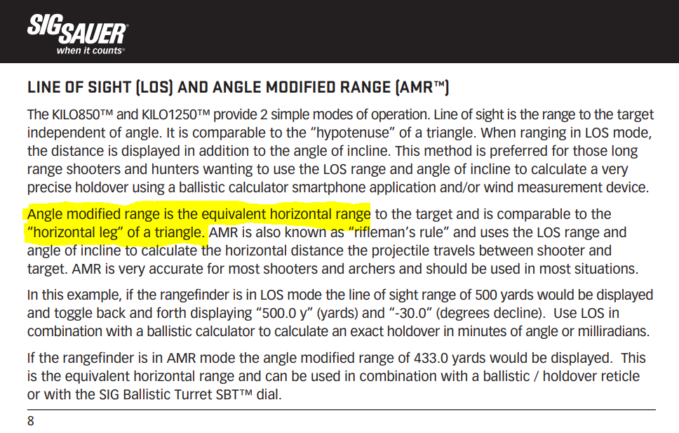

This is now a moot point but, yes, AMR in a Sig Saur range finder is the true Horizontal distance readings. AMR stands for "Angle Modified Range"
Here is a portion of thier user manual that defines LOS and AMR
Its good to know your equipment.
The manual for my kilo 3000 also states that at longer ranges, I believe they say 800+, the AMR isn't as accurate and its better to use LOS and angle in a ballistic calculator.
