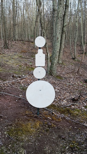

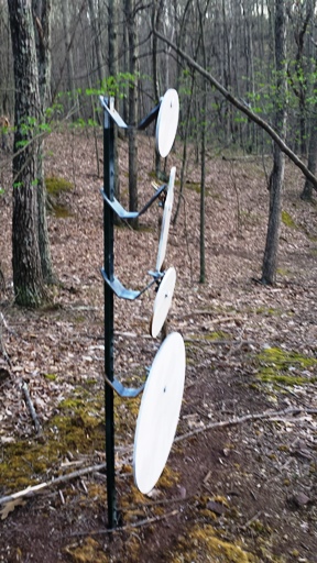

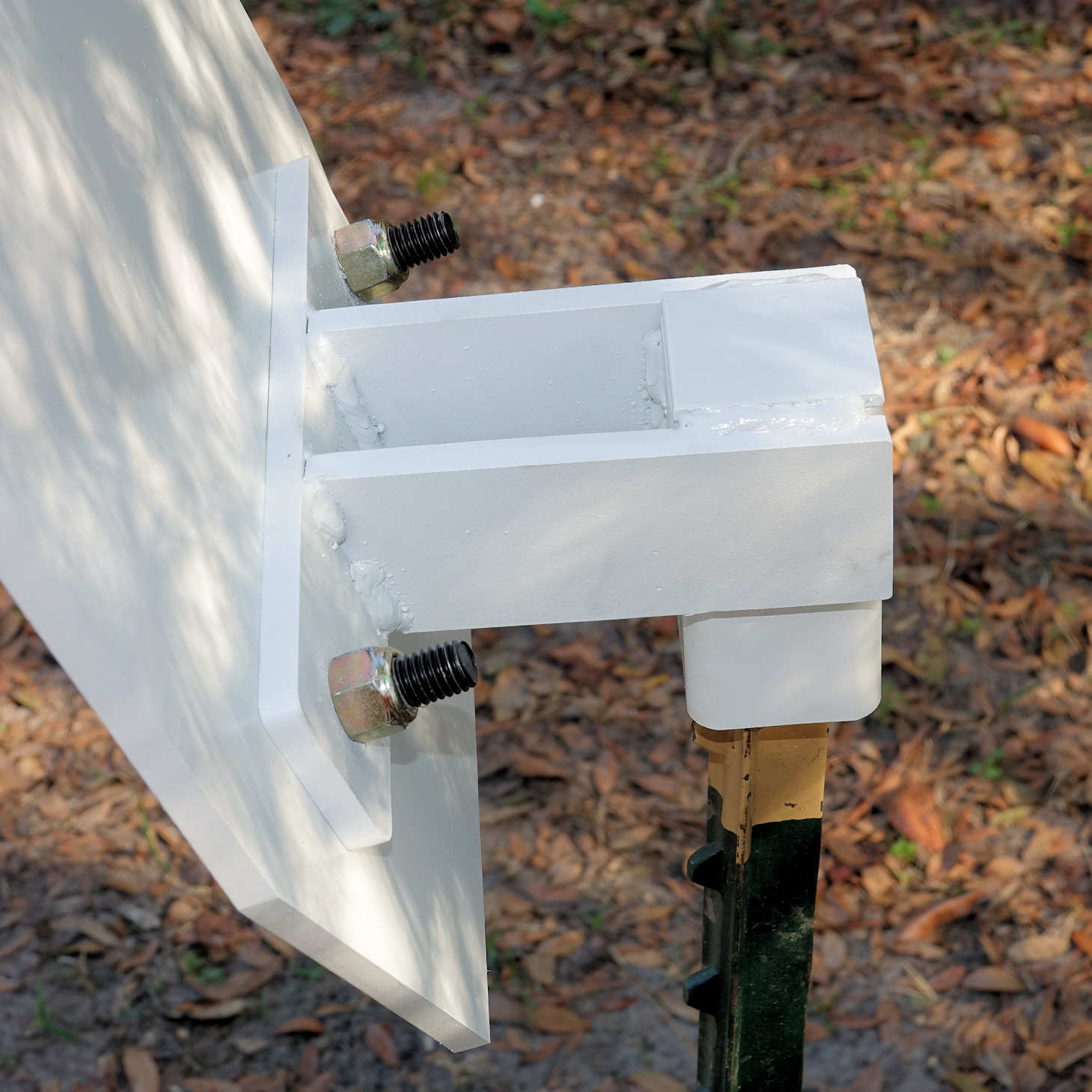

Hang Fast Targets makes a hanger that uses a T Post. The design protects the hanger and hardware from bullet damage. These targets are VERY reactive and have excellent sound.
This target array has a 24" 3/8" plate on the bottom.
It has been in place for 4 years without maintenance
and taken thousands of rounds.
Stacking the targets also protects the T post from "knuckleheads"

This 12 inch plate is being hammered with 12 gauge slugs @ 25 yards
