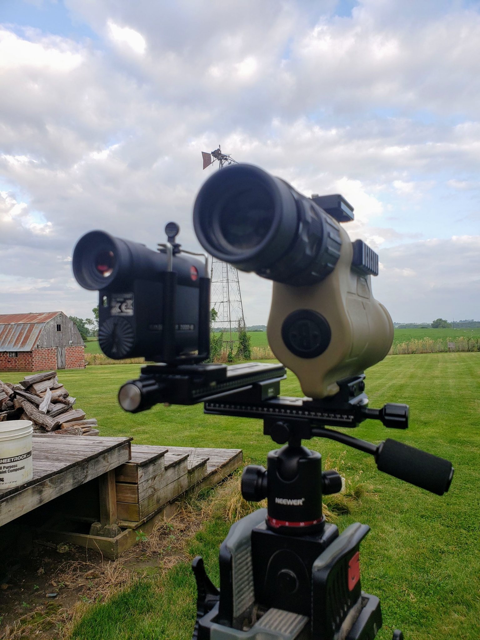

Here is my spotting set up for pdog hunting with a partner.
