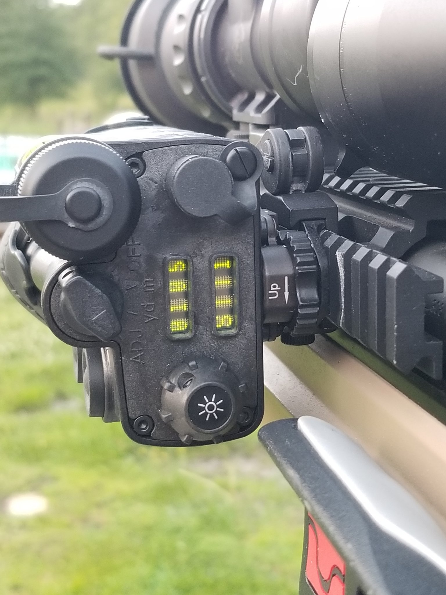

Wilcox raptar is the move..... very pricey but now that I've been running mine (full power) a while I see the value in it. Not only does it allow you to range at night but it's also an awesome daytime range finder..... I'm thinking of selling my sig bdx 3000 binos because the raptar can consistently range much further than they can and because the raptar is weapon mounted it's much steadier for ranging small targets.
