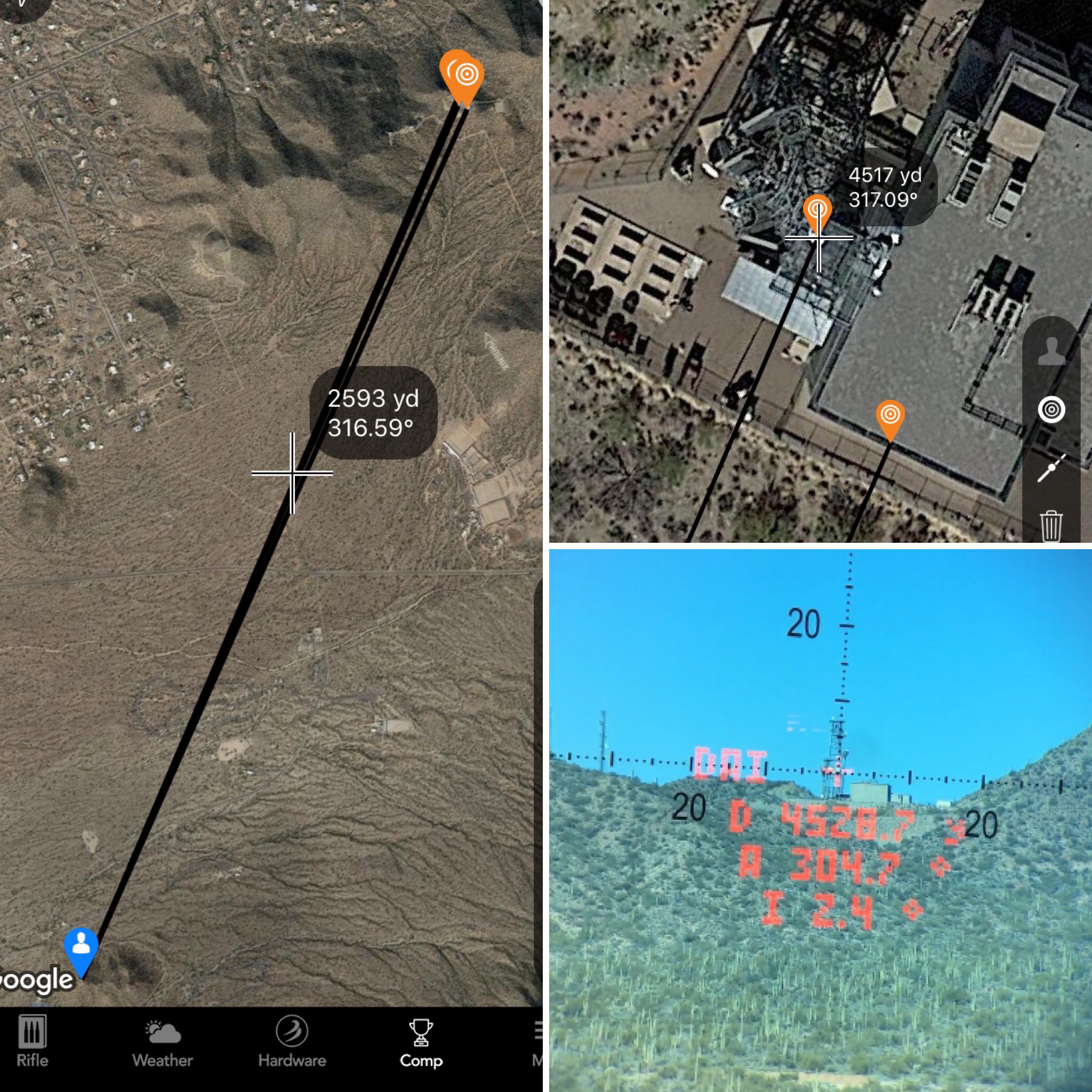

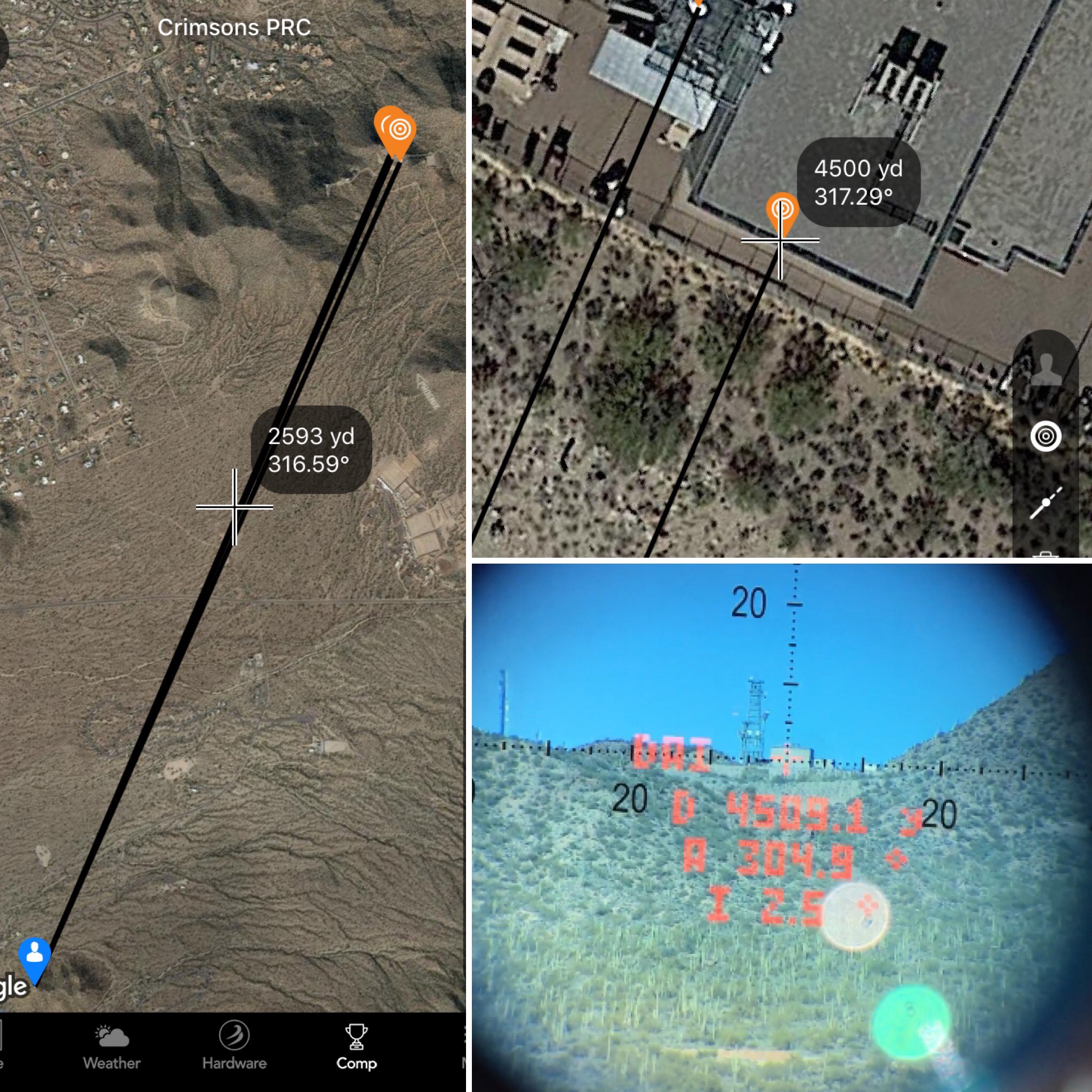

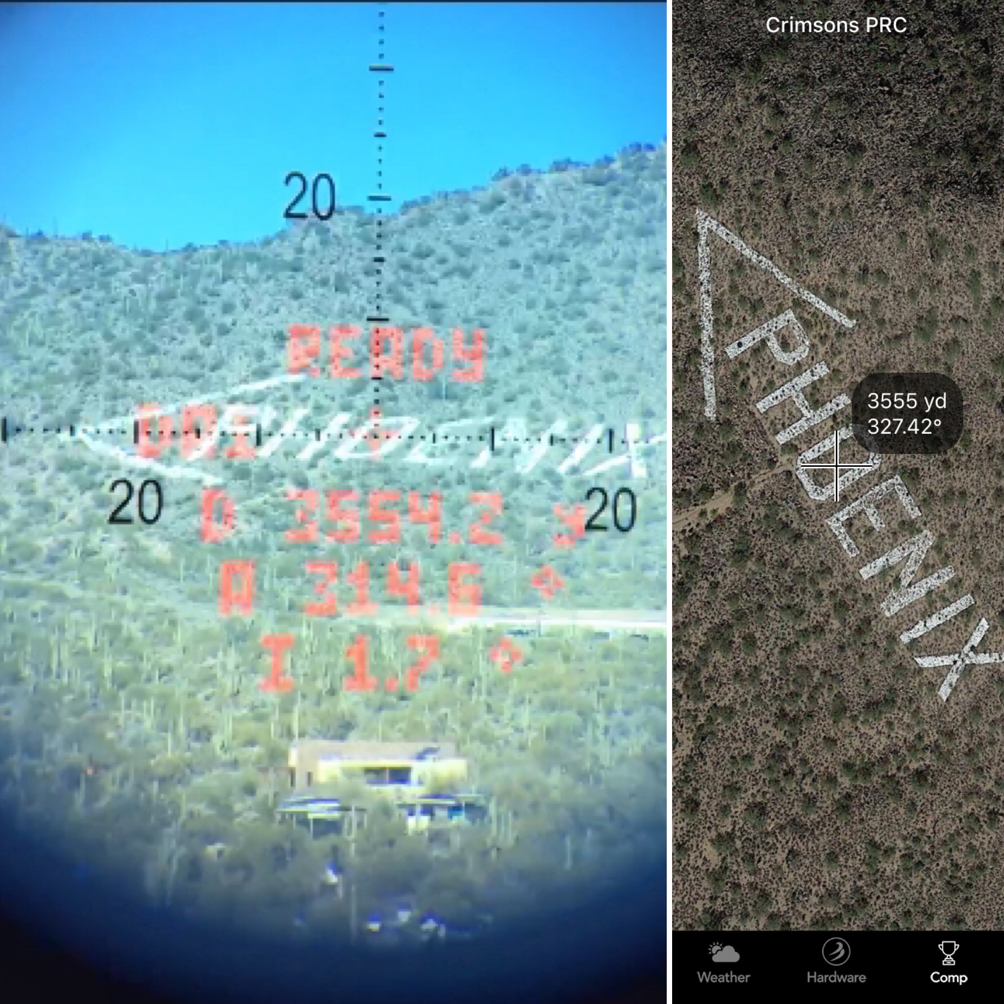

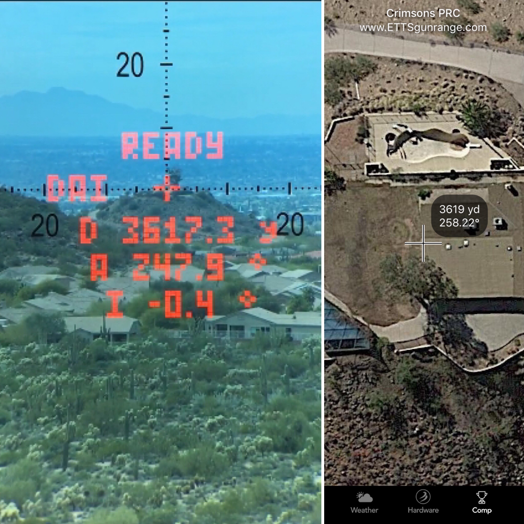

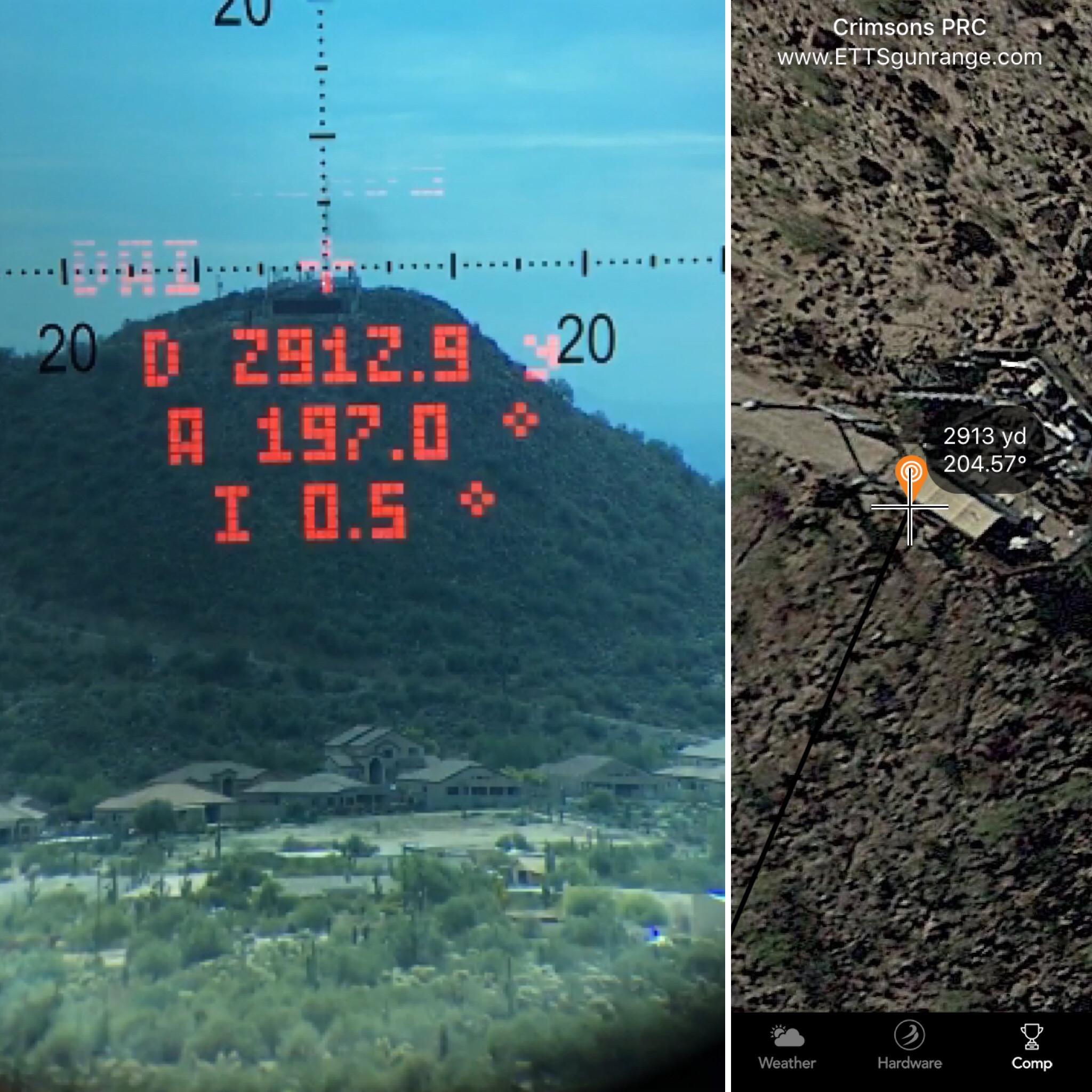

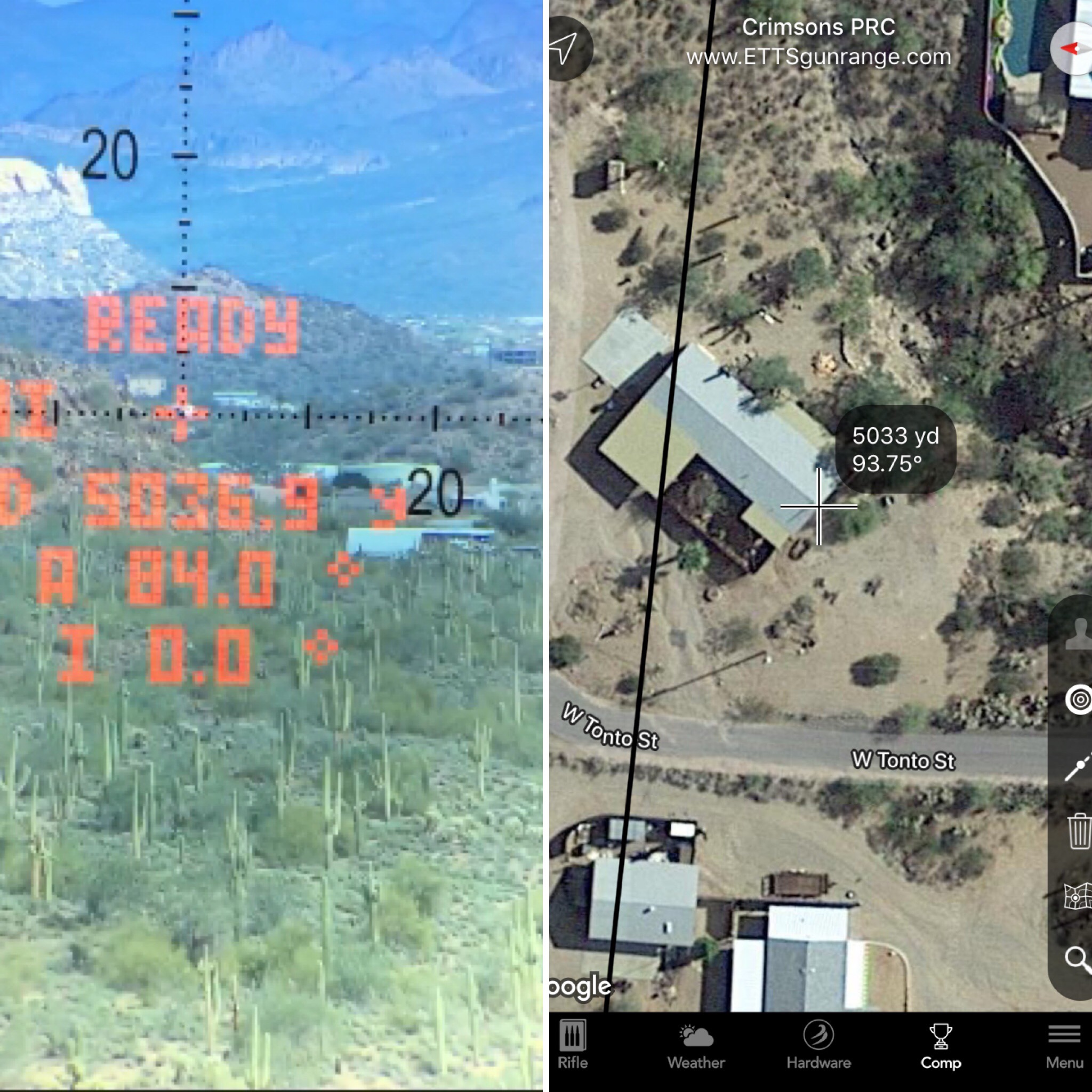

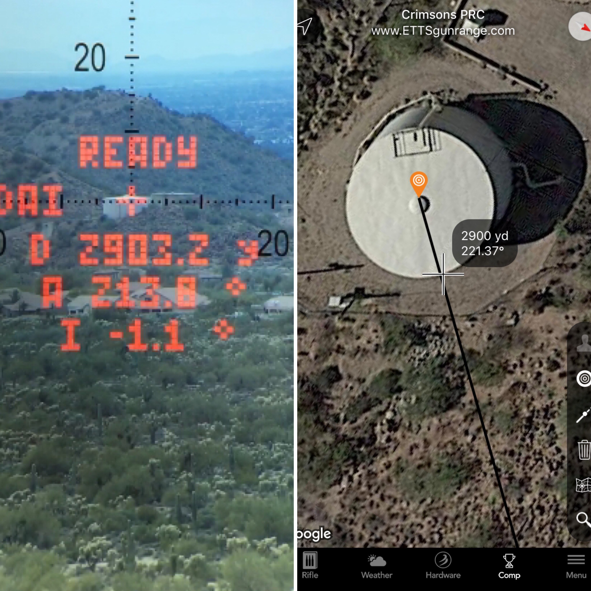

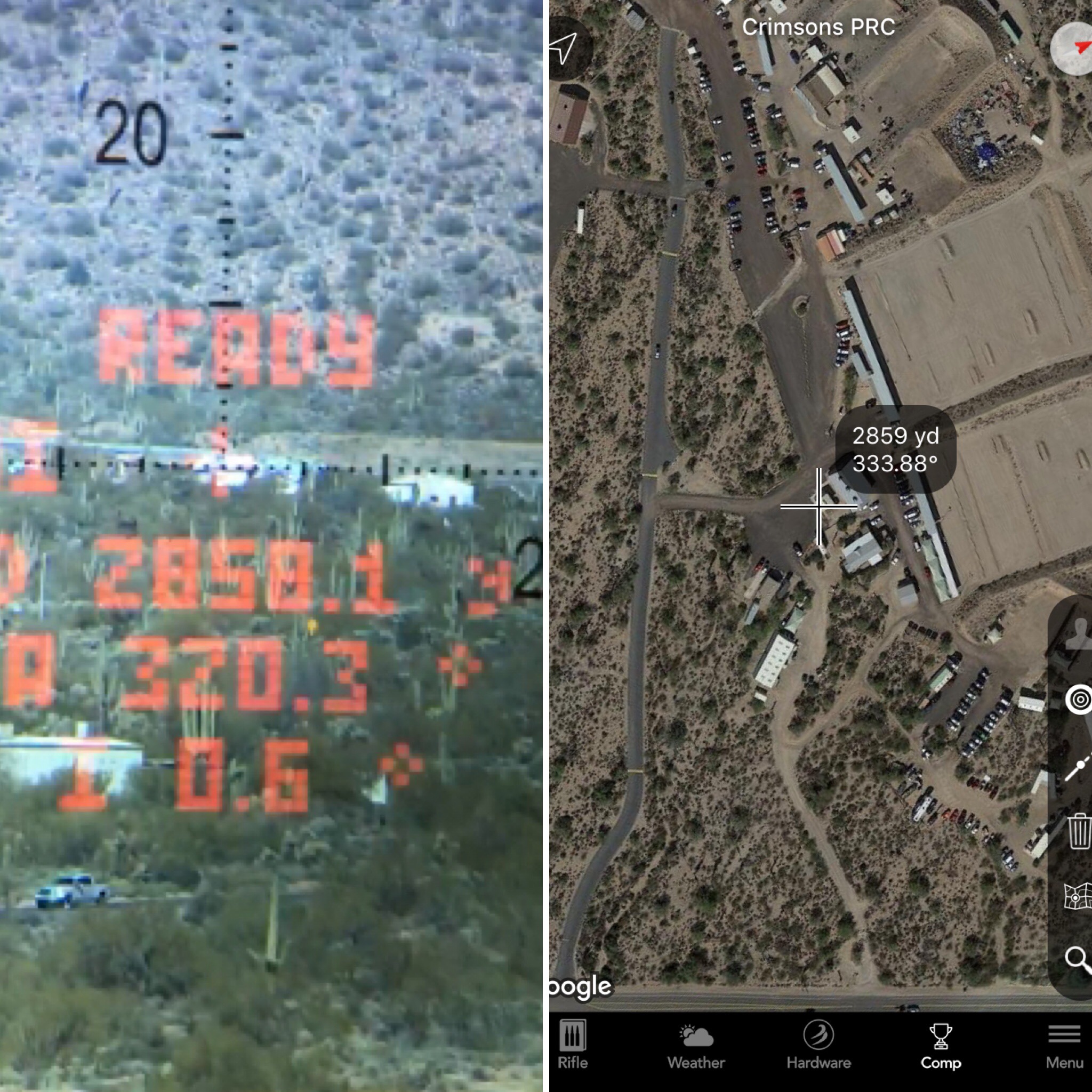

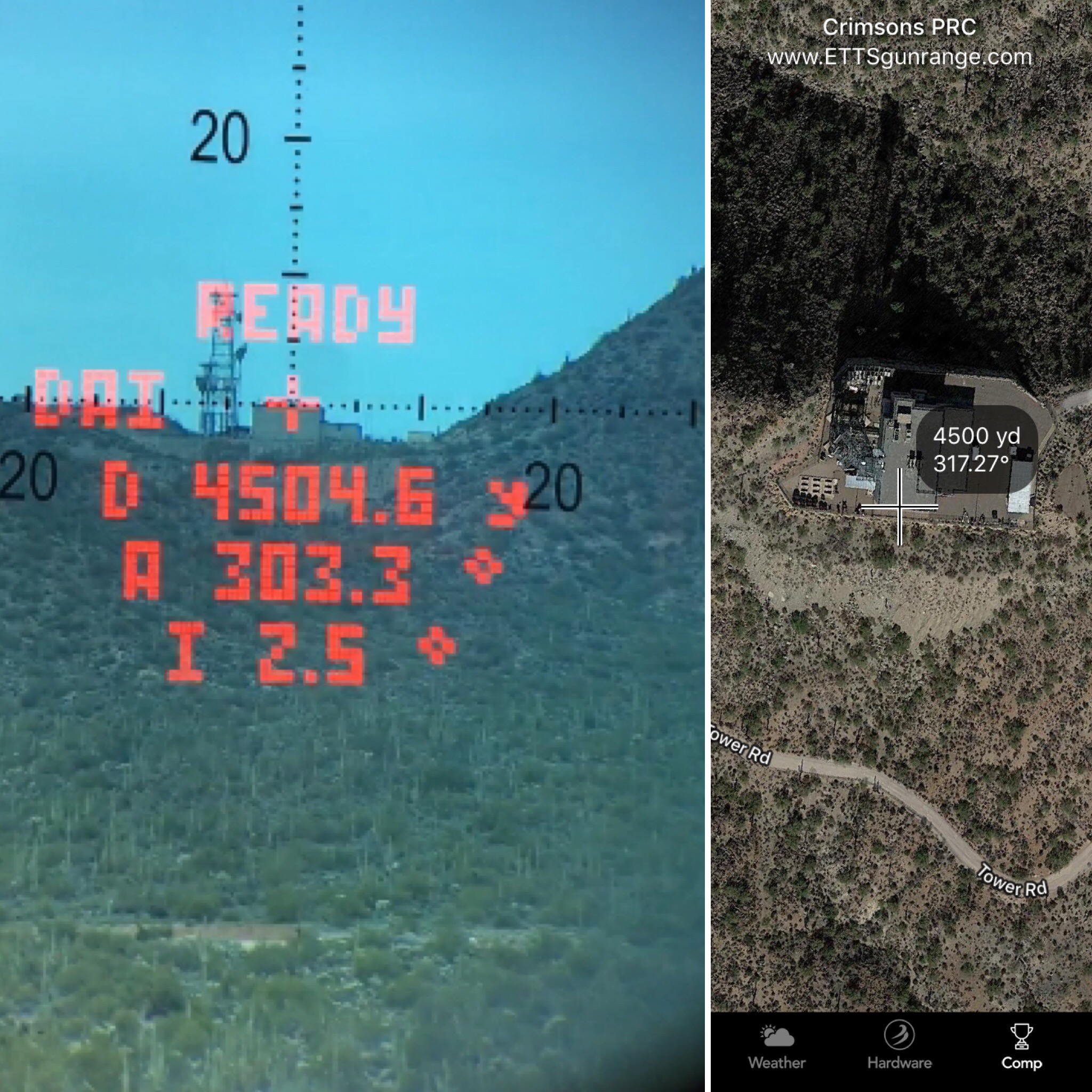

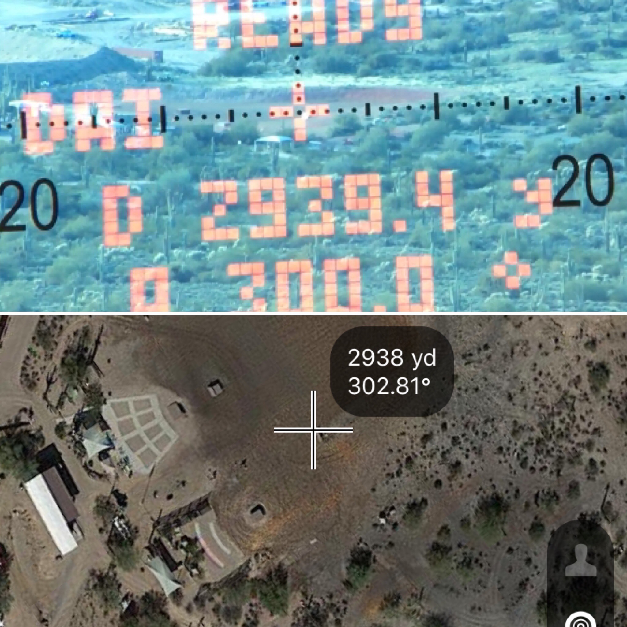

    I'm too poor to afford anything cool or expensive so I started with a Bushnell Elite 1500 which was difficult to get a read on anything past 1000m. Conditions had to be PERFECT and on some sort of rest to get a reading. I recently ditched that and got the Vortex 4000 range finder and it has worked pretty well for the distances I shoot. It can get readings back on a steel target, bush or rock fairly easily within 2000m. Beyond that, a rest and the ELR mode would be needed. But for less than $500 for something that fits in the palm of your hand, it's a good value.
    I have a NewCon LRM3500BT. I rarely use it because all my targets are known distances now. But below are some of the ranges I’ve done and bounced the results off of map data. I presume the mad data is good to ~ 12 feet but I’m not sure. All ranges are done in the bright Arizona sun.
    The last pic is of a target that I believe is 1MOAish. Not entirely sure.
    a tripod is a must
    Reactions: Ratchety and Nate87
    I have the SIG 3k binos and the Vortex handheld LRF (4000, I think). Both have ranged out to a mile+. I've compared them side by side and they are within a yard or two of each other.
    a tripod is a mustView attachment 7694785View attachment 7694786View attachment 7694787View attachment 7694788View attachment 7694789View attachment 7694790View attachment 7694791View attachment 7694792View attachment 7694793View attachment 7694797
