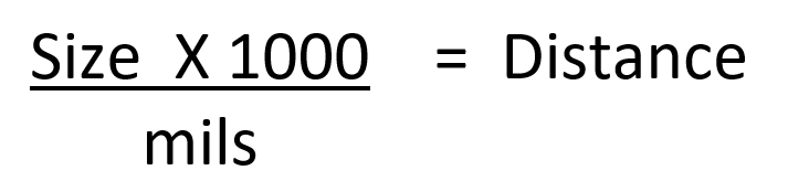

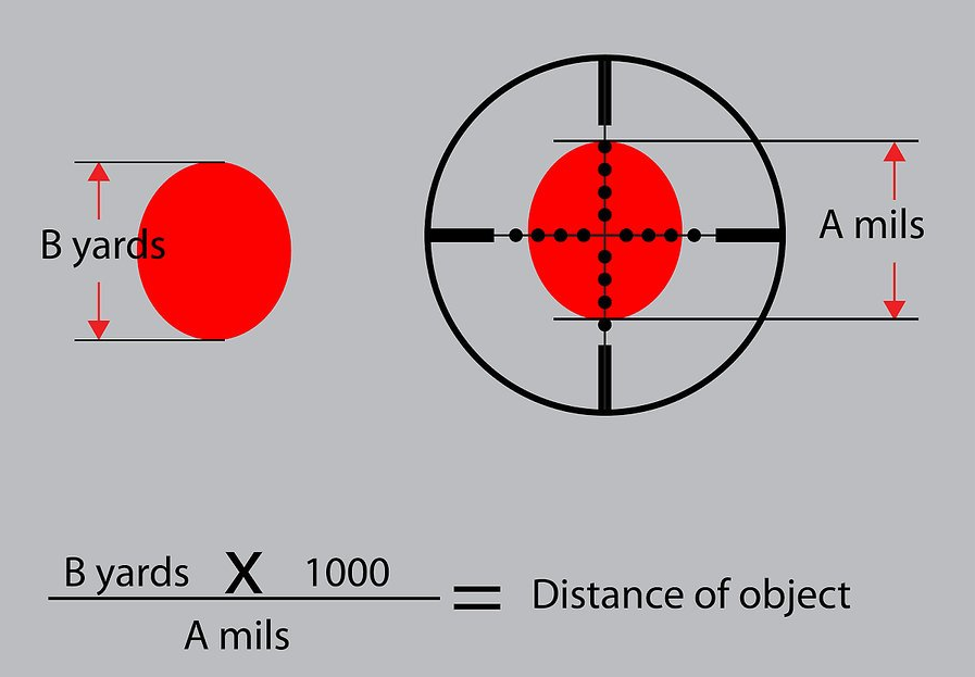

    @MK20 mils are very simple
    'size' can be in any unit you like (inch,foot,yards,meters,...) and the result will be in the same unit.
    so if your 12" (.33 yard) target ranges as .6 mil then the distance to the target is
    .33 x 1000 / 0.6 = 550 yards.
