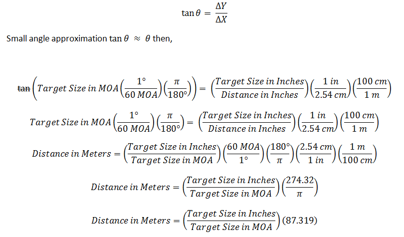

(target size/Image size)*87.3= range in meters

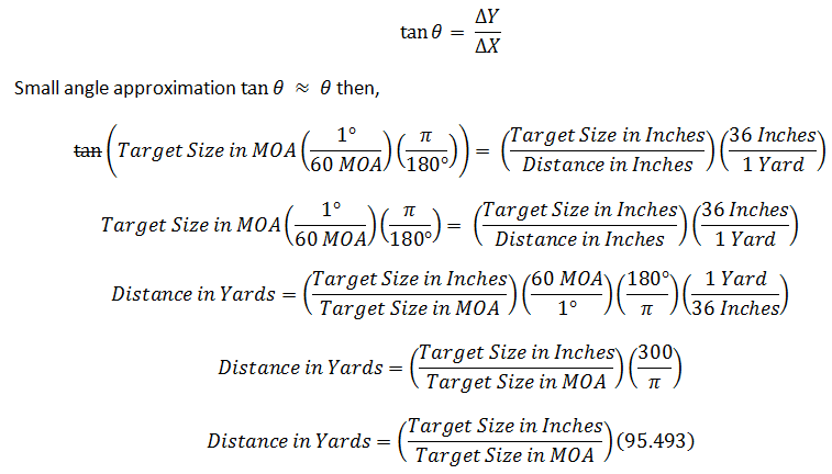

(target size/Image size)*95.5= range in yards

This may be a simple question but I've never seen it addressed anywhere. Can you range with a MOA scope?
Absolutely, whether milliradians or minutes of angle it's just an angular measurement.
Or that's the way I understand it.
Your correct.
Here's the derivation in yards:
Here's the derivation in meters:

In any case you can range with MOA. Estimate your target size in inches, divide by the number MOA subtensions your target displaces, and then multiply by 95.5 (which is the number of yds where the MOA angle subtends one inch) as was mentioned earlier.
