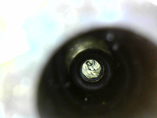

I actually got a one of theese small endo scope things. However, lens is a little too big for the chamber. To me, the rifling seems fine and intact, however i have no idea if i am looking at the right place ( throat ). Is it actually possible to see the throat in theese pics? It is my first time looking in a barrel like this, so please forgive me for not being sure where the throats begins and end... Is it the very first part of the rifling that is the throat, or is the further back towards the shooter? I can see that there is some small black spots at the beginning of the lands, but i dont know if its just the "edge" of them you can see, or possible wear?

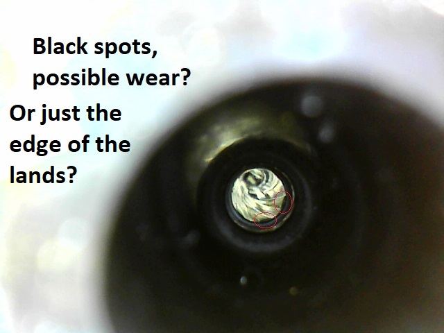

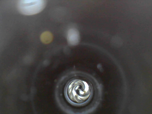

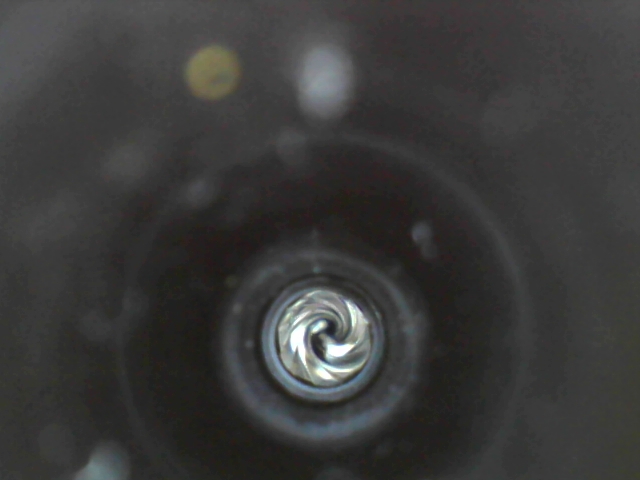

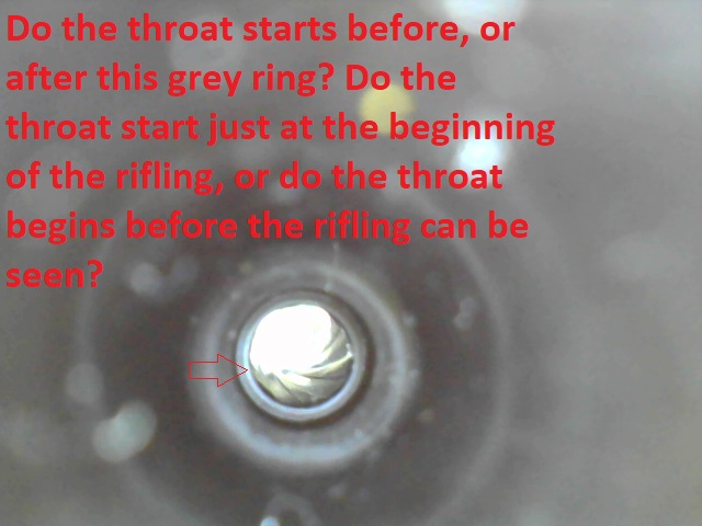

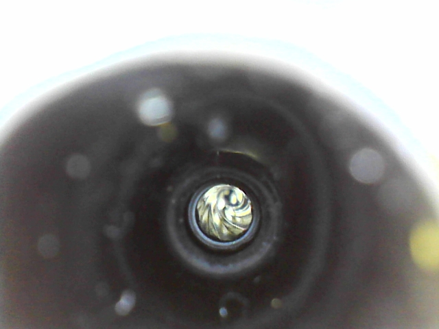

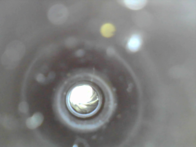

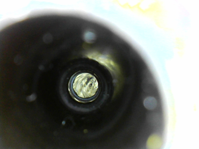

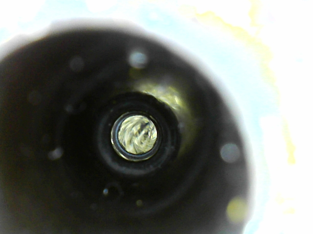

Thanks for the feedback. I cant really figure out where the throat starts and ends. I have made 2 pictures to explain. Maybe you can clear it out for me?
View attachment 7246449View attachment 7246450

Pay attention to when accuracy drops off. Check your BTO measurement when it does. Adjust accordingly. If accuracy doesn't come back, burn the fucker up with mag dumps if thats your thing and get a new barrel.
What you mark as black spots are the ends of the lands. That is the start of the throat. Bore appears ok form what I can see.
Thank you so much for your patience, and time to explain. As said, i dont have any experience with looking inside a barrel. The black spots on the lands, are that something you can find in most bores? Thanks again, i really apriciate it :)
