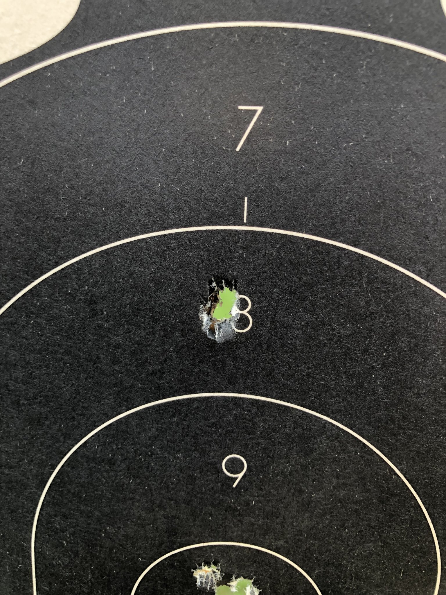

    Anyone had tracking problems with the Razor Gen II mine is only a couple weeks old and I am shooting way low at close ranges like 300 yards. I had to send my AMG back most likely because it was over torqued but I heard the razors were more durable. Getting ready to do a tracking test on it. Something I’ve never done before. Any help or advice would be appreciated. This isn’t due to weather variables way to big of a swing. The weird thing is past 600 I was hitting targets even an 8” tall gopher at 1000
    Mine zeros fine like the recticle and the scope the field of view is huge I can run it on 20 power on most stages. When I turn my turrets I get audible clicks you can here up to about 5 mil then they get mushy until I make another full rev. That’s what makes me think there’s something wrong I need to go check my AMG and see if it does the same thing.
    Four shots one of the few groups I shoot. Usually I shoot a couple to confirm zero and move out.
