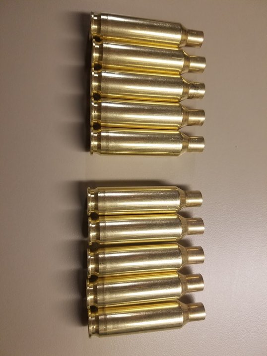

RCBS 6.5 Creedmoor Die - worrisome ring on brass...

Check out the following picture of once-fired brass (different boxes of factory Hornady 147 ELD) and let me know your thoughts... the 5 cases on the top were full length resized using one die that ended up having a defective depriming pin. I ended up exchanging that die and the new die seems to leave what looks like a pressure ring on All the cases it has sized thus far (5 cases on the bottom).
Worrisome? Or don't worry about it?
It could be just a dirt / grime ring but how much are you sizing back? Hard to tell from photo

had to turn up brightness.
You might need a small base die. Doesn't look like it's sizing all the way but the only way to know is check if you can chamber.
doesnt look like a sign of case head separation but you can double check with a paper clip running down the inside of the case. If it feels like you're hitting a dip then it is.
I just looked at my brass and it has the same ring but not quite as pronounced . To me it looks like that is were the bottom of the sizing die stops. I set the shoulder back .002 and am 7th firing without issue. I am using Redding Type S Match 3 die set.
I checked again and the fine line you see on the new die sized brass is exactly where the bullet was flared from the first firing in the chamber. You can see the slight difference in hue on the top brass, but the lower brass that is similar to what I've seen on my .308 sizing; however, the lower ones that were sized with the new die all seem to have that fine line right where the hue changes. Can't really "feel" it with a fingernail or paperclip and there is no evidence of case issues on the inside - more of a concern that the new die may be working/overworking the brass differently than the first one.
For comparison, I looked at some unfired Hornady brass that I just sized and cut and it doesn't have either the hue change or the same fine line.

Looks like the new die sizes the bottom of the case less than the old die. Can you measure the case diameter at the ring old vs new die?
Just before, after, and right on the ring I get the following measurements:
Re-Sized Case - Old Die: .465"/.467"/.465"
Re-Sized Case - New Die: .465"/.467"/.465"
New Factory Brass: .465"/.464"/.465"
Once-Fired Case: .467"/.469"/.466"

I assume by "how much" I'm sizing you mean the shoulder, correct? If not, and you're referring to the diameter of the case - especially at the base - the measurements are in my post above. I'm open to any and all feedback.
