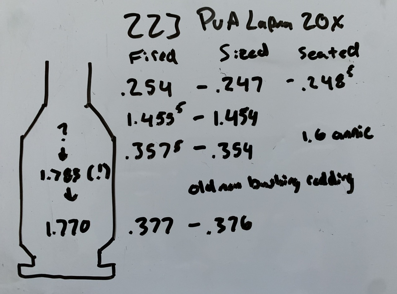

Turn your sizing die in until you get .002” of shoulder set back on the fired case.
Record all of your dimensions for fired, sized and loaded ammo for base, shoulder and neck diameters and shoulder set back.
