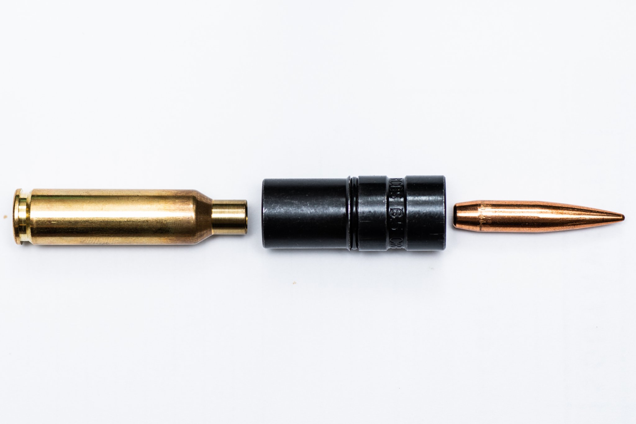

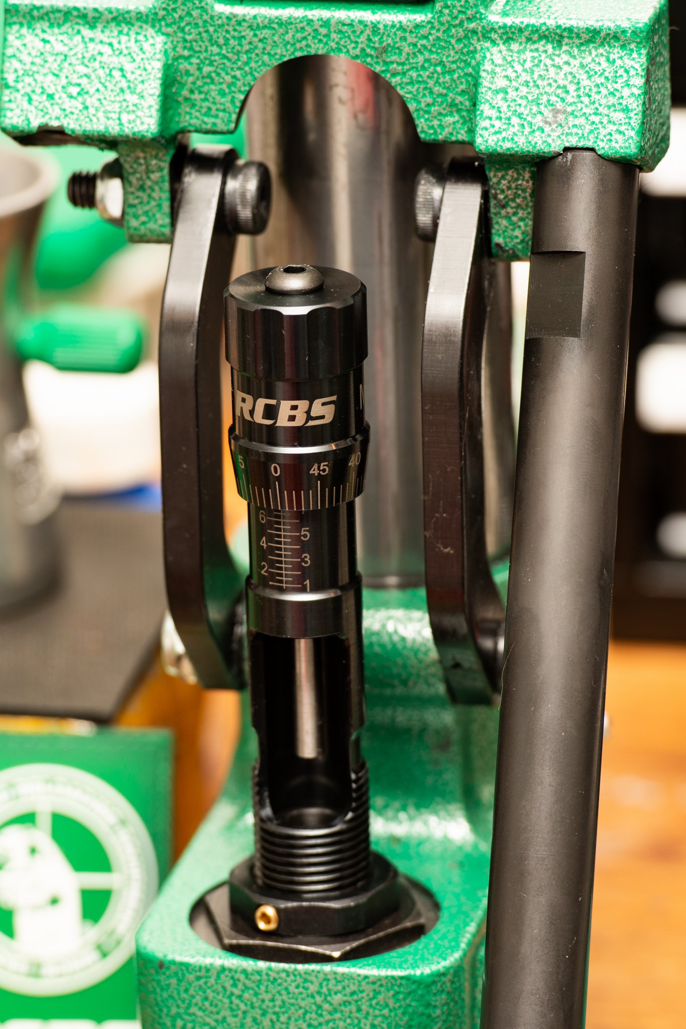

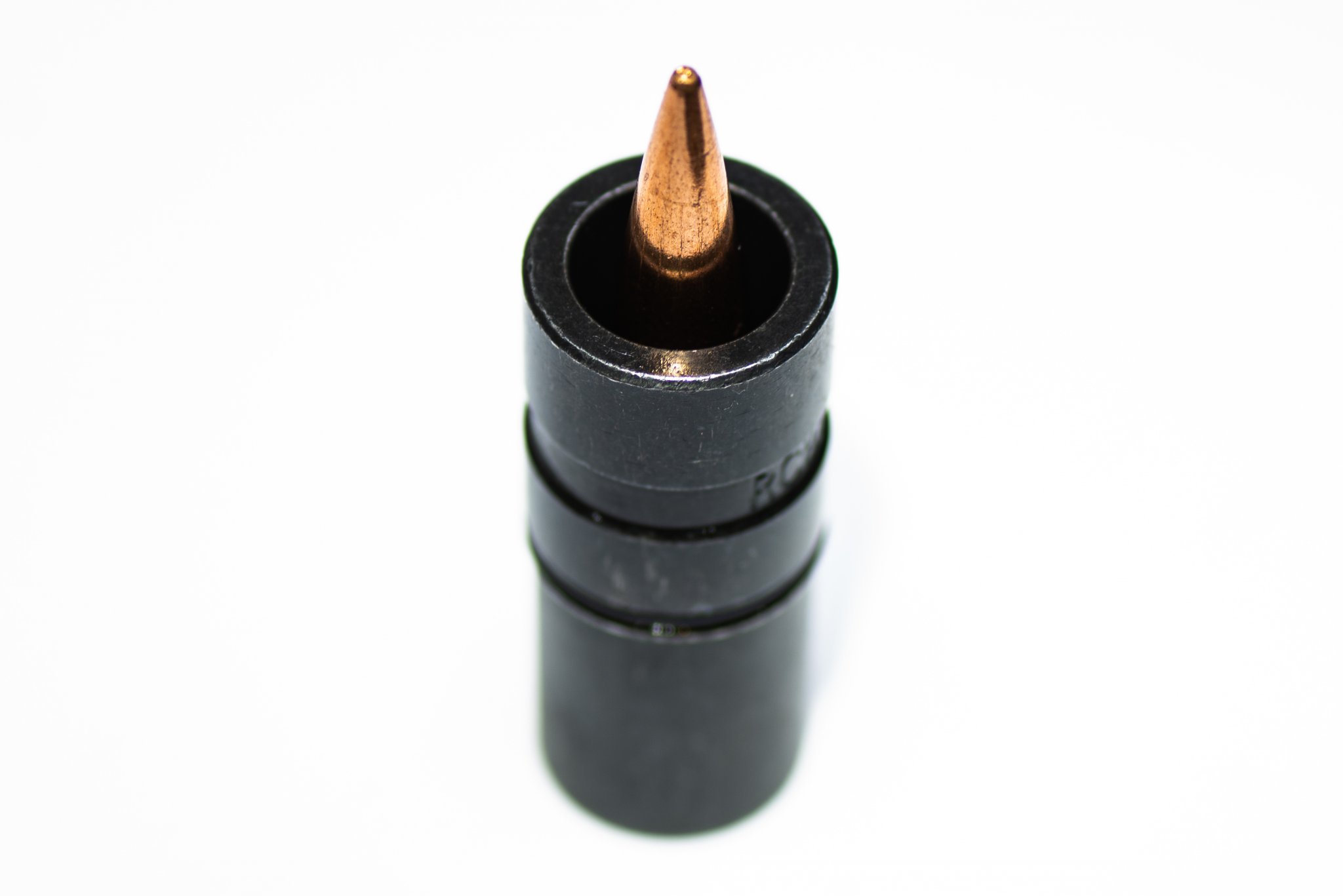

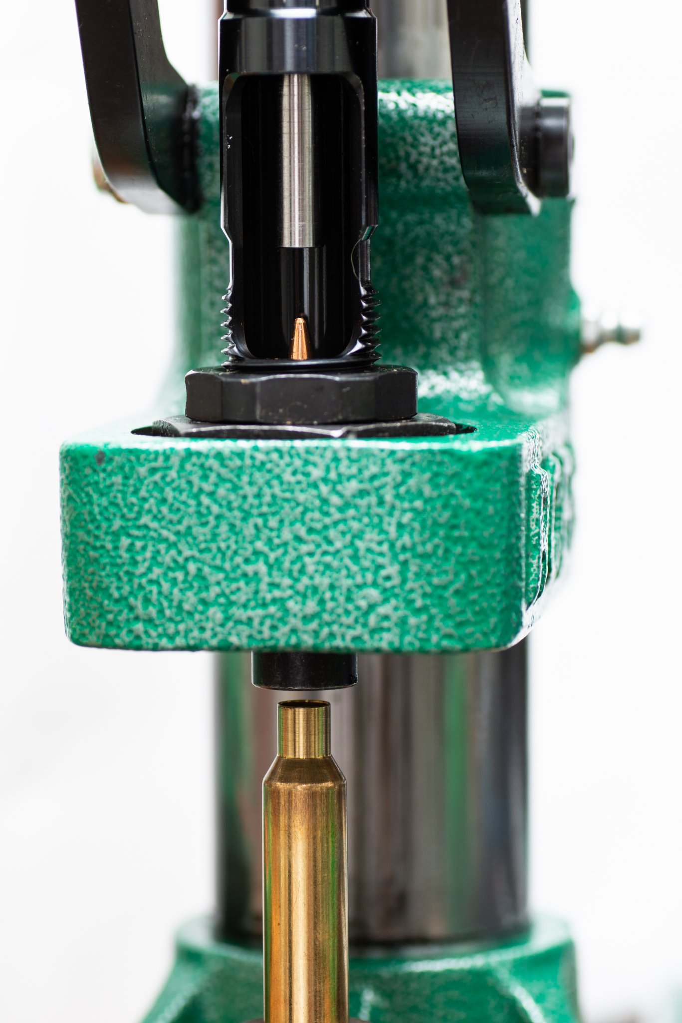

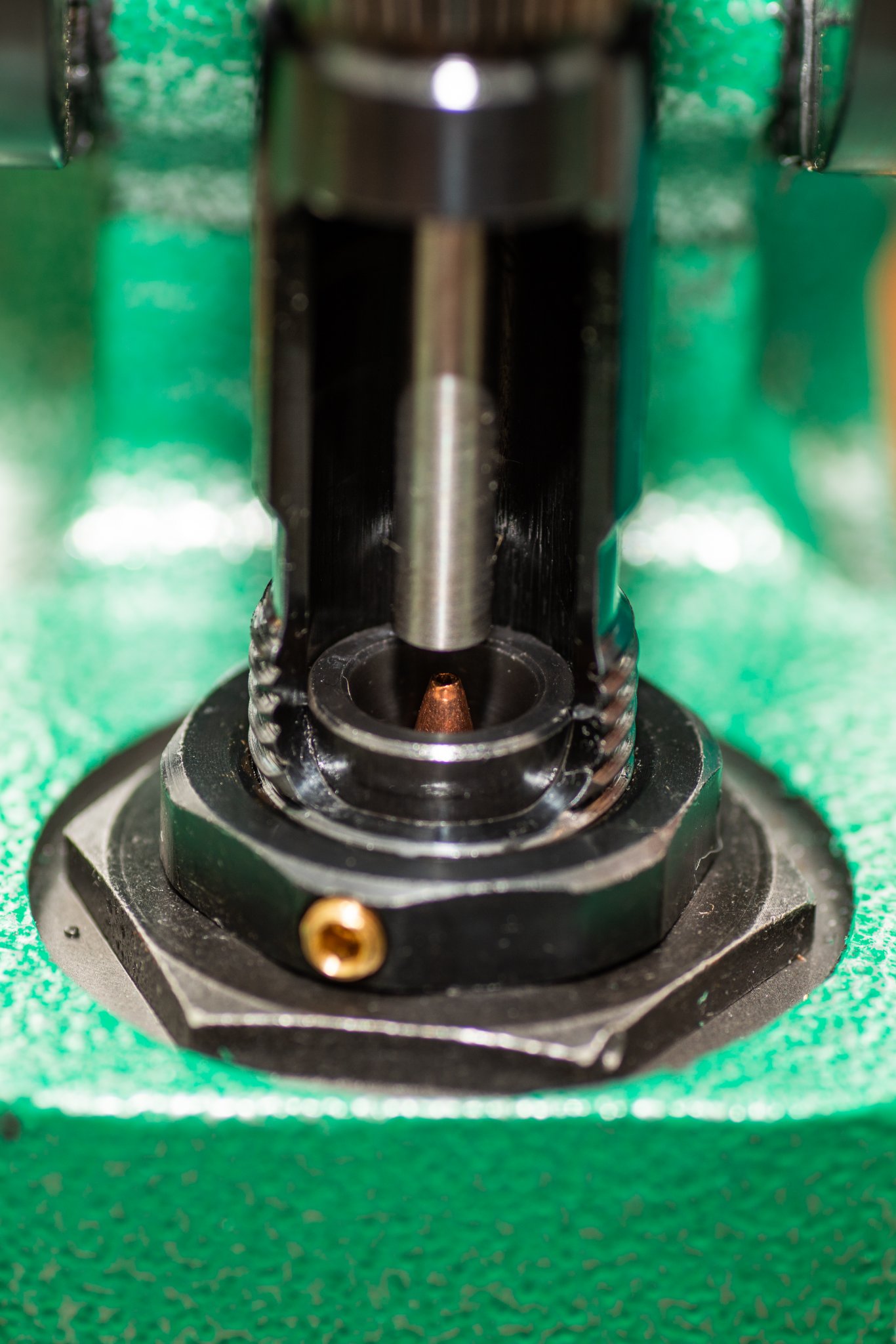

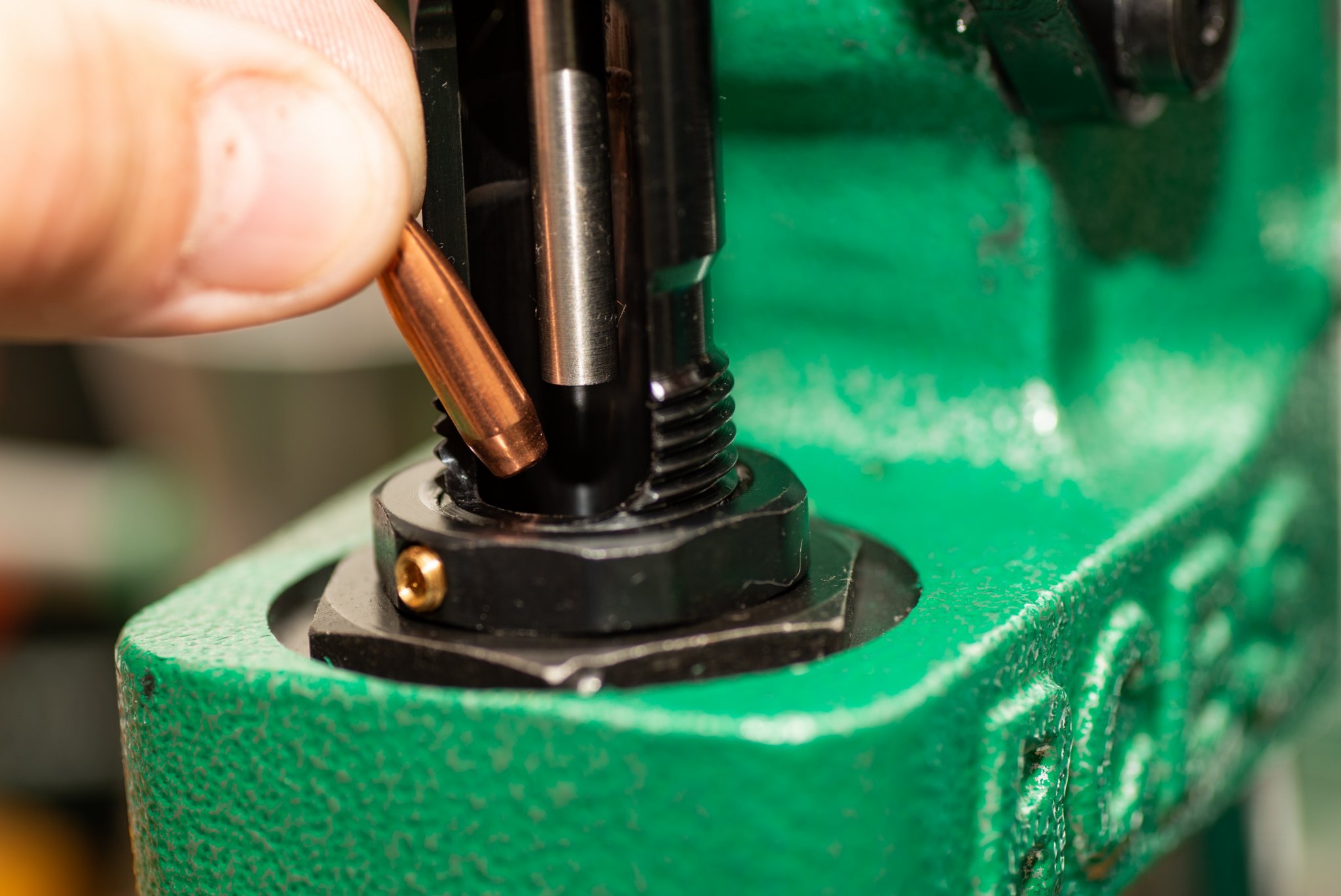

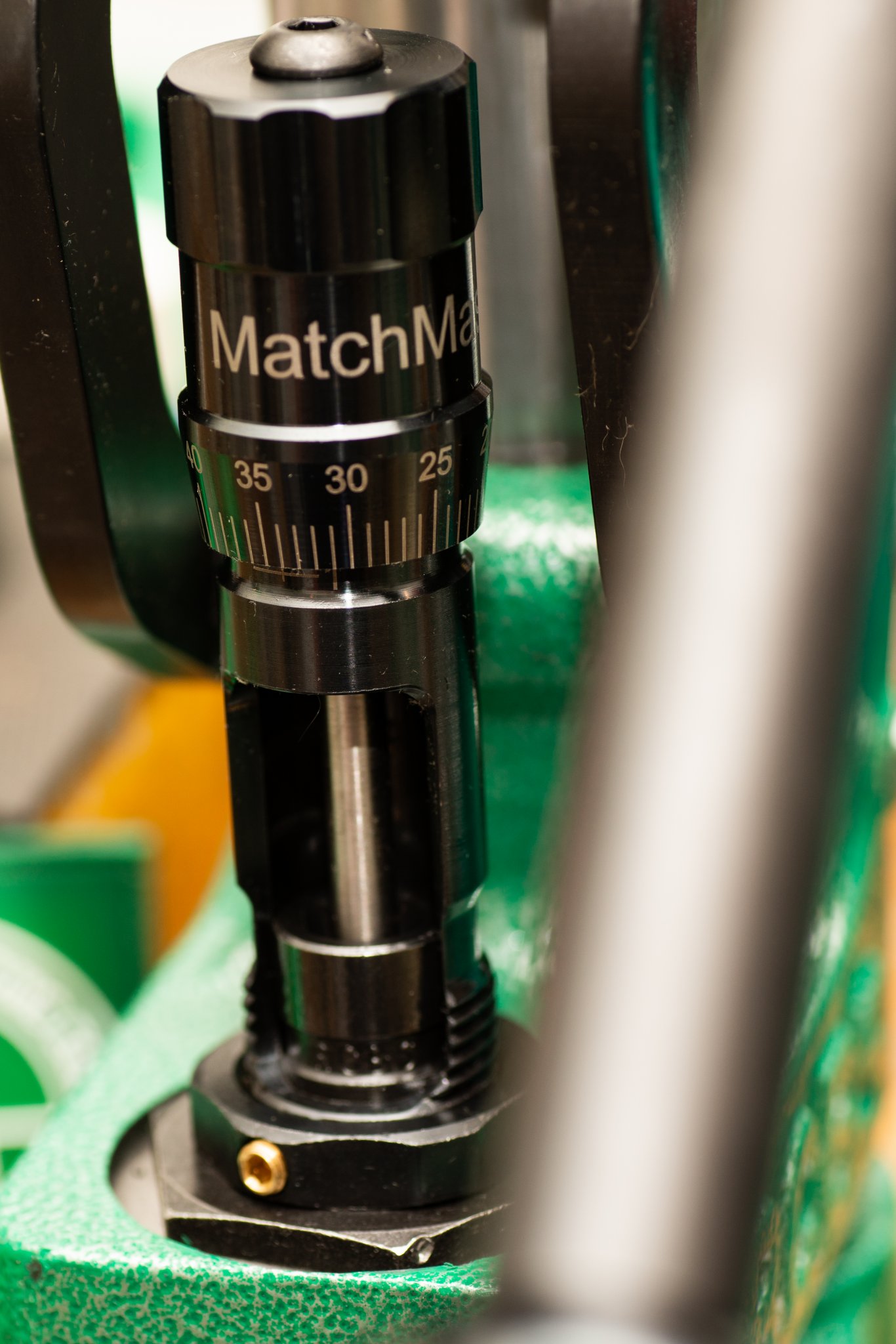

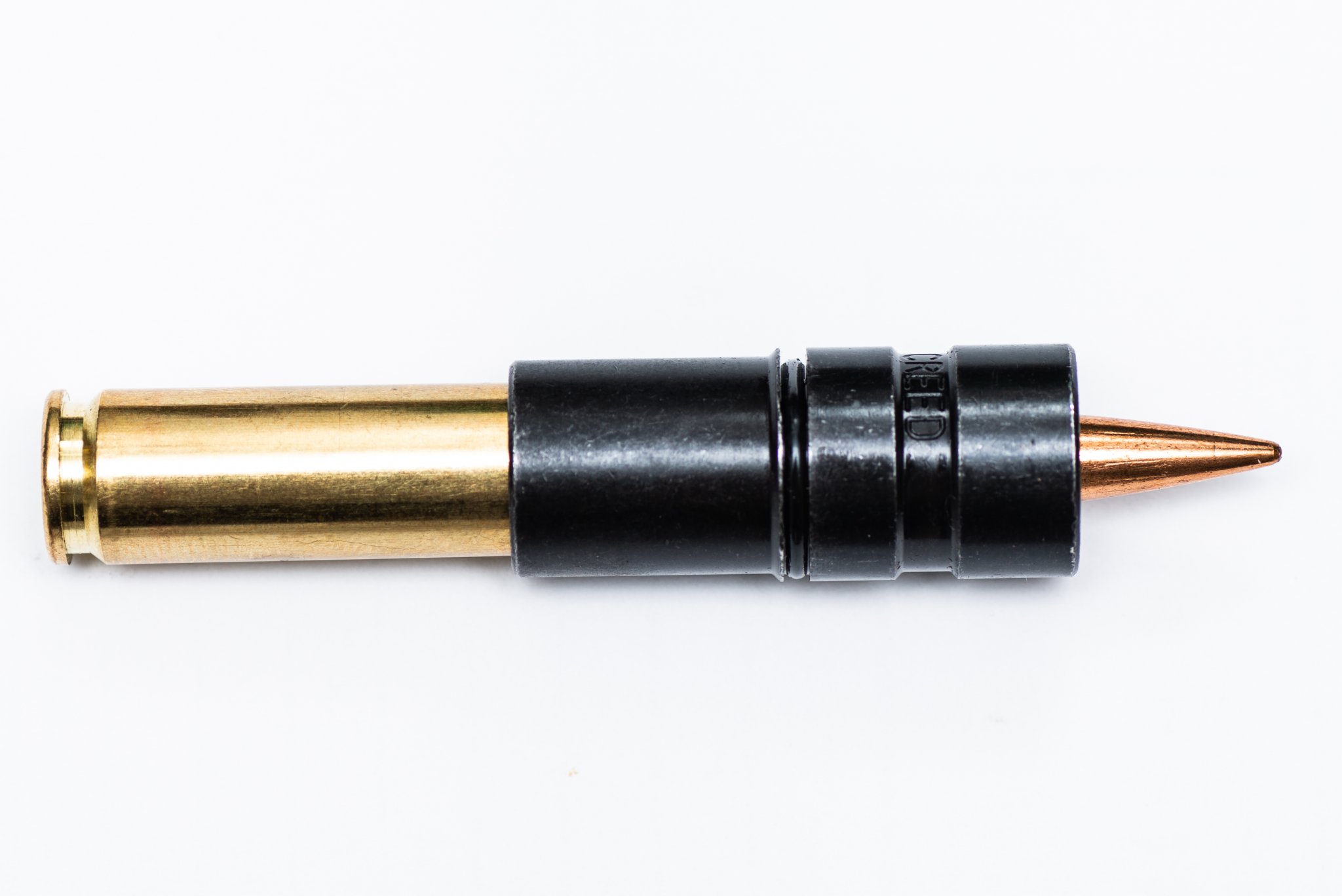

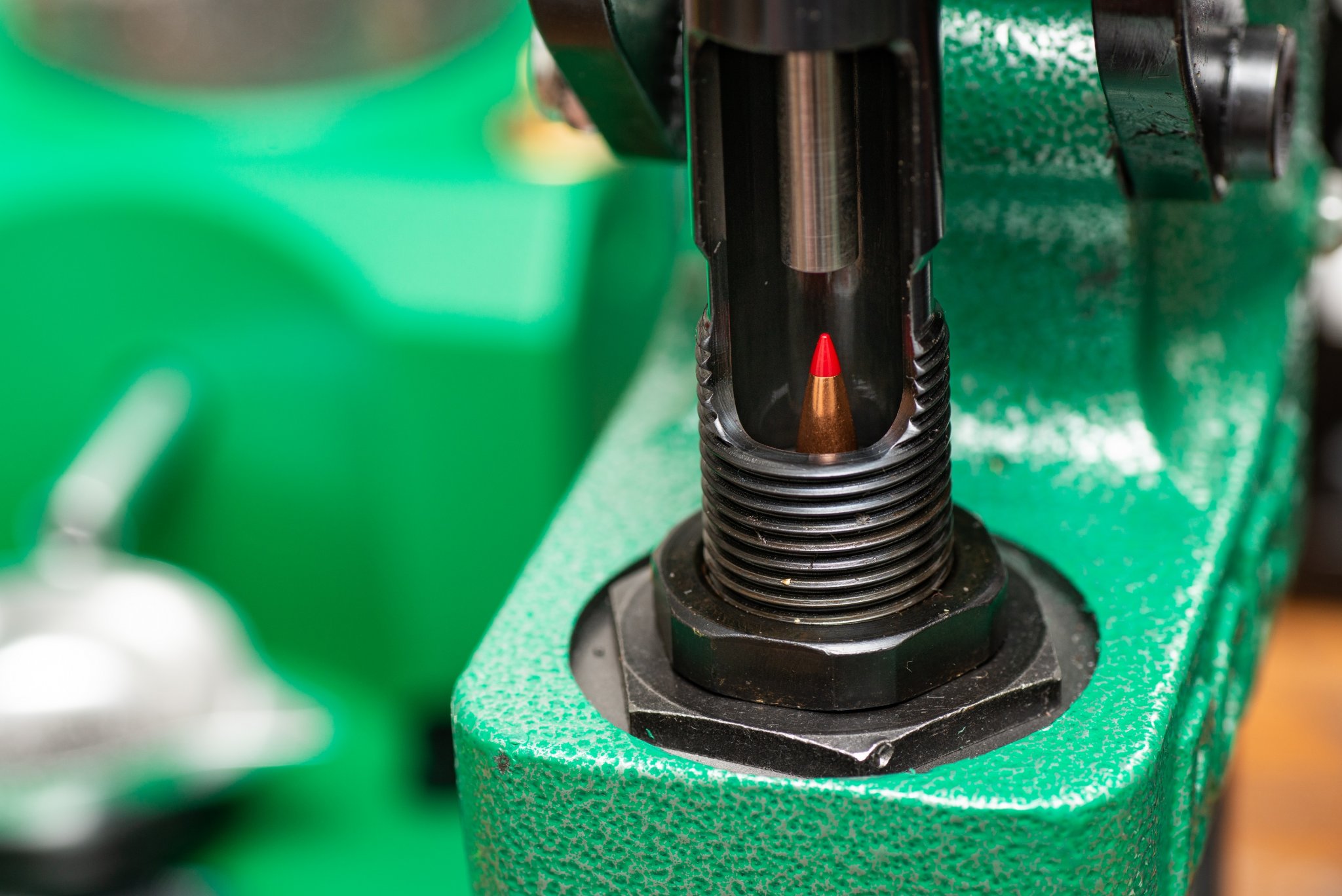

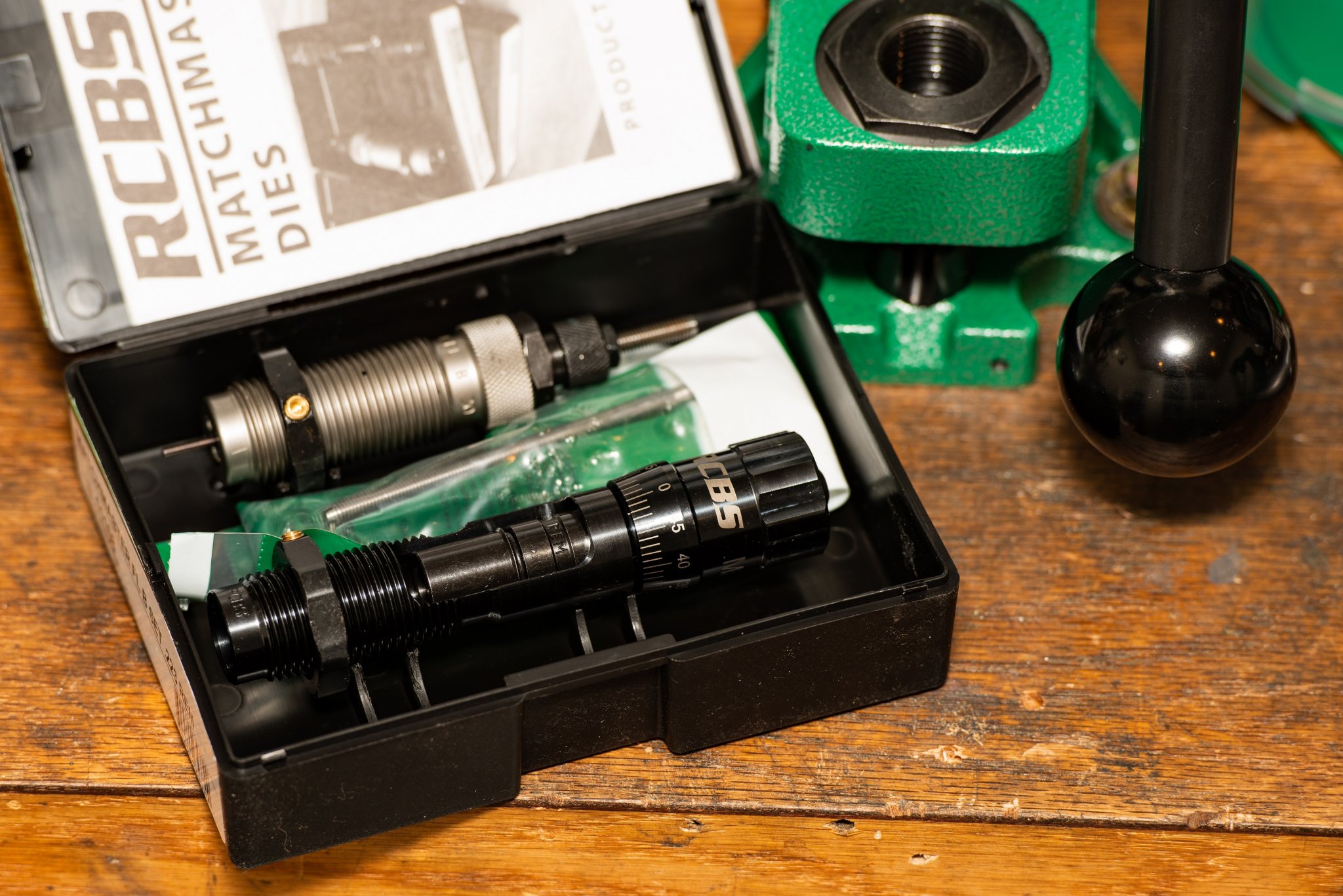

We're working on jazzing up the Matchmaster die product pages right now, but I can give you all some sneak peak images we're looking to put up to show these dies off and how they work.
If you have other questions on them give a shout. I'll try to dig up more pictures.
