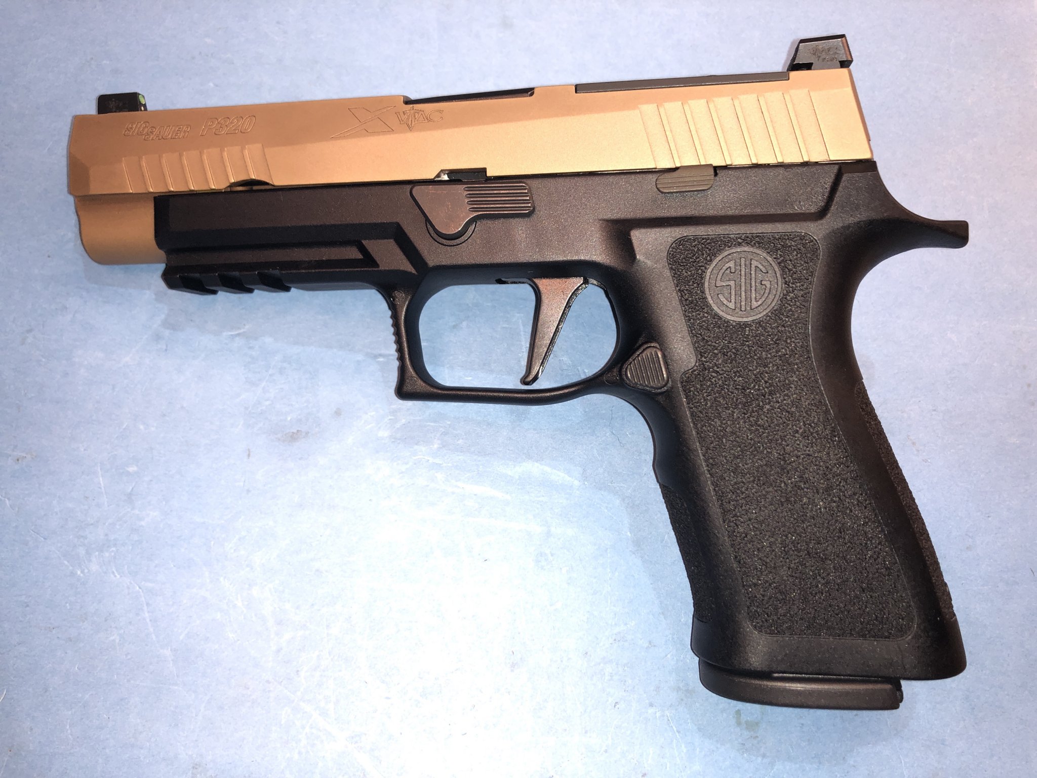

    Im Bi-curious..........thinking of adding a red dot sight to my iron sight inventory.
    Just bought this....I want to set it up for training, occasional CC use.
    RDS ready and I understand it will have the ability to mount Sig, Leupold and Trijicon products.

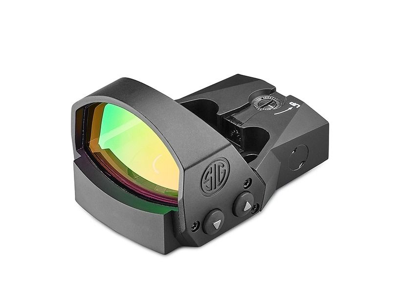

    Ive considered Sigs offerings.
    The upside...
    1. I can get a 10 percent discount
    2. Appears dot brightness is adjustable
    3. Batteries change topside
    4. They appear to back the product with replacement on any issue
    5. Looks like its trenched to co-witness with suppressor sights
    The downside
    1. Lots of people find they need a replacement.

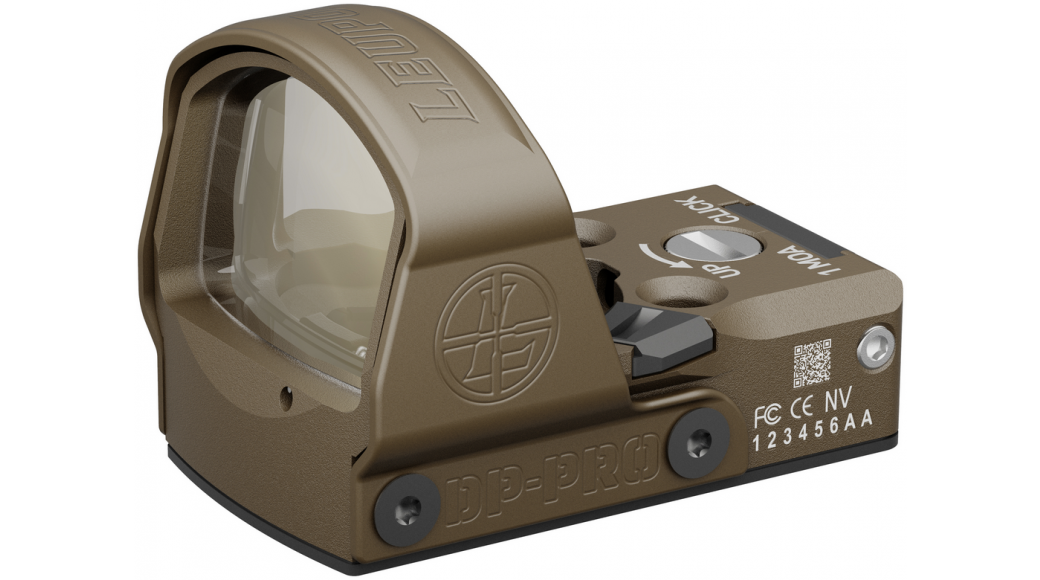

    Leupold
    The upside.....
    1. LEO Discount
    2. Parts made in USA
    3. Good CS
    4. Topside battery changes
    Downside....
    1. Perhaps I will need their CS at some point.
    2. If I want to adjust dot brightness its an extra $100 for the NV model

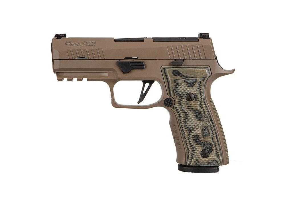

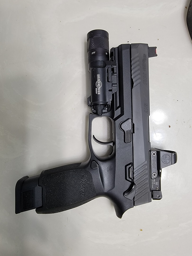

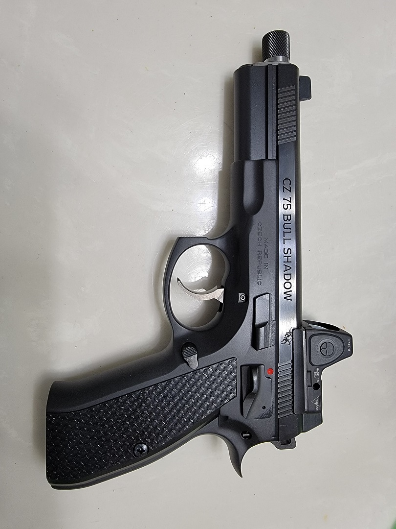

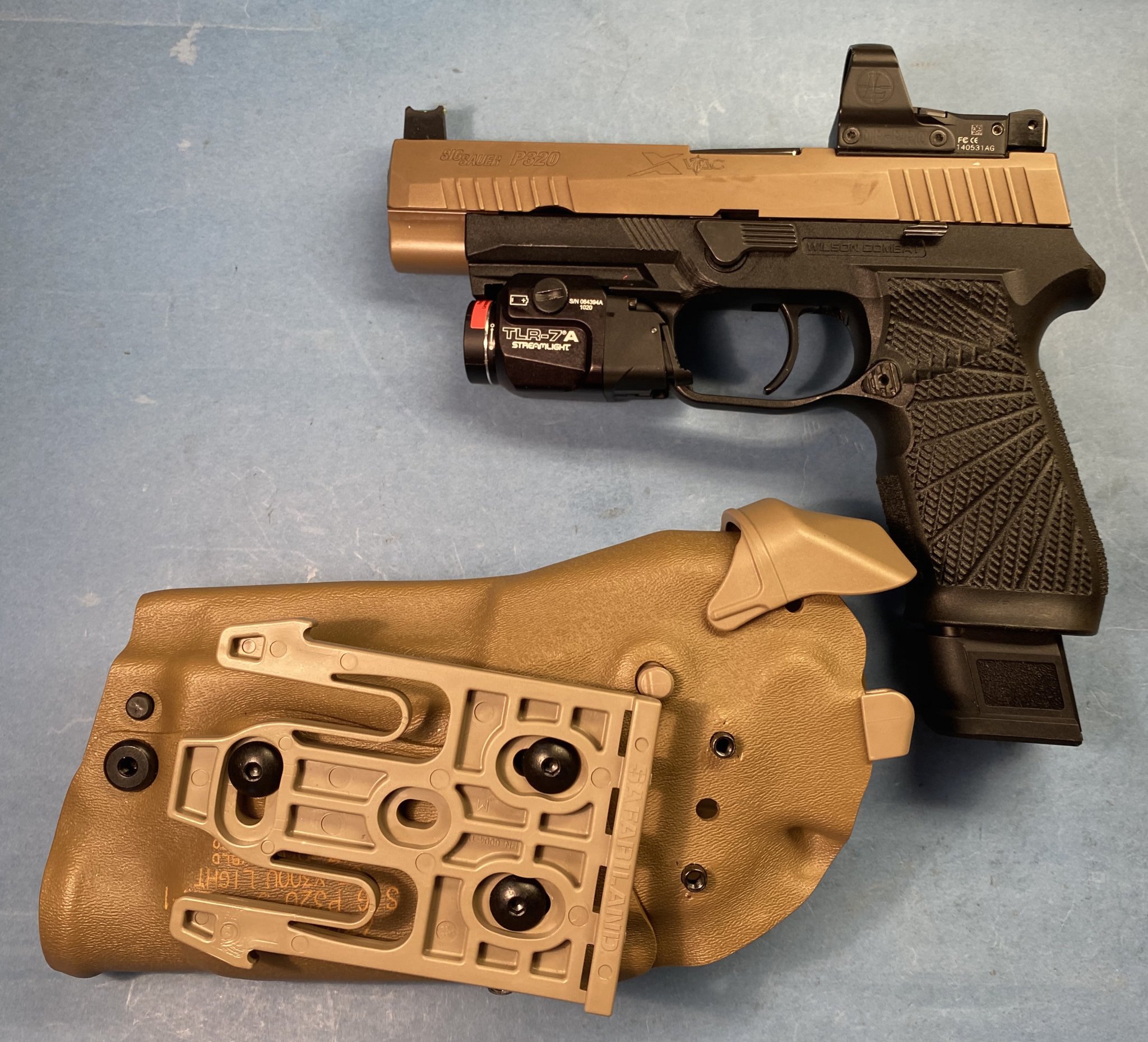

    Considering Sigs options....
    and judging by this picture appears they offer the X-sight version....
    Nice looking pistol by the way....sort of what I have in mind minus the threaded barrel.

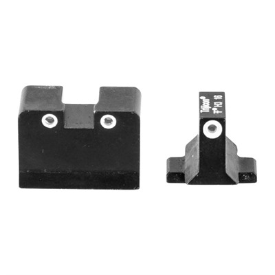

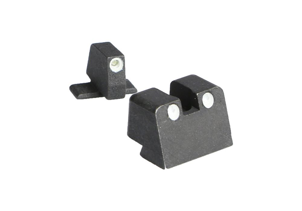

    The X-Sights and these Trijicons
    Appeal to me for the flared base on the front sight.

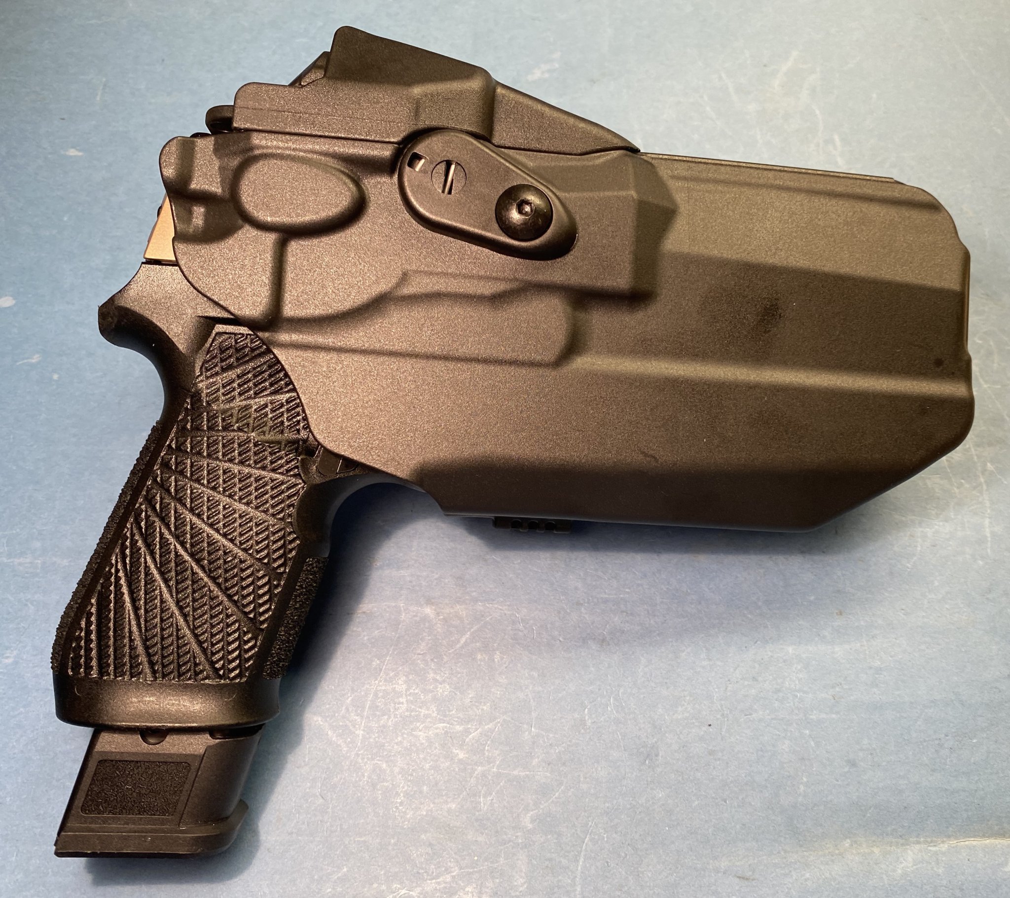

    Any experience out there you can help me make my mind up.
    Decisions here will decide my holster options.

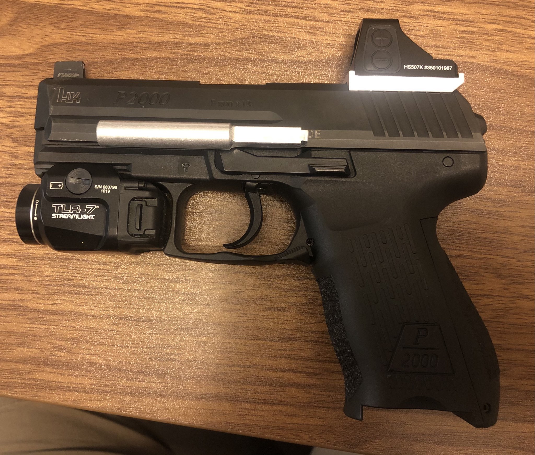

    I went with the Holosun 507K for my HK P2000. The HK P2000 slide can’t be cut for optics due to some asinine lightweighting cut placement, so I needed to make a decision for an adapter to engineer and stick with it.
    Decision factors:
    • Not made of plastic
    • Slide width or less
    • Since the adapter needs to use the rear slide cutout, I wanted to pick something with a rear notch
    • Short height to allow proper-height front sight (custom suppressor height, unfortunately) to fit into my holsters
    • Strong preference for circle-dot reticle
    This decision was made before the RMRc came out, and so far it works great, including after dropping it a few times. In hindsight I would have bought a different pistol in the first place (fuck you California) that could have slide cuts made (or buy a pre-cut slide) but I fell in love with the trigger 🤷‍♂️

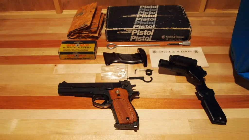

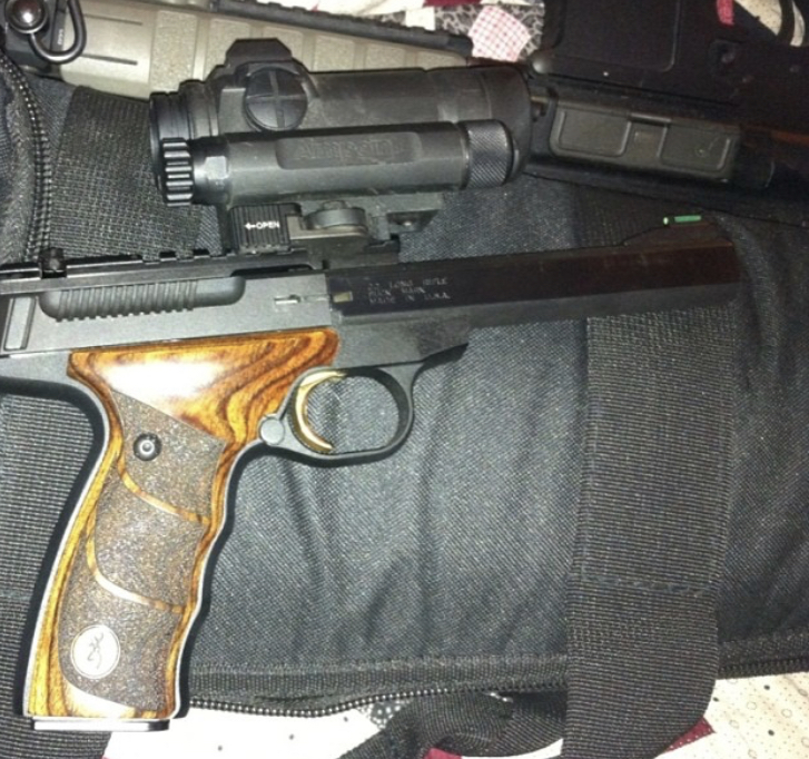

    My 52-2 came with an earlier version on a grip mount....
    I never tried this pistol with the Aimpoint because that level of accuracy would disrupt the time space continuum due to the stacking of 148 grn HBWC causing the lead pile to create an uncontrolled chain reaction resulting in the destruction of earth as we know it.
    Its almost criminal the former owner sold it in this destructive possession form whereby someone without my brains may have mated the 52 and the Aimpoint innocently enough and than unwittingly brought about the world destruction AOC continually preaches.

    Love the golden age laser/sight tech stuff.

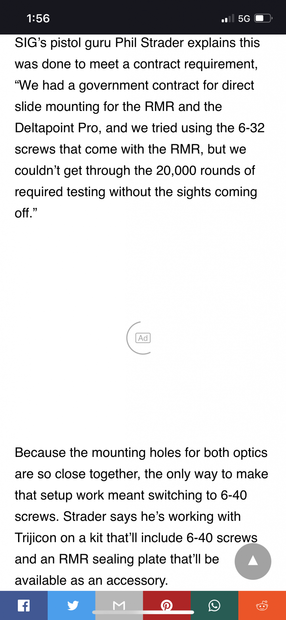

    Be aware the Trij mounting holes are threaded 6-40, and screws are included in the RMR kit.
    Assumed to be truth based on one article I read.
    Sig now has a base plate....more like a weather protection plate for the RMR gasket......I think it comes with screws.
    The RMR is the RDS I want for its reputation/quality but that requirement it be removed for battery changes.?

    My heart, if not my wallet, is beating for
    1. RMR
    2. Trijicon P320 Suppressor height sites
    3. Possibly the Sig Sauer P320 XRay-3 Day/Night suppressor height sights. I know they make them as evidenced in the picture above but they dont show on the sig Website.
    they didn't used to maybe, but here is a link. out of stock pretty much everywhere right now, but you can backorder.
    these were bought 25 years apart, but i added the rx slide afterwards, which came with the same.
    i run the same normal height sights on my p229 as well.

    Sig XRay3 vs Trijicon
    Sig Front Height 9.5mm/.374"
    Trijicon Front Height .914mm/.36"
    Sig Rear Height 10.59mm/.417"
    Trijicon Rear Height 8.96mm/.353"
    Do experienced users see a preference for one over the other.
    Gut instinct tells me taller is better assuming it doesnt impede the view of the glass too much.
    Am I overthinking the "co-witness" ability.
    On my rifle if I line up my irons the dot will sit on top of my rifle FSP.
    I never use it that way though, I might if I was bearing down for a tough shot.
    I want irons that are useful more so for backup if the RDS goes down. Something that if need be I can clear the shattered glass and continue to shoot.
    Edit - Screwed up the heights of the Trijicon "blades" originally. It now shows the useful measurement not overall height. So the Sig product went from being shorter to taller. I sent a question to Sig to clarify the measurement is "useful height" not overall height as they dont specify or show a schematic....

    well i am no expert, with only 2 years behind the rds, but i do a lot of dry fire (laser targets). i've had rds or rmr on rifles and shotguns for a long time, and for me the best part is both eyes open and focusing on the target instead of the front sight. especially with old eyes.
    since you mention the combat sight picture of the irons, i will say for myself, when i preset the rds i have the dot above the sights, while if i am using the irons, the dot in just behind the front sight (still combat picture). so not on purpose, i have a tiny tilt. not sure if that is normal. but i have no issues reverting to the irons in drills.
    one tip i would give if you have not tried rds on a pistol is do not look for the dot.
    i see people wiggling the pistol trying to bring the dot into the picture.
    present the pistol just like you are used to with iron sights and the dot will be there.
    Maybe an unpopular opinion but I really dislike suppressor height or taller sights co-witnessed with a dot, especially an RMR. The tall sights generally take up a considerable amount of field of view through the glass and it makes shooting the dot more complex for you eyes instead of easier.
    I prefer a “low-witness” set of sights that are maybe 1/16” above the optic. Leaving maximal room in the optic for your eye to observe your target through, uncluttered; making it easy to superimpose the dot. Then if necessary, you can still get a usable sight picture via irons as a secondary. Letting your back ups be backups…not a “partial primary” and ruining half the benefit of shooting a dot.
    I have also seen pretty much every optic break, to include an RMR. Regardless of ratings and tests they can all break, so get the one that’s generally reputable but also very easy to shoot. Because a DPP or SRO is so much nicer to shoot than an RMR. That being said my issued pistol dot is an RMR and I don’t complain. Lol YMMV
    My preferred sight picture with a dot. Big, open window, sights just barely there but still usable if I had to. This is my CO gun, Vortex Venom with TTI fibers.

    meh, i suppose as somebody else said, some are really high.
    i don't find it to be an issue, but then i also don't have the latest greatest. mine looks like this.

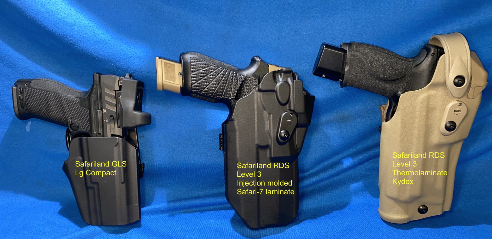

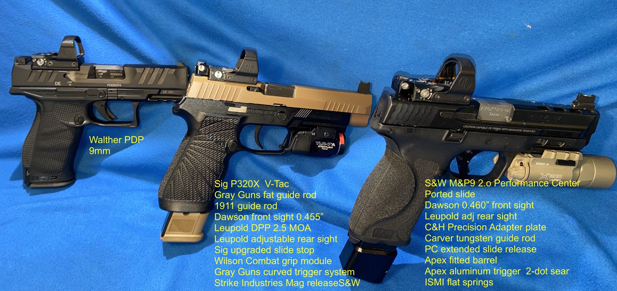

    I use Delta Point Pro's on these three and some RMR's on Glocks.
    Like a pair of shoes you need to try them on, wear them, decide what works for you.
    Virtually of the quality mfg's will provide a durable optic.
    When it comes to cost, nowadays a single 1000 round case of 9 mm costs more than the most expensive red dot!, kind of like buying a printer and finding out the cartridges will equal the printer cost after two changes.

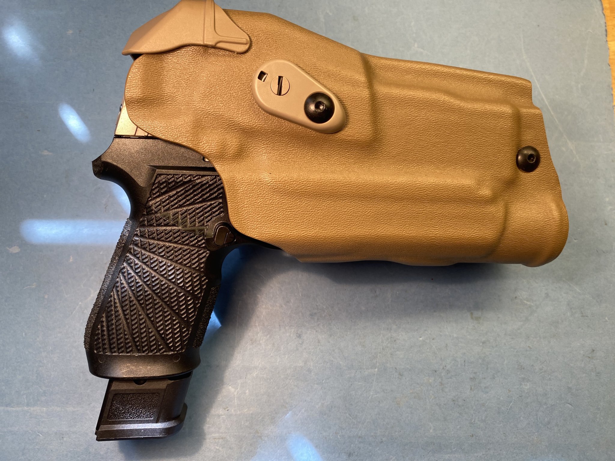

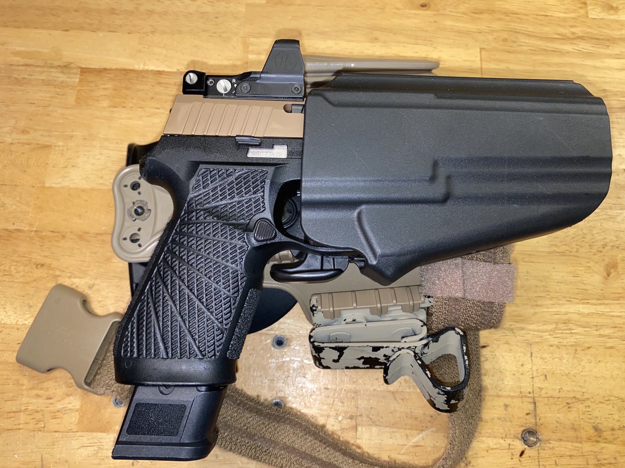

    I use Safariland holsters almost exclusively if available.
    The GLS style works with optic mountings. IF you need RDS protection the Safariland RDS choices are solid kit.
    The Leupold adjustable height rear sight is a must for any co-witnessing ambitions, mostly lower 1/3 with tall Dawson front sights.
    The original factory sights on the X-VTAC were ridiculously low for a optic-ready slide; the beaver tails on all the modules way too prominent for quick holster indexing.
    This poor soul was born a X-VTAC with little to like about it.
