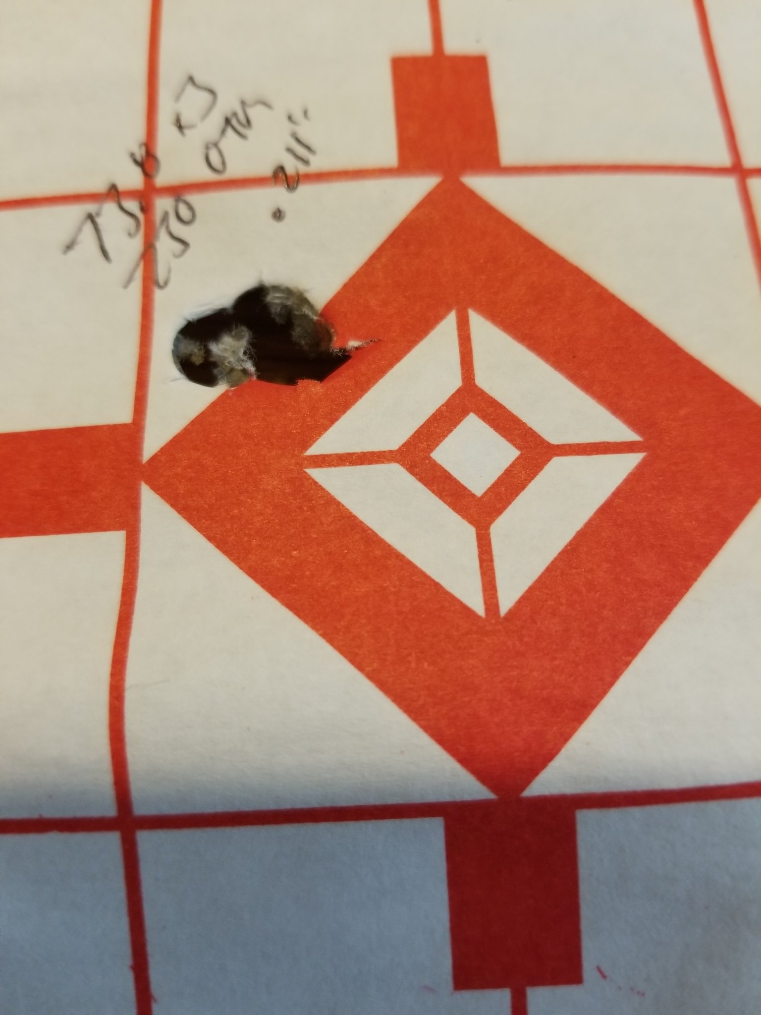

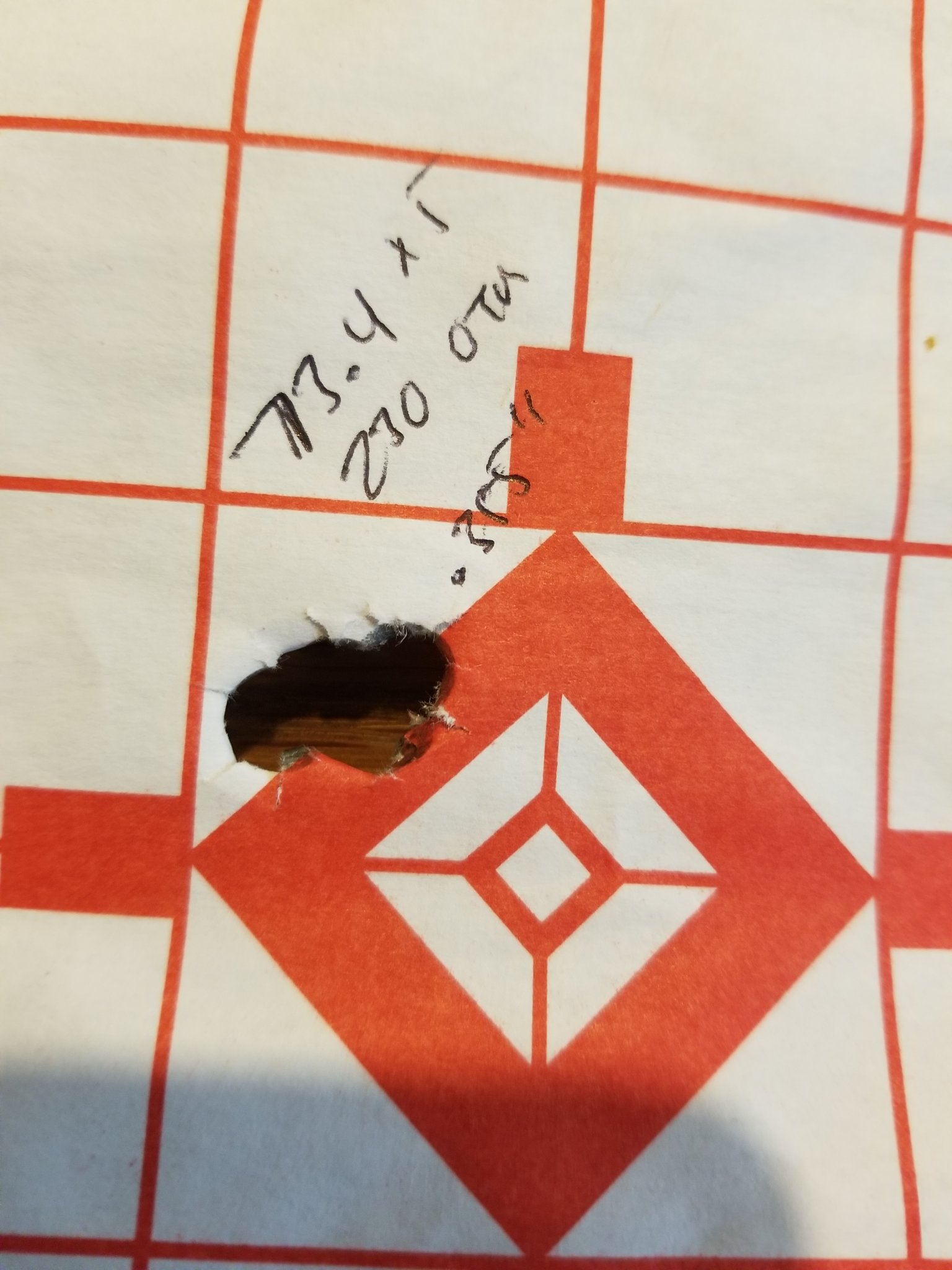

I have a Douglas premium on my 700/300. Did this two weeks ago load testing new ADG brass under 230gr Berger OTMs. I generally cannot shoot a magnum this well, especially off a Harris bipod in the dirt. Lots and lots of great barrel makers out there now, but I wouldn't be scared to look at some old school barrels either.
