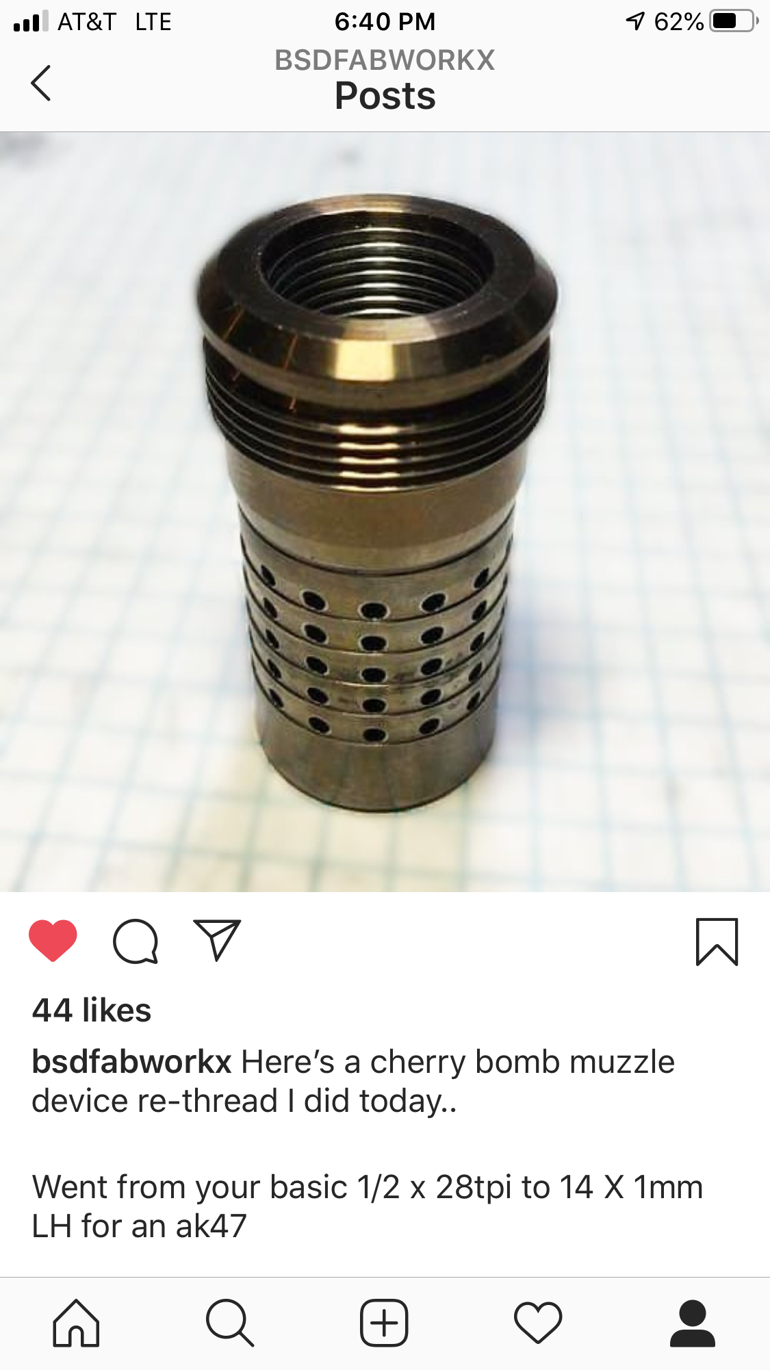

There’s a guy on Instagram that did just that but LH to a 1/2x28 Cherry Bomb to mount on an AK. I don’t know the specifics but he did it.

What more details are you after? He does it
Oh my bad I thought the manufacturer did the suppressor re-work and the CB/instagram from was someone else. all done by ECCO copy. can't read the picture of the CB on my phone and don't do social media just wanted to know who to contact for rethreading CB
BSD fab workx is the guy who will rethread your cherry bomb, ECCO might do it as well but I haven’t got a response back from them yet on the matter. I am however on their wait list to re-work my AAC.
