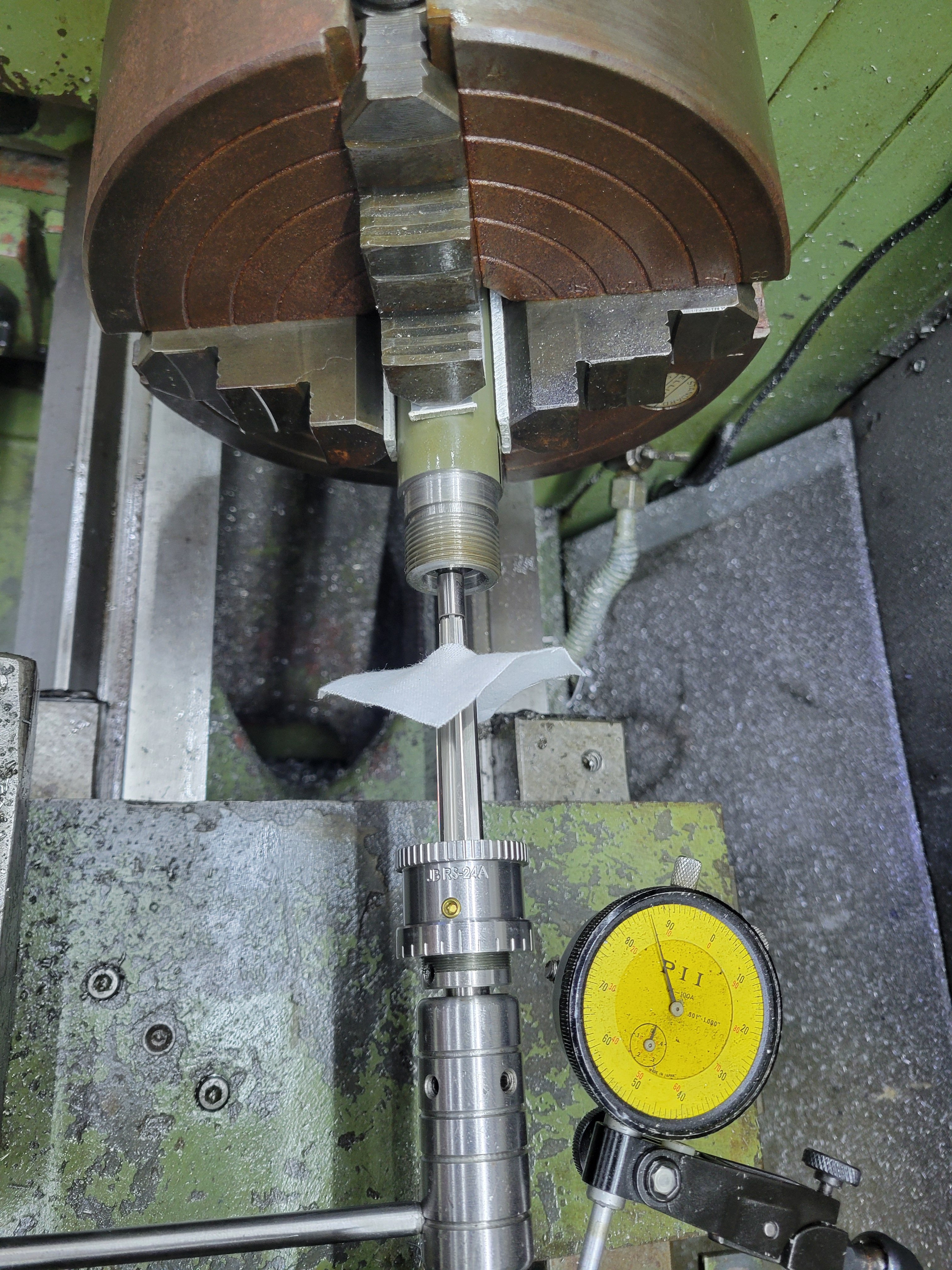

Some time ago I built myself my first rifle. Trued up my action to the best of my abilities and chambered my first barrel. It shoots pretty decent. Half moa is the norm with minimal load development, and it's shot a few in the. 3xx range.
The problem is, when I chambered it I got some reamer chatter toward the end of the chambering process, and I failed to notice it until I test fired it. It's very minimal, but you can feel it in the fired cases. And you can see it in the chamber now that it has a few hundred rounds on it. Probably more like 5-600.
But it shoots good so why mess with it? Well, #1 its not right, and it's bugged me since day one. And I think it's probably going to lead to erosion in the neck due to it not sealing like it should when fired. And #2, probably the main reason, I want to learn how to fix my mistake.
So here's where I'm at. Long ago, the smith that used to due my work for me, may he rest in peace, had told me he had one chatter one time. He had called brownells and was talking to them about it and they told him a process to follow to get it to clean up.
He said brownells told him to take a cotton/flannel cleaning patch and fold it in half and make a small cut with a pair of scissors in the middle, and to slide it over the reamer to the neck/shoulder junction and take a light cut. Repeat the process until it cleaned up. He said he only had to do it once. I forget the depth of cut he said he took.
So that's where I'm at. Am I headed down the right path ? What spindle speed should i run ? I'm here to learn, feel free to tell me if I'm screwing up or if there's another way I should go about it please let me know.
I already moved the shoulder, the breach face, and the bolt recess forward .062" and my witness mark on the barrel and reciever lined up perfect.
Also, I picked up a reamer stop off of LRH, and before I moved the shoulder and everything forward, I slid the reamer in and adjusted the stop to the breach face. Then I added .005" just to make sure I didn't go too deep.
Here's the setup.

Thanks for chiming in. Based on what you said above I'm going to say inadequate tool holding combined with the brand new reamer and my lack of experience is what got me the first time around. And quite possibly a machine that wasn't up to what I was asking of it.
This evening when I got home from work I went ahead with my original plan with the cleaning patch. Soaked everything in vipers venom cutting oil and made an .010" deep cut. You could feel the chatter in the reamer and then feel it smooth out as it cleaned up. I then stopped the machine pulled the reamer out and blew everything thing clean with air and inspected my work.
It looked to be going in the right direction so I repeated the process once more. This pass felt clean from the start. After that I took two more passes .020" at a time and finished with a final cut .003" deep. Final product came out nice.
Based on what you said about the depth of the final cut I will plan it out in the future where I have .005-.010" left at the end.
I assembled the rifle and test fired it and the brass was perfectly smooth now and the neck seems to have sealed off much better. As it should be.

The machine that originally chambered this barrel a a jet 1336PBD. Late 80's Taiwanese bench top machine. Fairly heavy for what it was. It built a lot of good rifles before I got it.
I sold that machine to buy my current lathe. This one is a profit master. Made in Brazil. 14x60. Knew the previous owner. It built three of my own rifles before I owned it. This it the first chambering job I've done on it. I did make a short dry run on an old barrel stub before I went ahead with this one.
Originally I chambered the barrel at 60 rpm. The slowest the jet would go. This time I touched up the chamber at 63 rpm. 2nd gear. 1st gear on this one is 40. The next option would be 100. Or faster if you prefer.
I did not pre drill and bore the chamber. There seems to be varying opinions on this. Some do, some don't. Out of the three people I know personally, or knew, that do this kind of work, none of them pre bored, and only one had an issue one time that I know of. I go slow and take it easy. About .025-.030 per cut. It's time consuming, but many do it this way and it seems to work. One of these days I'll build a pressure flush system. This lathe has a built in pump but it's not working currently. I need to dig in to that.
I'm fairly certain what got me the first time around was my reamer holding setup. I built a rigid holder out of a mt2 tailstock blank and I don't believe the little jet was up to the task. This time I used a bald eagle floating holder.

Pre drill your chamber and bore it till it’s .010 ish under smallest diameter of reamer and I bet you never have chatter again. Plus your reamer will start into a hole that’s been single point cut thus making sure that your bore is concentric at least to the spindle, and if you did your job also to the indicated point in the barrel. If I start a reamer and it chatters at all I’ll pull it out and take a few more thousands with the boring bar and it cleans right up. I’d do that before I put a patch or papertowel in. I also buy rigid dark by the 5 gallon bucket and use it like it’s free. You’re asking a lot of your reamer to basically run as a drill through 416r stainless when a good set of bits can be bought for 100 dollars and if you wear one of those out just go a size down and bore more.
I might give it a shot on my next one. I'm always down to learn a better way to do things.
The fella that trained me went full reamer I learned pretty quick it wasn’t for me
Question on pre drilling. Do you go just deep enough that the pilot will still engage the bore, or do you not worry about the pilot?
I've always been told a reamer will naturally follow the center of whatever hole it's started in. As long as there are no opposing forces pushing it off center. If that's the case, why is there a pilot in the first place ?

The pilot is just there for a guide. Yes a reamer will try to follow the hole even without the guide. Regardless if you use the pilot or not, using a stationary holder that's not truly lined up with the work piece, you might end up with a finish that is oversize, not concentric, chatter, etc. A lot of gunsmiths opt to use floating holders for their reamers to mitigate that. But floating holders come with their own set of quirks as well, they're a solution for some, but not an end all solution.

The pilot will normally still reach the bore. As barbaric as it sounds I usually line my shoulder body junction up on the bit I’m going to use and mark my bit where the tapers on case and bit are similar and about .050 from the case base of my go gauge just to make sure the shoulder portion of my reamer as plenty the clean up. The important part to me is a concentric single point hole for my reamer to follow.

I might give the prebore a go on my next one. I've got a 6mm blank in the shop now that is probably going to end up a 6 dasher. It's got plenty of shank and it's a short case so if I screw it up I can probably still save it.
I reamed many thousands of holes.
The reamer will follow a drilled hole.
The reaner needs to be sharp.
Slow speed, with a decent chip load per tooth, with enough material left to actually have a decent chip load.
Always bore the drilled hole a ways down to get a true centered start. The hole has to be run true.
All holes are out of round especially drilled holes.
I Don't get chatter in reamed holes.
Never used a rag or paper in the hole with your reamer, a really bad idea, you just introduced a variable, with no consistency or control on how the cutting will occur.
Don't ever do that!
No machinist does that ....really...and we get excellent reamed holes
I've reamed holes two and three feet deep on turrent lathes. Trepan or core out 6" diameters and ream hole. Reamers 5 and 6 ft long, same with boring bars.
Use lots of good cutting fluid or heavy dark cutting oil. Pumped in under pressure is best. But not necessary for a good reamed hole, it just slows things down.
Pilots are not necessary, but I use them chambering barrels...the only time ever, but always bore before starting finish reamer here especially in home shop lathes.
