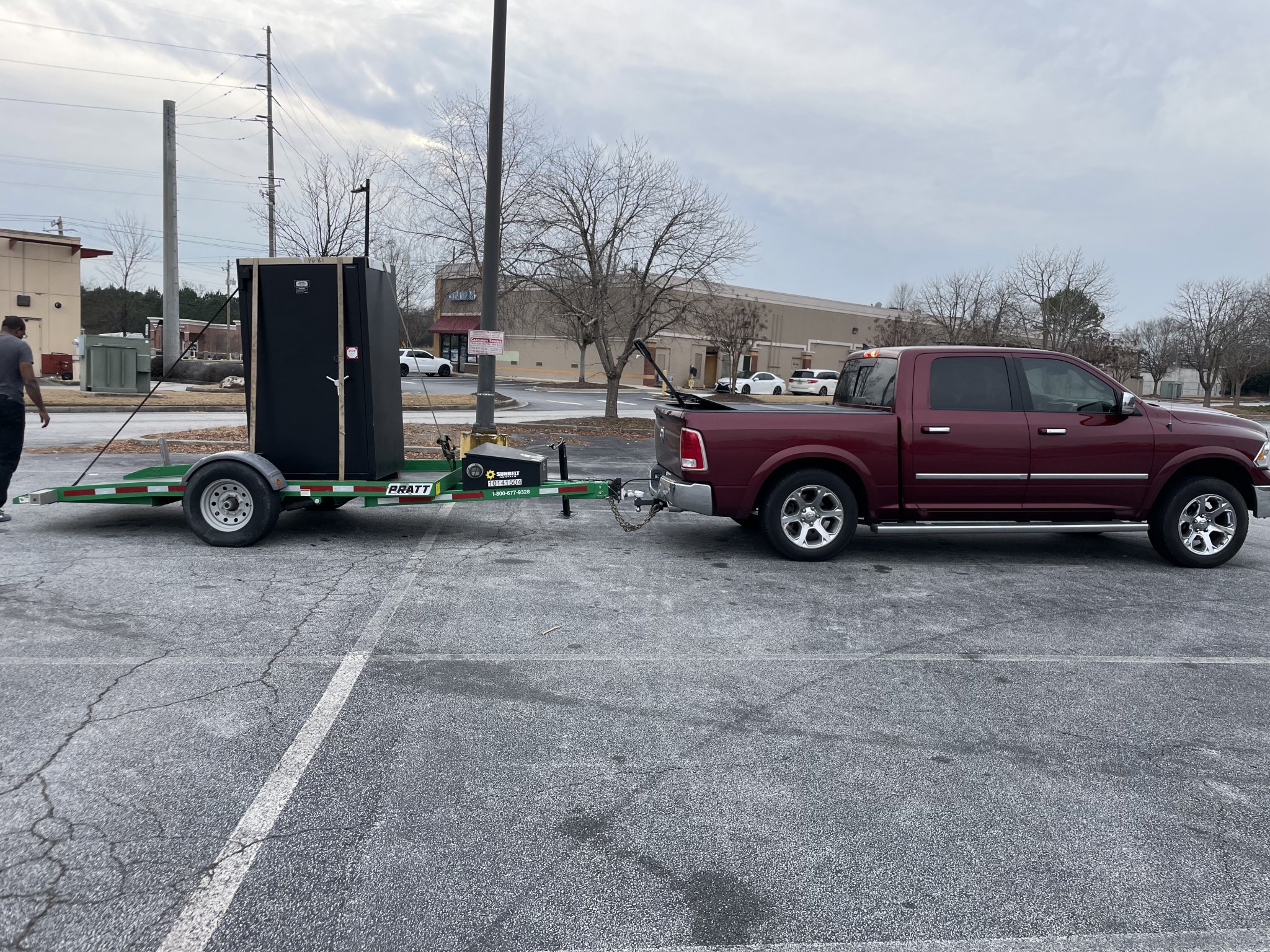

A perfect example of my point. A CFX703620 will cost you 20k, it weighs 4,500 pounds so you are very limited in where it can go. The safe only provides 29 cubic feet of storage, that’s very small. Fine for jewelry and cash and a pistol or two but if you have a number of rifles and other routine stuff you need to secure, it’s not going to work. I have two 65s, a 49, and a 33. I have a number of rifles that won’t even fit in a 33 let alone being stuck with only 29 cubic feet of space.

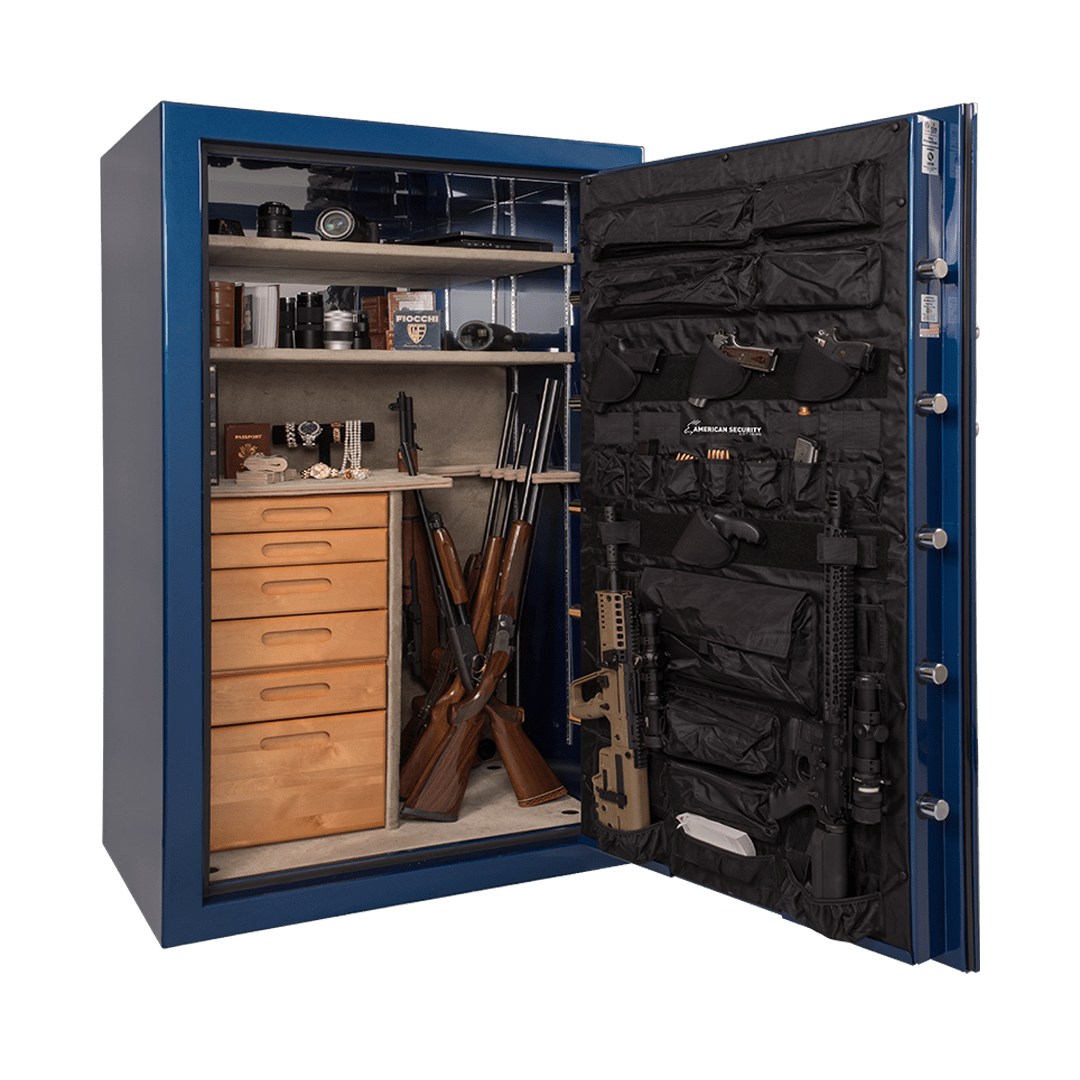

For reference, below is a picture off of AMSEC's site of a safe with 26cuft of space. The safe I specified above would be 10% bigger. The OP can decide if it meets his needs, but it holds more than "jewelry and cash and a pistol or two" by a goddamn sight. Also, the OP stated he wanted a heavy-ass safe based on the TL15/TL30 question, so I'll assume he's thought through where to put it.
Link to pictured safe:

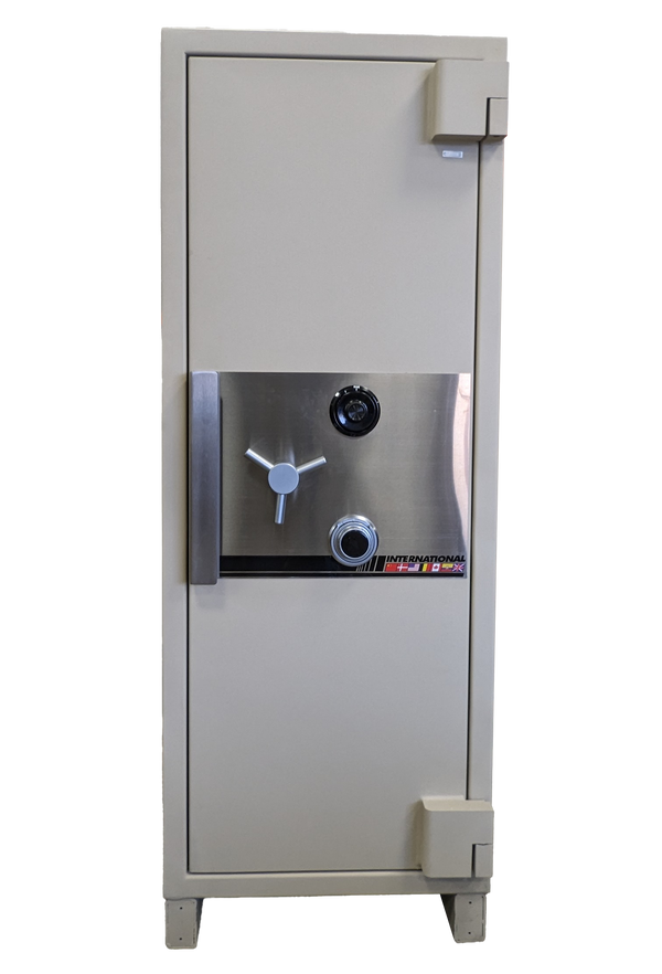

If you want a real safe, then buy a used commercial/industrial safe. It won’t be uniquely outfitted for guns, but they are legit TL or TRTL rated if you want to get loco. A little elbow grease will go a long way.
Otherwise you’ll pay a premium for a new safe that is TL rated and manufactured for guns.
this is an RSC 2 "safe", its also not comparable to the TL-30

To sum up, I provided some examples of TL-30X6 safes for the OP in the original response (#5). Someone then decided to debate their size, so I grabbed a pic of a RSC2 to show what 26cuft looked like. AMSEC's site doesn't have an internal pic of their TL safes with 29cuft for some reason.
I meant to clarify this by stating "for reference", but perhaps this wasn't sufficiently clear.
