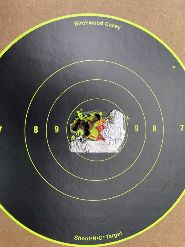

From what I have seen, a huge factor depends on the target. I would wrap a Battery in foil to short it, and shoot at the negative or positive end. That way, you have a smaller point of aim, making your grouping more consistent (Best way I have found). Shooting at something larger, such as a handwarmer, has never worked for me. Aim small, miss small👍

For the image below I was conducting a test of the accuracy of the Super Yoter 50 LRF. When testing thermals, I take 1 shot at base mag, 1 at 50% max zoom, and another at 100% max zoom. Next, I go back to base magnification and I NUC the scope and take a shot, and then I take a shot using PIP. The next step is to turn the unit off and turn it back on and take 1 shot. My last test is to throw an athletic ice pack around a thermal for 15 minutes and take one last shot. This was my result after all of that. The grouping would most likely have been even tighter if I had just kept everything constant and fired 6 rounds consecutively.
Other tips on using HVAC tape or foil, is tilt the target back about 10° as it helps see the target better. If doing it at night, shining a light source on the target helps.
