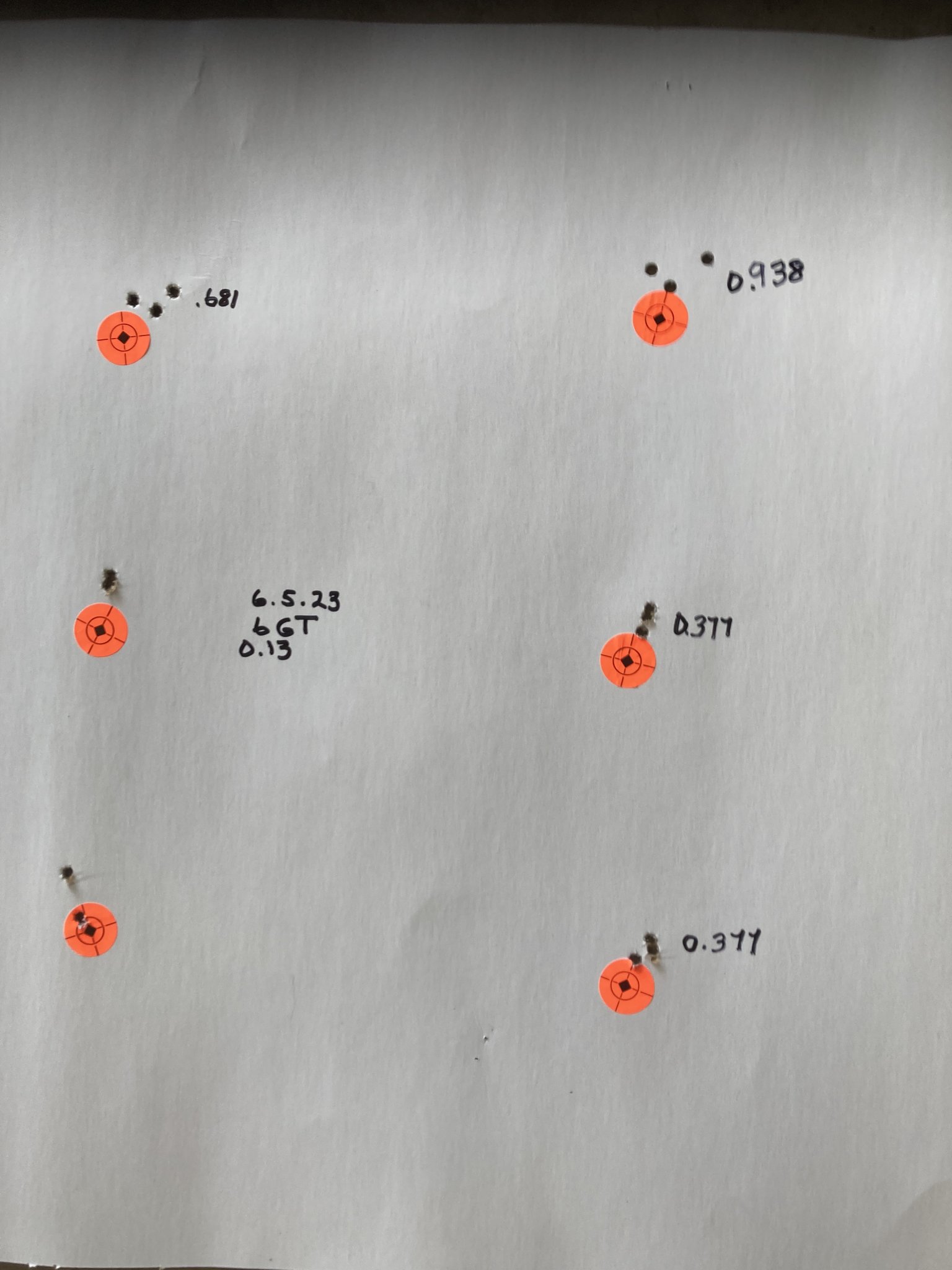

Those are cherry picked groups for sure but I imagine most of it is my lack of shooting skills. Almost every group I have shot today and the last week was in the VERY high .20s to high .30s. Shooting lots of .30s is what is frustrating me.
The 5 shot at .28 did feel good today though. Not gonna lie even though it isn't really the norm for me.

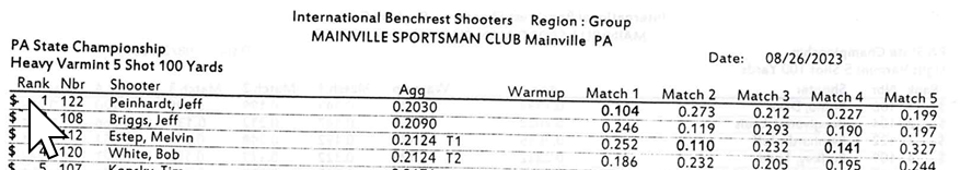

Let's check assumptions. These are results from the 2023 Pennsylvania state IBS match, 100 yard heavy varmint.
100 yards, 13.5 pound guns. I included Bob White because I remember that name from the past - waaayyy past. Look at the match results for the winner - three of them are in the twos, match 5 is .199. Jeff's match 1 was small group for the entire match. Match 2 is .273.
These guys are shooting from a heavy front rest that fits the rifle fore-end and a rear bag with heavy sand. The front rest is adjusted to put the crosshairs on the point of aim, you don't touch the gun to aim. The gun is shot free-recoil. The shooter is sitting on a stool, the rifle, rest and bags are sitting on a concrete bench. Prior to the match, the shooter placed three to five wind flags between the bench and the target. There are dozens of wind flags on the range - if you are in the middle of the line, you can see a condition change coming. The target has a record section and a sighter section. You can shoot as many times as you like at the sighter - you have to put 5 rounds on the record target - there is a moving backer to confirm 5 shots. if you want, you can shoot sighter, record, sighter, record, and so forth. There is a time limit - I recall it is 7 minutes.

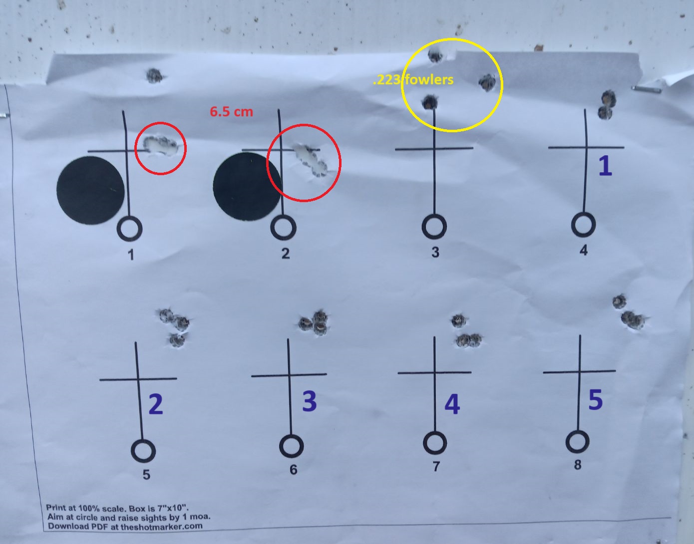

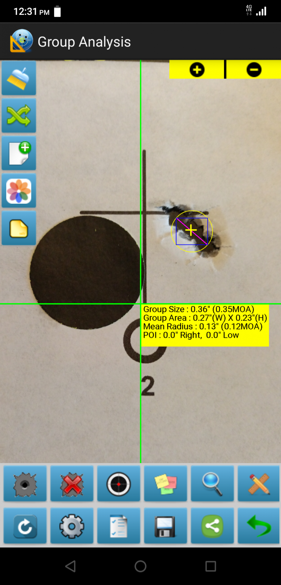

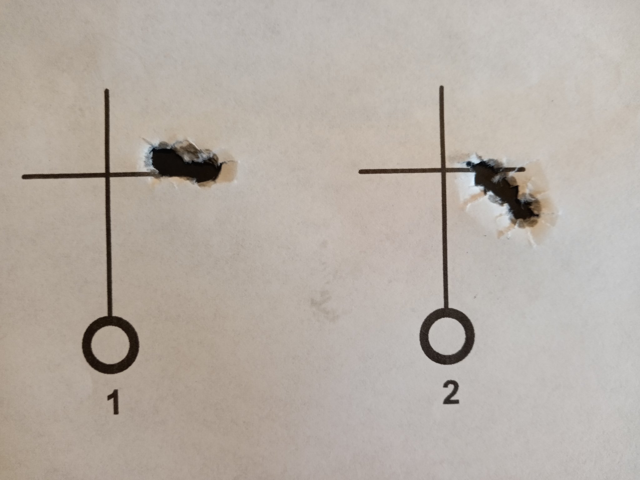

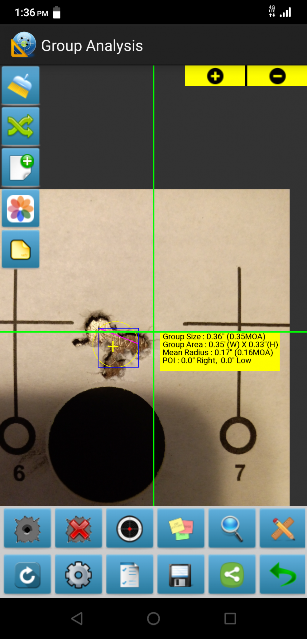

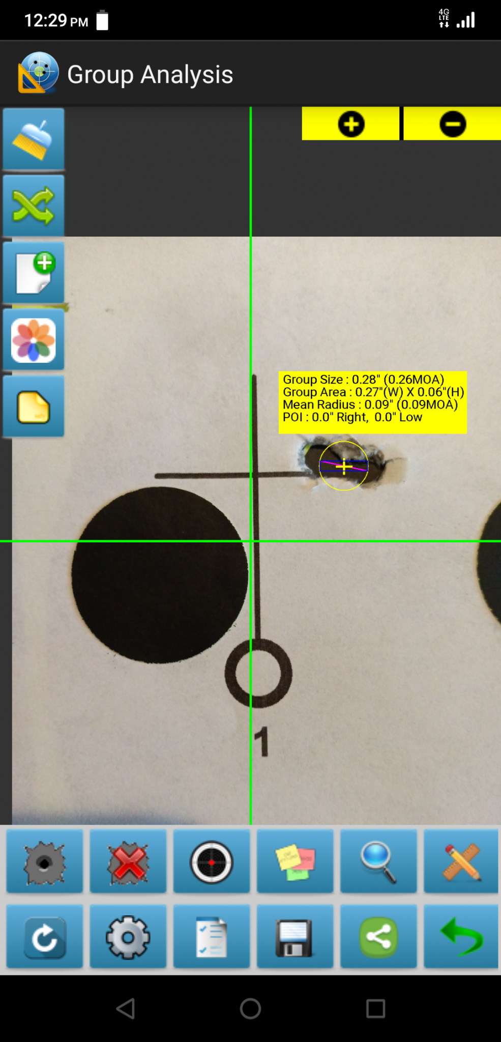

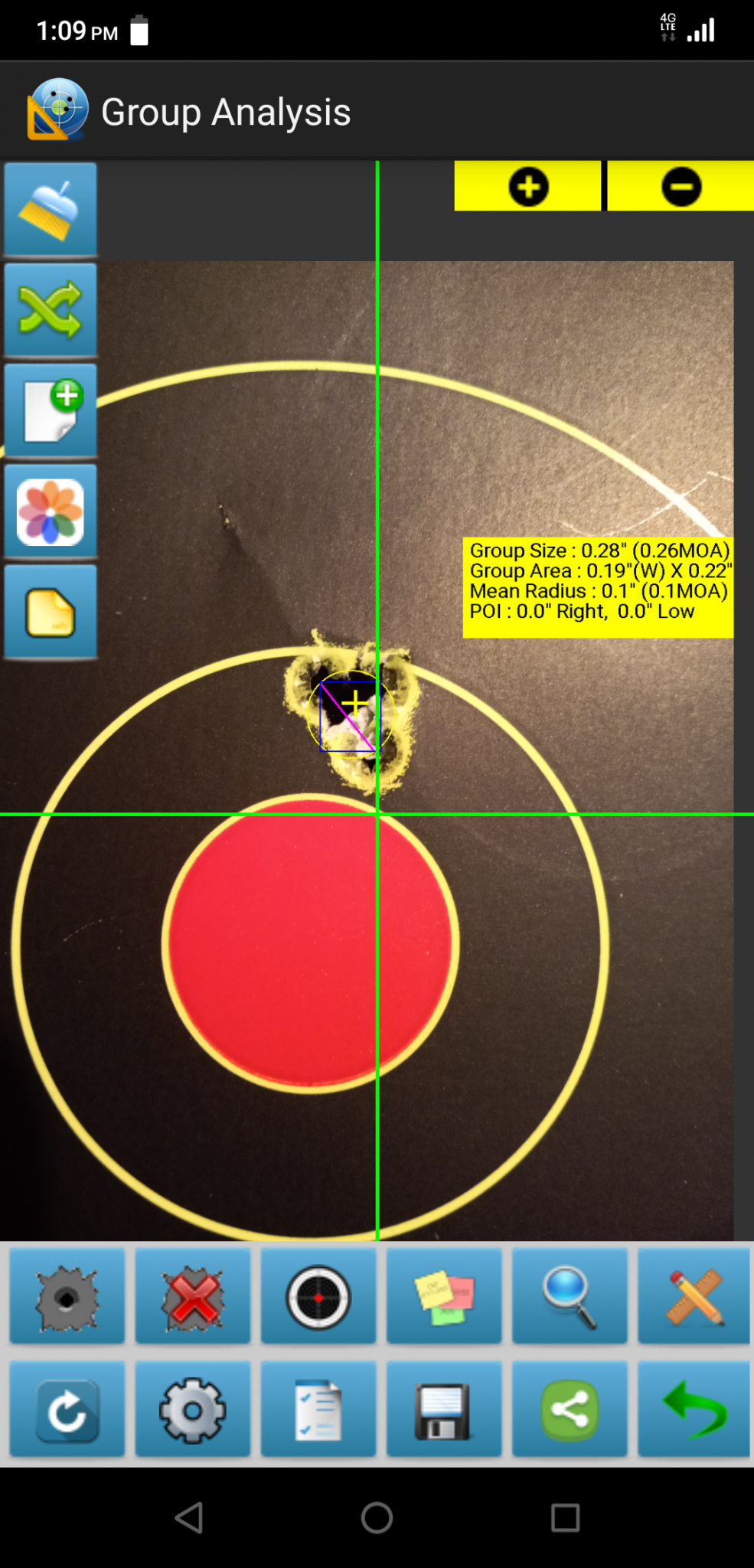

These (except for the last one) are the only groups I really shot with the CM last week and this week. The first one is from a set of groups for seating depth. I think I have a picture somewhere of the rest of the target.
The second and third are after i added 1" dots to be able to measure in rangebuddy. The last is just a 5 shot with the .223 and I didn't shoot any more at 100 because all the rest were having fun banging steel @ 200 except for one group that was at 200 yards to cofirm dope and that one was just a 3 shot of about .7 something i think.

the 223 is just for practice banging steel at 200 at our local club. The 6.5CM would be for some practice and matches

You should go to a benchrest match and look at the wailing wall. Remember, those are mostly 5-shot matches - unlimited matches are 10-shots. Half or more of the targets on the wall will have a beautiful 4-shot group in the ones or zeros with a flyer making the group a three or four. I used to keep mine until there got to be too many. Those targets remind me that weather happens and every shot is independent of all the others and I have to focus on fundamentals for every shot. I have this problem when shooting targets at 1k. If I do my job, there is a 1-moa target that I can hit 5 times in a row. If I don't focus and do my job or if I become fatigued, that target kicks my ass.
Since you are not competing (or getting shot at), you don't have to convince anyone how well your rifle shoots - that is strictly your affair. But when you are comparing what you get to what other people get, you need to shoot the same number of rounds on the target. Most of us shoot 5-shot groups to sort brass, bullets, powder charges, primers, seating depth, neck tension, shoulder bump, and other stuff.
If you want a group size number that you can use for predictions (what is the probability that I can shoot an X, or a deer, at 500 yards), you need at least 10 shot groups, 20 is better. Supernatural 3-shot groups are as common as sand on a beach - even consecutive ones. Clearly your rifle can shoot good 3-shot groups. Hang a big target and shoot ten 5-shot groups on it. Measure every group, don't skip the ugly ones, and compute an average and one standard deviation. That will give you something. Now shoot five 10-shot groups, measure and compute, and see how they compare to your 5-shot groups.

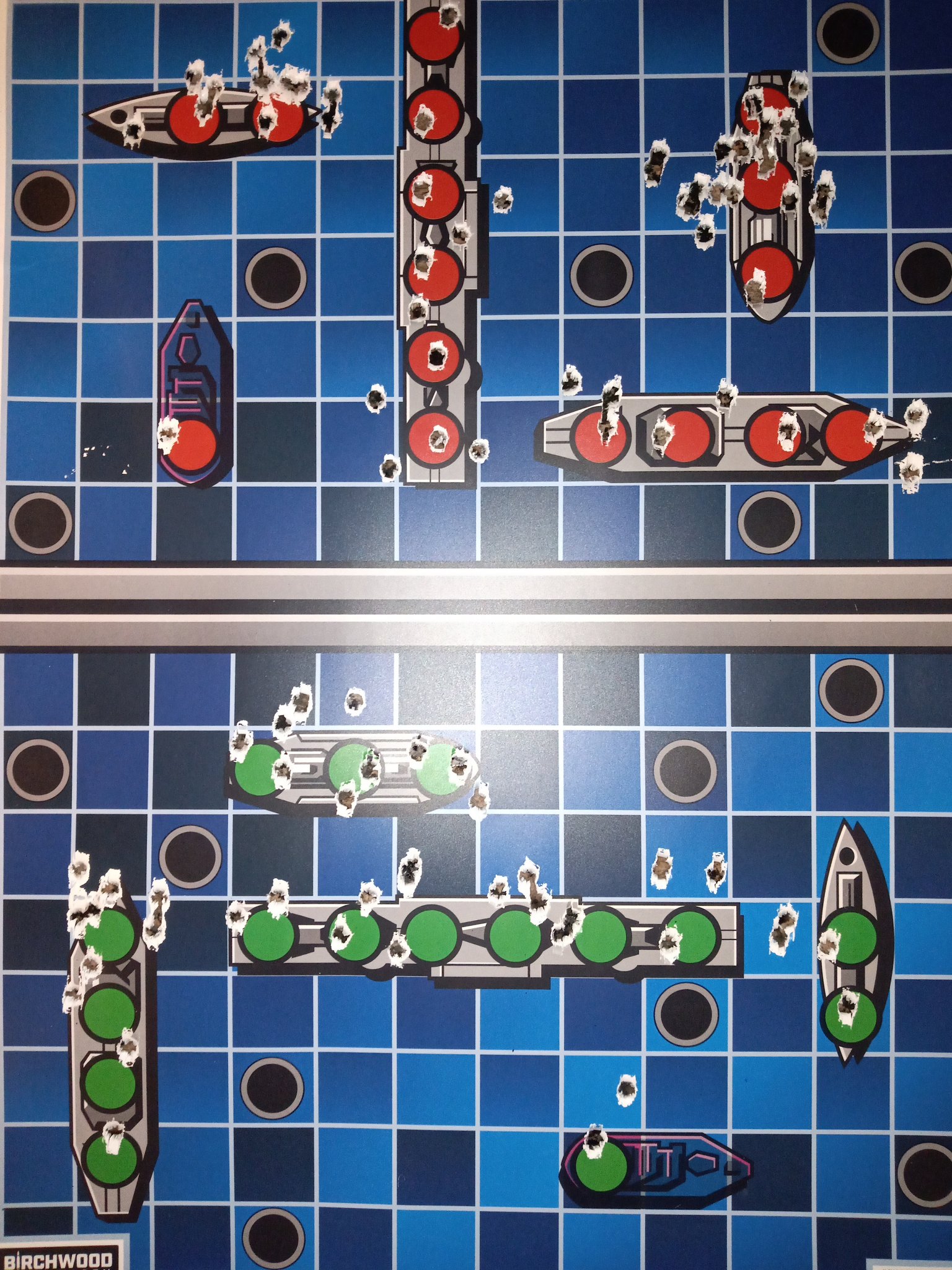

He is doing well though. The week after he shot that silhouette match, we played battleship at 100 yards. He beat me, but I think a little of it is the ammo we were using. That 223 really wasn't liking a bunch of 223 I loaded a couple years ago as an AR plinking round. But I had made a thousand of them and still had about 700 left in an ammo can so why not use them up.

I’m no expert, at least not anymore, but I have no problem with three shot groups. As long as the shooter shoots lots of three shot groups at a time, before coming to a conclusion. Ten three shot groups in a row is as good as three ten shot groups In a row. its the average of 30 shots.
Now, in the last two years I have posted groups of 0.10 or better, twice. With two different rifles no less, two different calibers. Boy they look good on paper. But look at the paper and decide if they have any meaning at all.
Ain’t she pretty? 0.13 center to center, gotta be pure luck. What concerned me was the next set where two good groups were set by a group right at an inch. So, I went back and reshot it again. After 6 groups, the average was just at 1/2 MOA center to center. So, to me, it’s not the number of rounds in a group, it’s the number of rounds. (And more is the better). Note the groups on the left are a different load level than the group on the right, this was just part of an extended test.

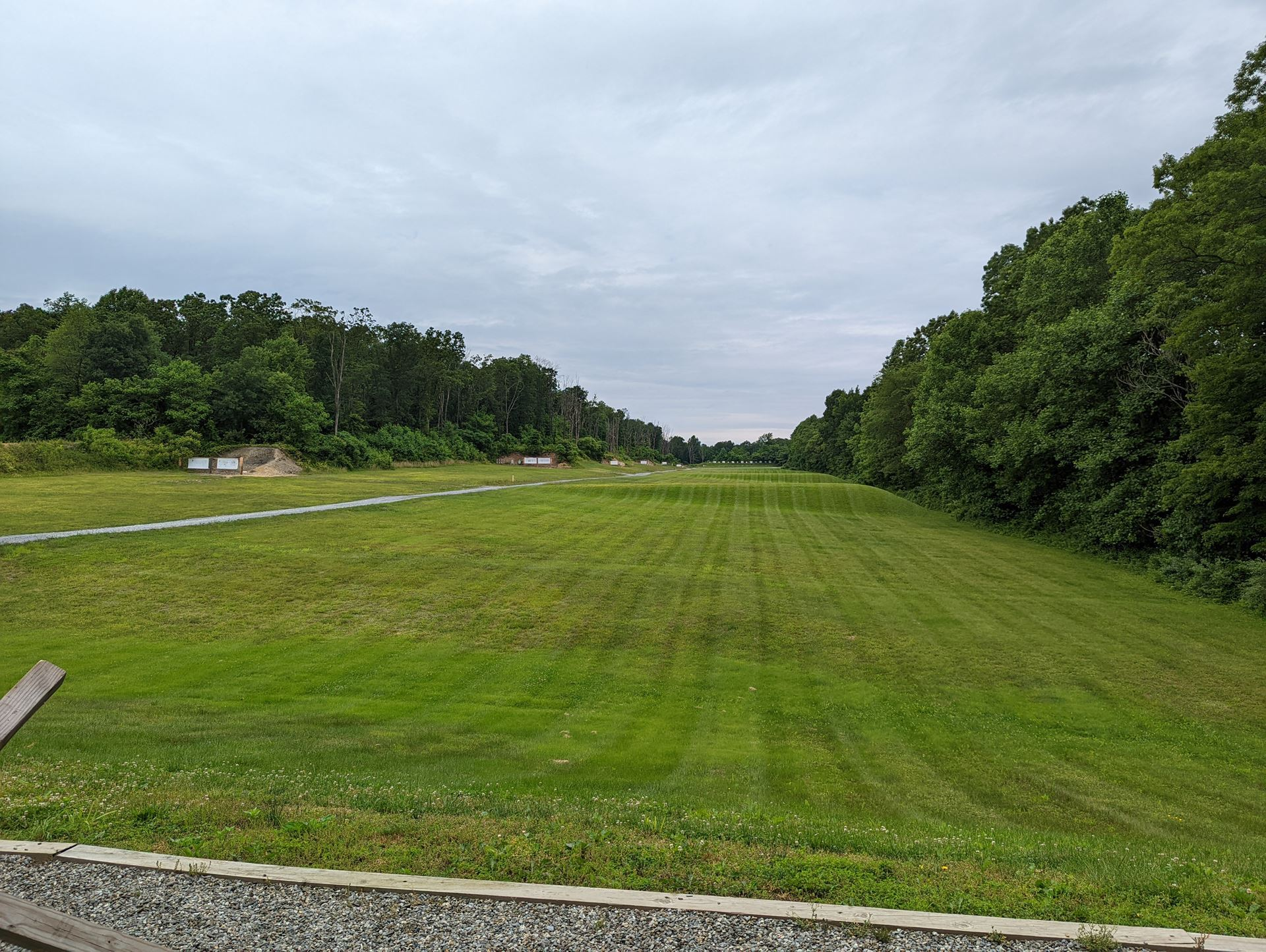

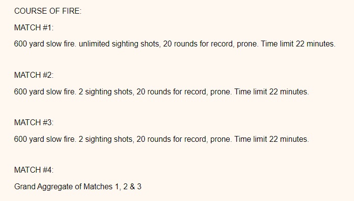

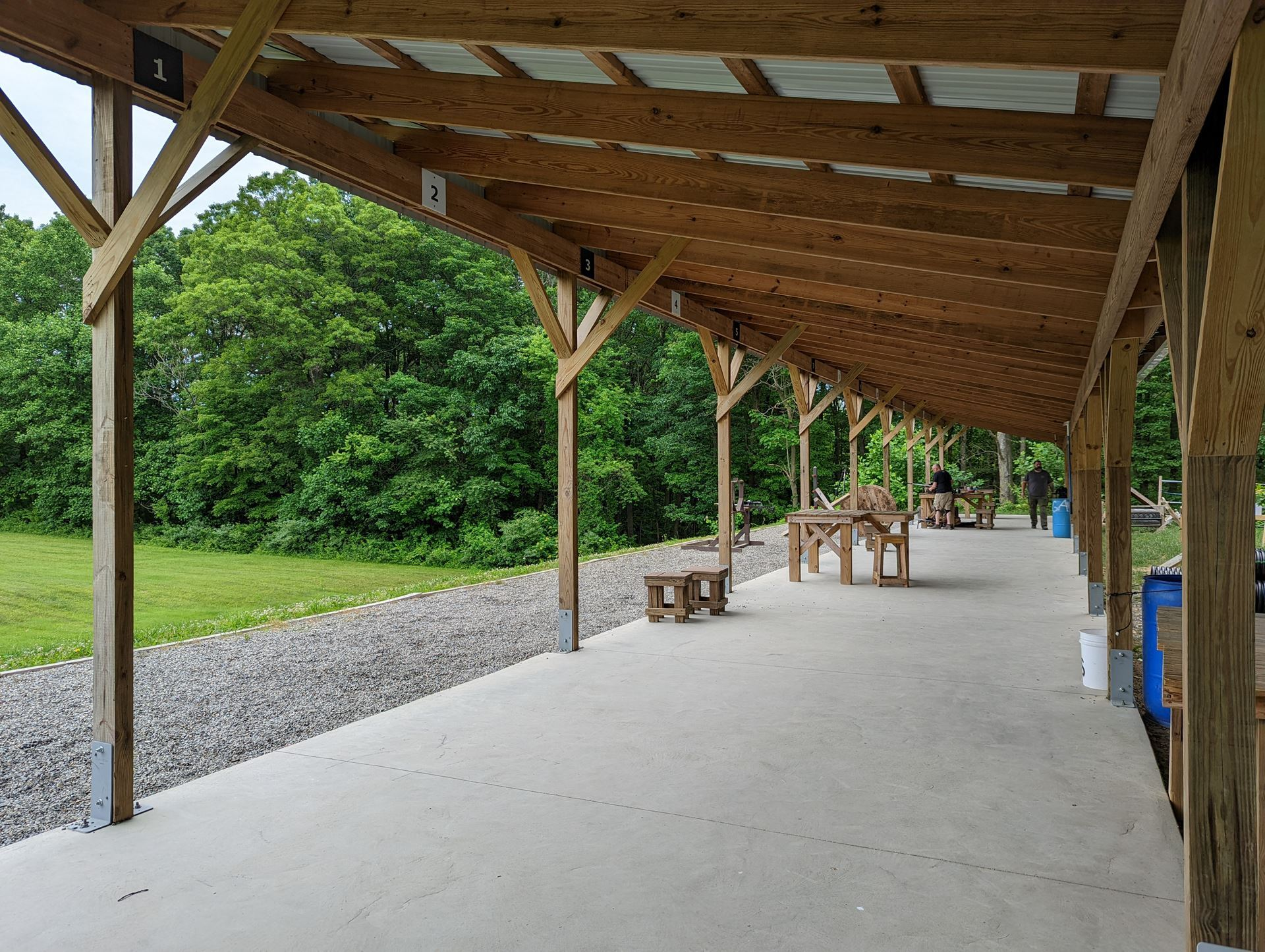

How well does your son handle noise and shoot if others are also shooting? I ask because New Holland's roof can reflect noise (and the others aren't shooting suppressed).
This is New Holland's 600-yard mid-range match format:
Firing line:
View from the firing line to 600 yards:
Reactions: DeathBeforeDismount
Firing line:

6.5 CM load is good enough for now but I think i settled on a load and seat depth for the .223 for my son.
Of course these are just cherry picked groups and don't really count for any kind of data since they are only three shot groups.
I think for now I will stick with group #1 of the seating depth test. Technically it measures about the same as the #3 though.
