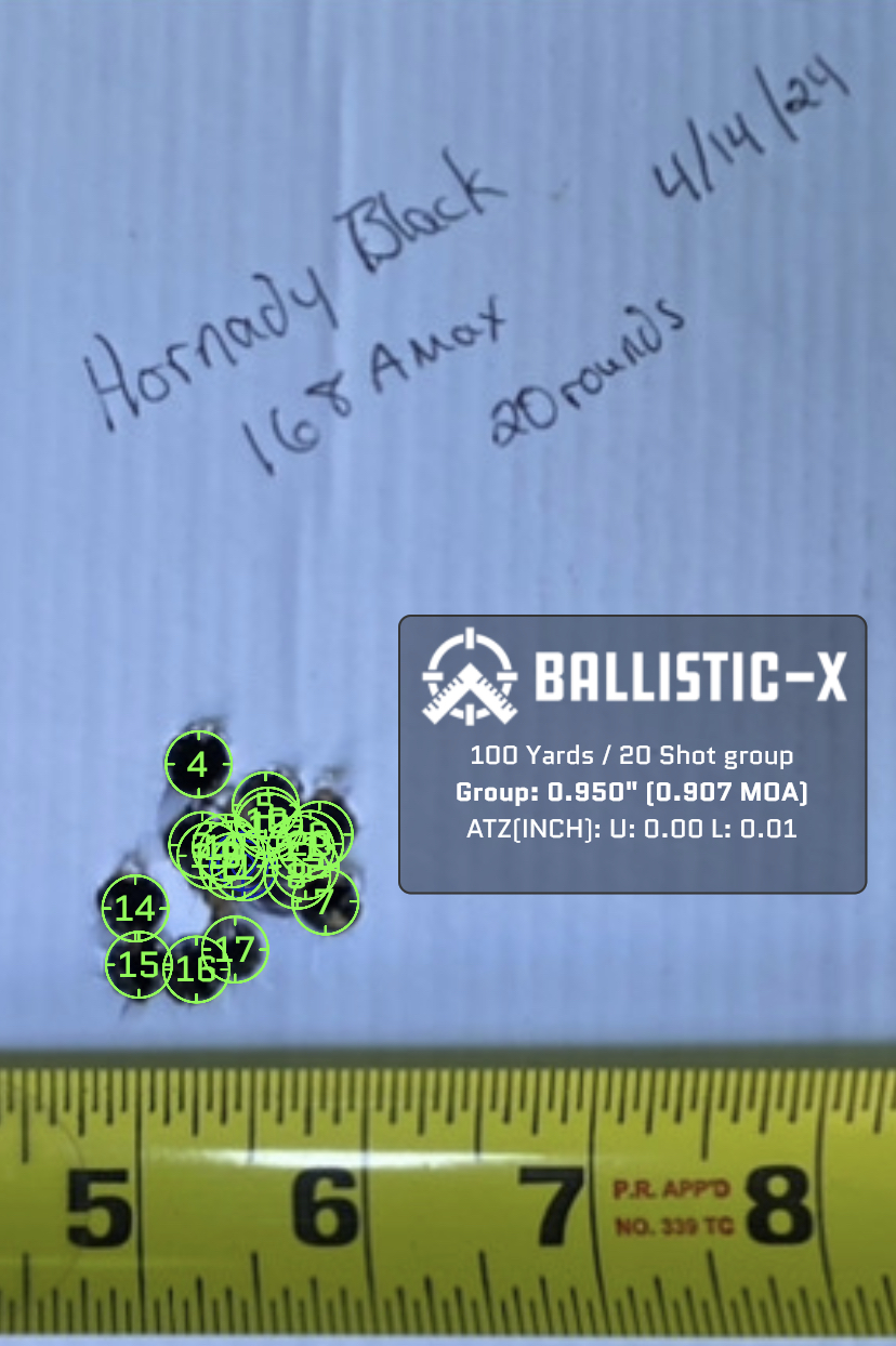

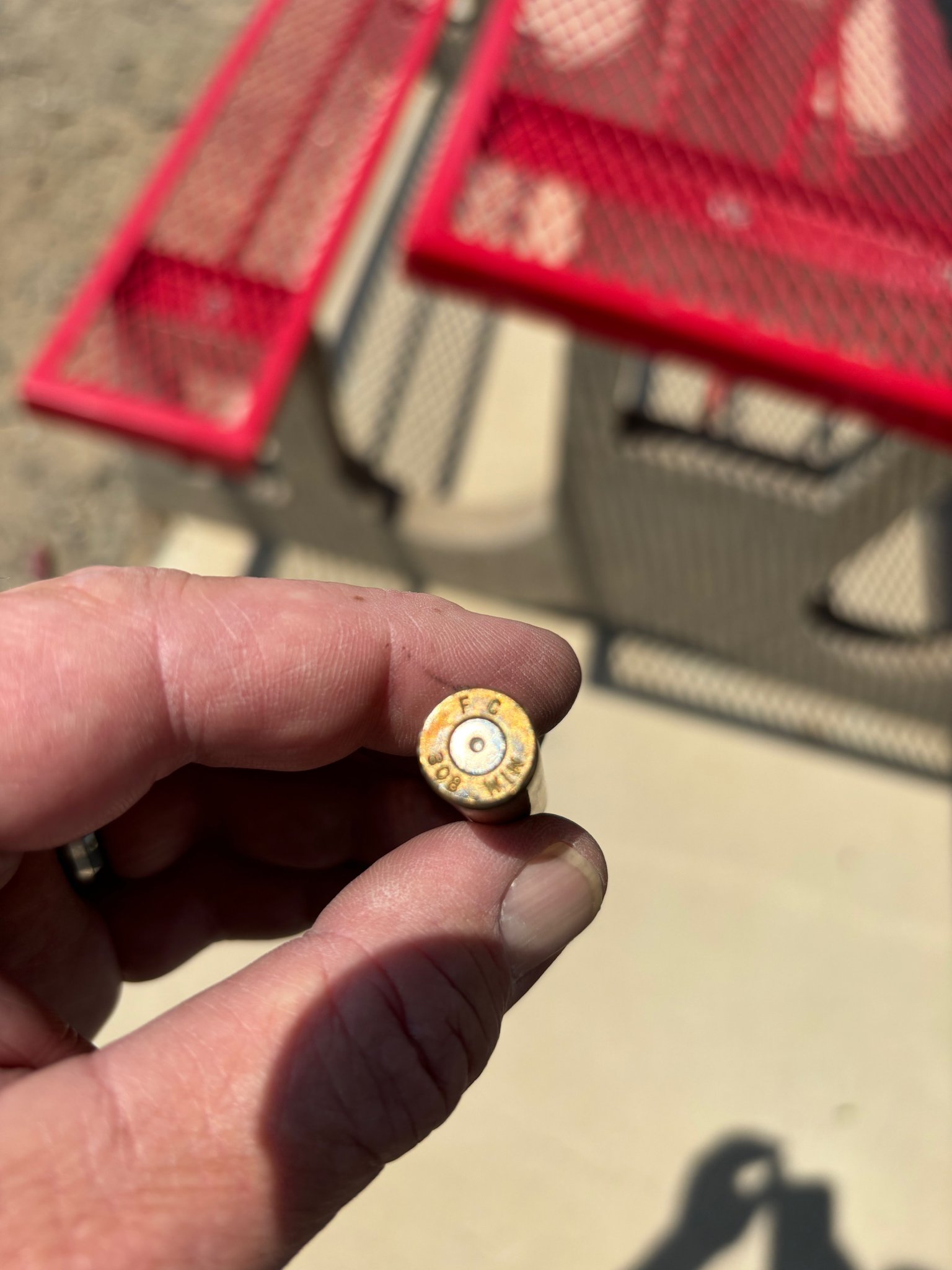

Pics of brass taken today from my MARS-H, 16” SS barrel, SureFire SOCOM suppressor.
100% factory configuration, 100% reliable.
All brass landed 10-15 feet from the gun.
Not overgassed.

Shoot one next to an SR25 and you will learn the difference between a properly gassed rifle and one thats over gassed. Most of the guns you see today have the benefit of KAC R&D in their blood. So much of this platform is derived from things KAC figured out way before anyone else, and incorporated into their platforms. Things like the Ambi lower and the Free float rail system that evolved from the steel and carbon systems of the 80s and 90s.
There are different ways to make a rifle "reliable" in adverse conditions. One is to gas the piss out of it, like most commercial AR guns. KAC was the first that really figured out the gas system and made improvements to it with the SR15 MOD 0, which evolved over time into the mod 1 and mod 2. Same tech was incorporated into their SR25's, which made them very soft shooting. Part of this common overgassing is due to widespead use of weaker than mil spec (M193/M855) loads and the other is due to getting a bunch of random parts to work together when they arent designed/machined/assembled/QC like premium guns were.
