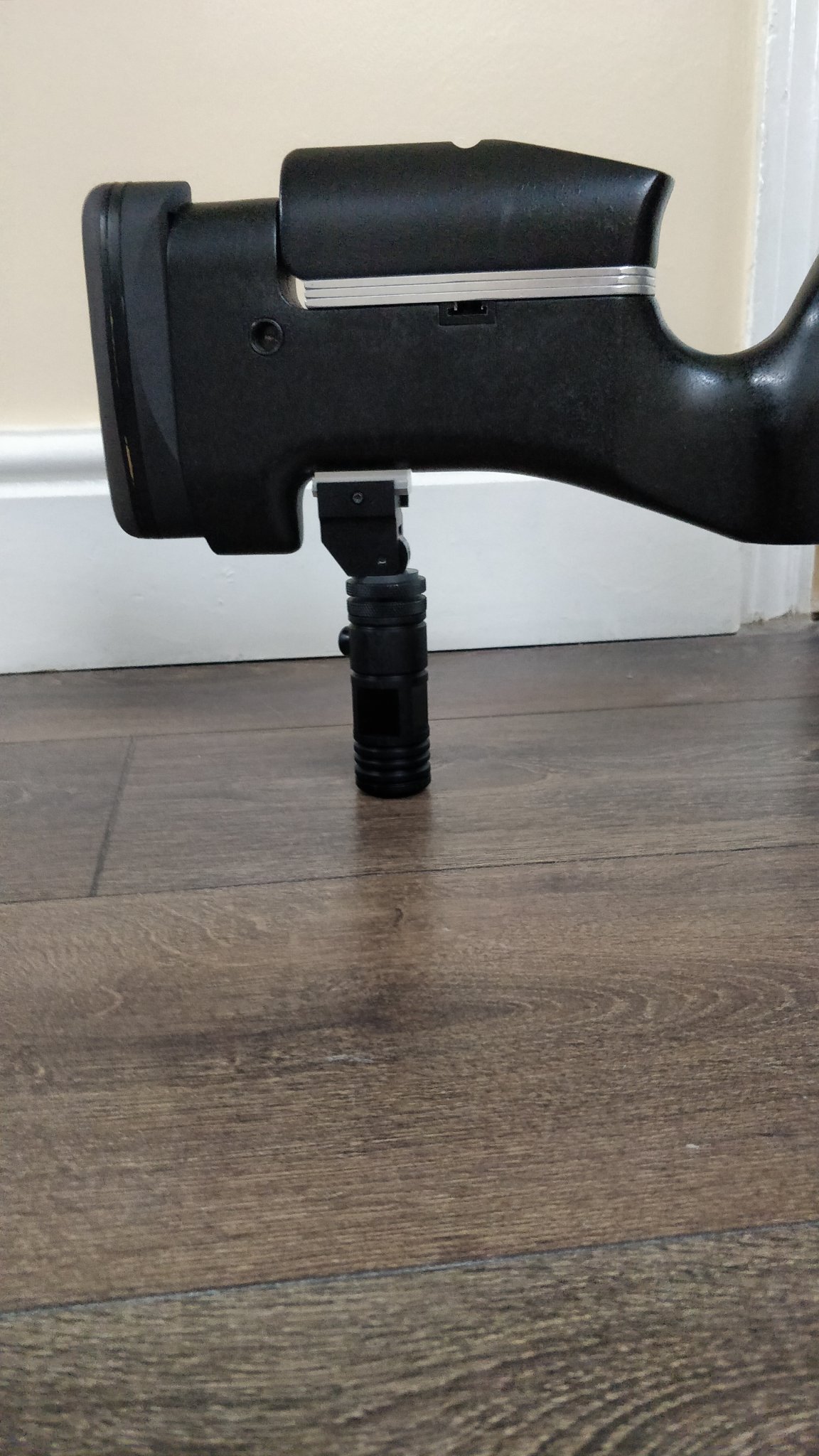

My mate makes them ,he fitted mine and made me a custom rail for it

My mate did a good job for me .He makes the monopod plus makes up the rail
