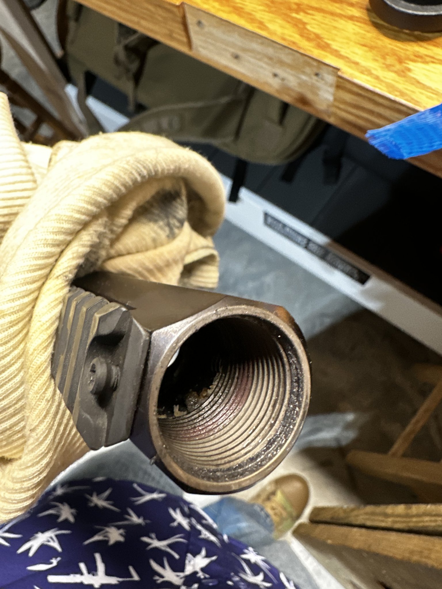

    If you do the swap yourself, be prepared to cuss a lot. Broke a wrench getting the barrel off. I'd estimate it finally gave at close to 400ft/lbs. Had what appears to be red lock tite on it.
